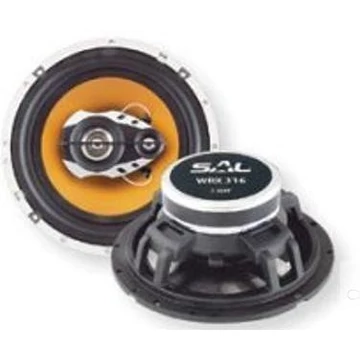

I'm not familiar with SAL audio products, but I see they include car speakers: https://familymarkt.hu/sal#content
For example, the image below shows a SAL "3-way car speaker with a diameter of 165 mm".
Are your similar looking drivers also from SAL, and are they also 165 mm in diameter?
165 mm átmérőjű 3 utas autóhangszór

P.S. Don't be fooled by the 110 W power rating of the WRX 316 drivers I illustrated above.
110 W will be the peak power rating. This is the maximum wattage a speaker can handle in very short, occasional bursts - perhaps only for a millisecond or two.
For PA use it is the continuous power rating that is important. This is the wattage that a speaker can comfortably handle for an extended period of time, like in a Disco. In the case of the above 165 mm driver that might only be 40 to 50 W.

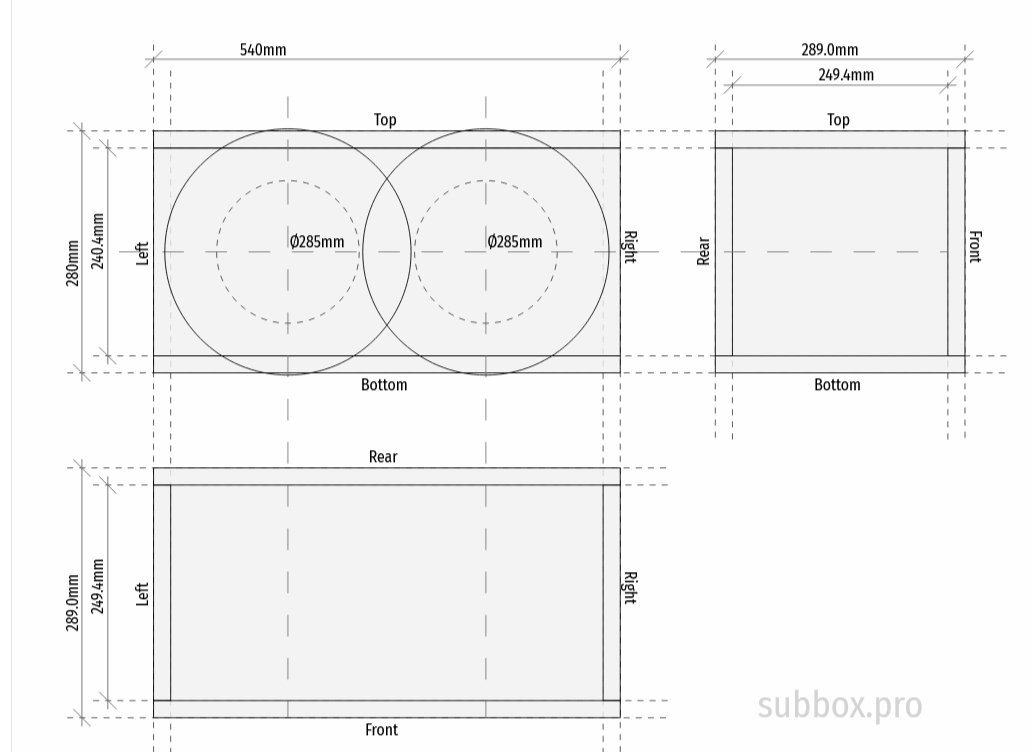

if you want to get most out of your drivers you can try put two per box into this corner coupled horn.
Ideally the drivers should be EQ'ed to be linear and put a filter of 24db below horn loading.
You would get an efficient system irrespective of the drivers. After filtering they could take much more watts. But its a horn especially to be loaded to the corner.

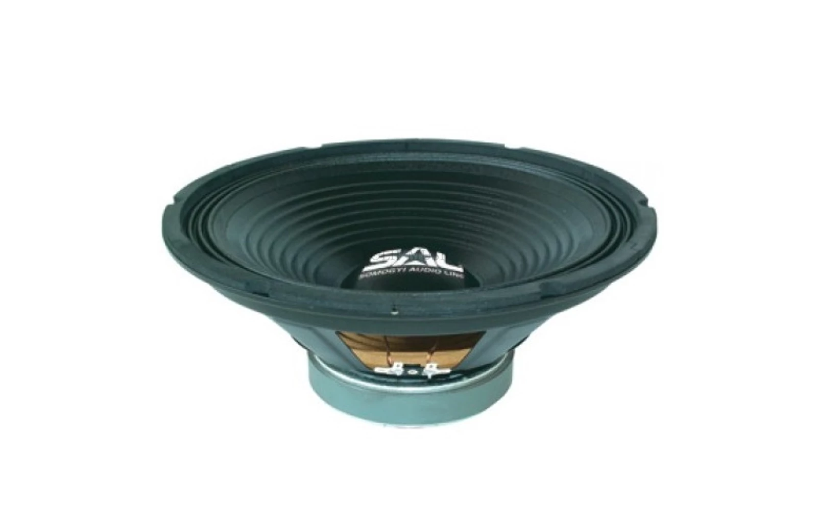

veas thinking about spa series of those speakers. Like sal spa 4050
Please supply links so we don't have to do the searching: https://www.polipmusic.hu/sal-spa-4050-8ohm-40cm-230160w-melysugarzo
Translation:
"The SPA 4050 subwoofer is excellently suited for both music listening and amplification purposes.
The device, equipped with an impregnated paper cone, has a musical power of 230/160 W, with a frequency response range of 30 – 3,000 Hz, while its sensitivity is 93 dB.
The voice coil, made of aluminium, provides adequate cooling. The weight of the magnet is 50 Oz. The diameter of the subwoofer is 400 mm."
This subwoofer will have a 15" cone.
P.S. No Thiele-Small (T/S) parameters are given for this 15" subwoofer so I wouldn't know what design of enclosure would suit it.
Look for PA drivers whose T/S parameters are given.
I know now when i think why is this bad idea but yea my model is like 75w max so 50w-60w continues maybe i need to test that.P.S. Don't be fooled by the 110 W power rating of the WRX 316 drivers I illustrated above.
you can build the horn with a lightweight material.
Instead of DSP simply bass adjusting at the preamp will do and filtering the horn with 6db electrolytic like 600 to 800uF already helps reducing excursion for the frequencies below the horn loading.
30 W continuous would be more like the figure.
