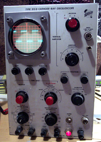

Note the discoloration on the ceramic
I note this on the 3XX series scope.
this can (must) be cleaned -- and if you don't clean it it will arc over -- I had this problem with my TEK 545 -- DO NOT CLEAN WITH AN ABRASIVE CLEANER. this will scratch the ceramic surface. I think that I used MEK to clean it up (it was about 20 years ago), but check on the TEK group or at the newsgroup rec.radio.amateur.homebrew for suggestions.

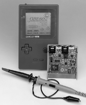

There was interesting project in Elector 2000 /10,11 about converting Game Boy to 2 ch DSO with realtime FFT.
I can publish this somewhere if anybody interested.

The 315 has been completely cleaned up. I also rebuilt the high voltage section after that picture was taken. All new caps...high voltage and others. There was a bit of dust/dirt on the ceramic strips in the high voltage section, but there was far more attracted dust around the focus and intensity controls.
The best way to clean these old tek scopes is to put then in your bath tub and use a hand held shower nozzel and soft toothbrush to get rid of the dirt. Dry it out in your oven at 100 degrees for 8 or 10 hours. Then apply Caig De-Oxide to all the switches and contacts, as well as the pots if needed...but most of those are sealed anyway. The scopes end up looking like new. I was taught this by a friend that worked at Sta-Bro Calibration facilities here in Salt Lake City. They have cleaned hundreds of scopes that way to ready them for calibration. I was also told that Tektronix used to dunk the entire instrument in a giant ultrasonic cleaner filled with distilled water.....a bit fancier but basically ending up with the same results.

For general purpose audio work one of those old tube Tektronix's is hard to beat!! You guys ought to be able to recognize a piece of great equipment when you see it....hopefully. There is a classic TEK tube scope that doesn't require your Uncles garage to store.....read on.
Aside from my TEK 7704A, 7623, 456B, and many pieces of TM500 gear, the scope I use the most for audio work is a restored 1951 Tektronix 315D!! Its single trace, 5mhz, 41 vacuum tubes, turbo fan, and wonderful triggering abilities all add up to a classic piece of test gear well worth saving from the dump. This was Tektronix's second product!
Interestingly when I restored it there were no bad tubes, just replacing the bypass caps, reforming the main electrolytics, and cleaning and alignment brought it back to spec again. Even the main power supply electrolytics are still good in this scope, and they are 52 years old! I'd like to see a transistorized unit, even a TEK, beat those odds. On the 2225....be careful as most of the hybrid circuits are long obsolete and N.L.A.......You will have to scrap out another scope to keep that one going. Go to Yahoo and sign up for the TEKSCOPES forum and learn more about all the Tektronix test gear. There are many retired Tektronix Field Service Techs that frequent the site and can give you valualble help in choosing a good scope.
