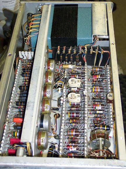

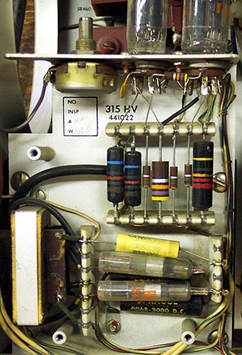

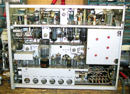

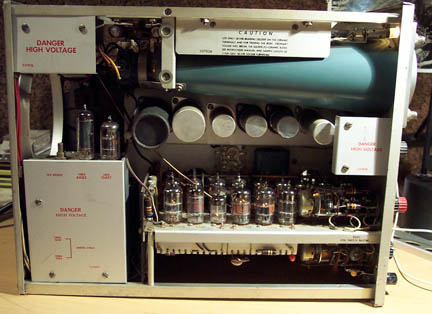

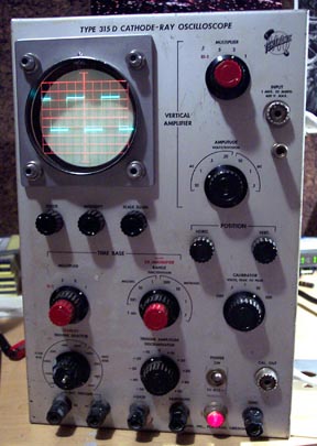

I too usually just buy second hand Tektronix scopes. I've amassed quite a collection for not alot of $$. Have a 465B, 7104A, 7633 Storage , SC504, and SC501, and my latest restoration project is a 315D vacuum tube scope. This was Tektronix's second manufactured product. Its only got 5mhz bandwidth and single trace, but is built like a tank and built beautifully to say the least. It has 41 tubes including the CRT!! Rectification is by 6 selenmuim rectifiers.
So far I have cleaned it up and have replaced all the bypass caps and it now works......still have the power supply caps to replace and then calibration....but considering its circa 1952 its pretty amazing it still works at all. This scope will operate on 120-240 volts 60 to 800hz and has an internal fan as loud as a 747!
