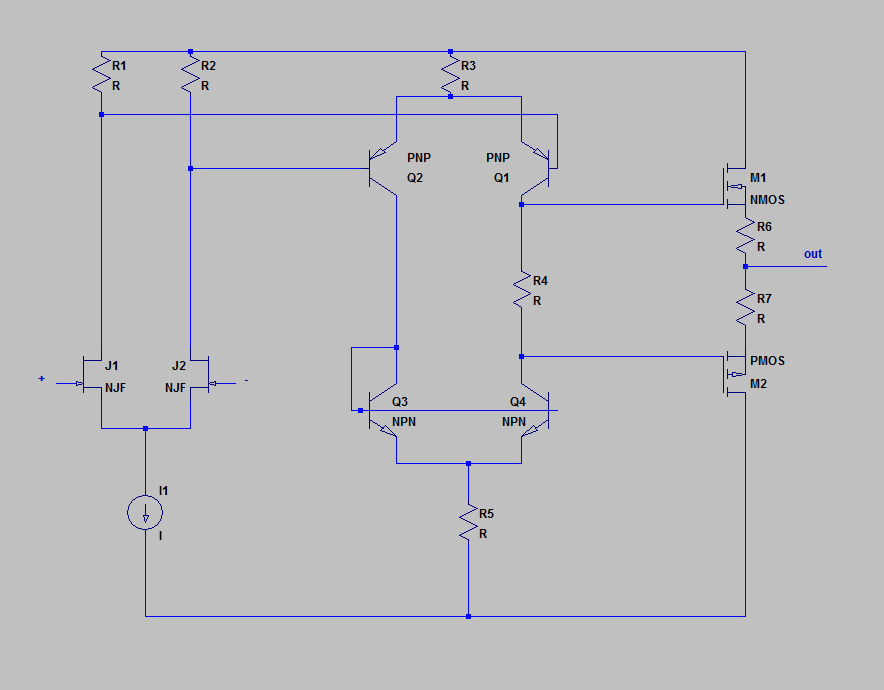

would you kindly advise me on the dmc-5 preamp? I bought one recently on ebay as a non-working unit. When I checked it, it is oscillating crazy at 21.1KHz square wave 35 volts peak-to-peak. I believe this oscillation occurs in right channel line stages.

I don't have a schematic but could recreate the basic circuit. Major oscillation at such a low frequency is quite unusual. First check the basics like the power supplies. Should be +/- 24V on each channel. Then look for issues in the feedback circuit like an open connection.
The sketch below is the basic form used in all the Spectral preamps and amps. I believe a variation is still used. Enhancements and details will be different from unit to unit. You can usually look at the circuit and see it follows the schematic.
Weren't there two of one of the output devices?
I think that was to make the gate capacitances look equal?
