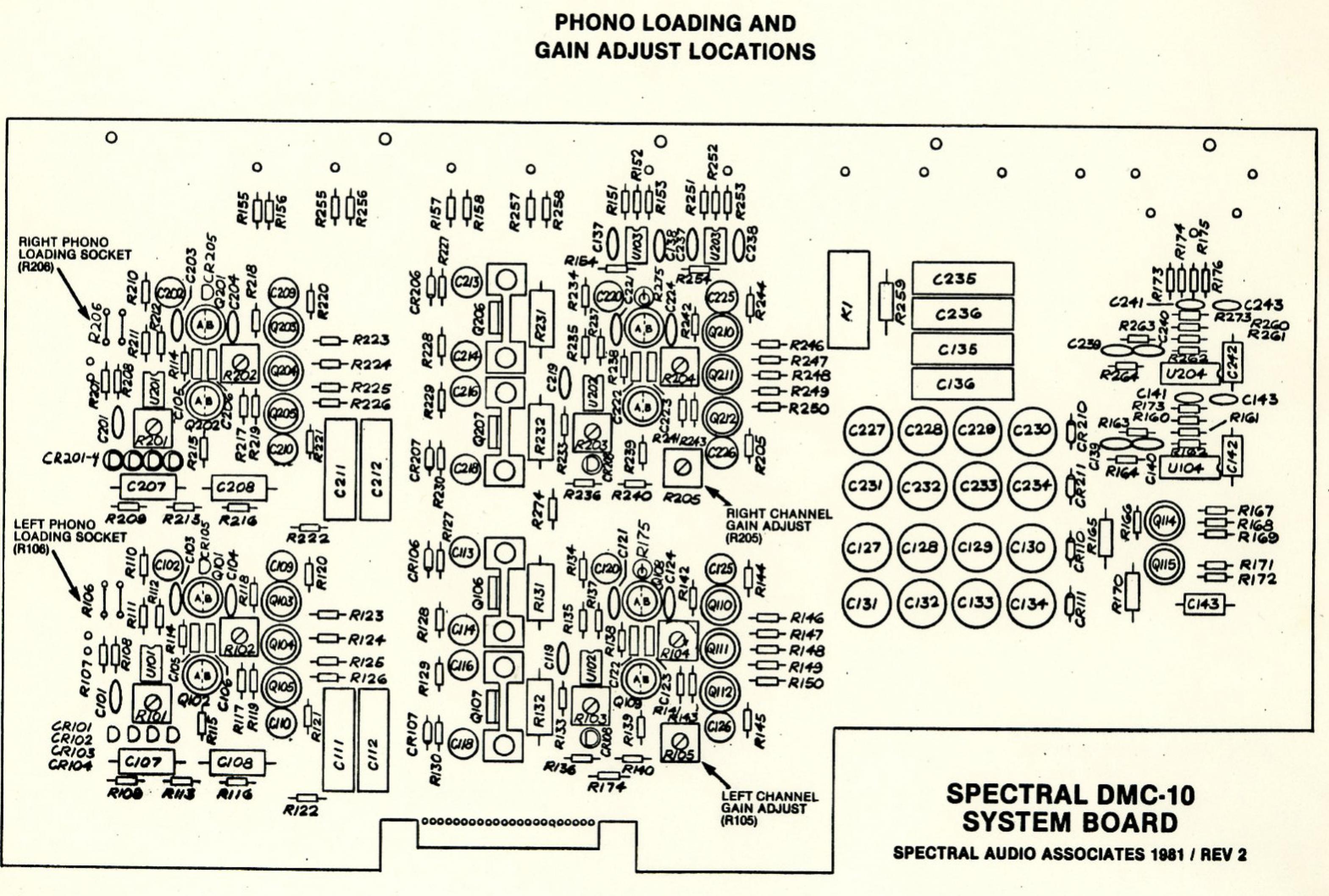

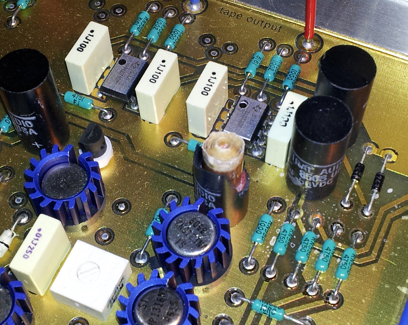

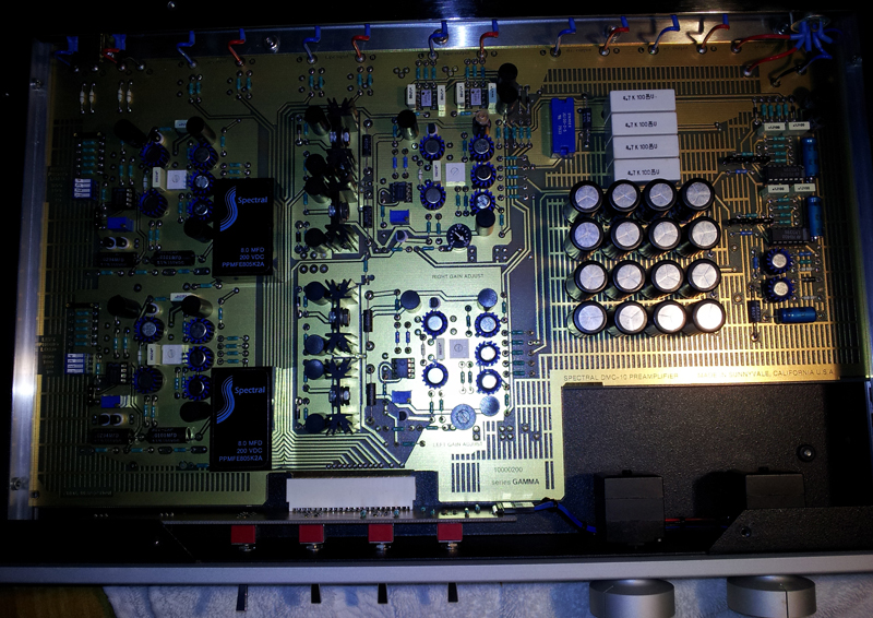

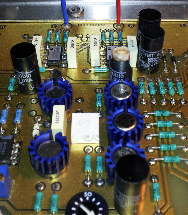

I have a DMC-10 Gamma that has some swollen caps and one that has the top broken off. I would like to replace them all if possible but it looks as though it will be difficult to remove the circuit board. The caps all appear to be 35uf 50VDC. The preamp works but the power LED is dim and it doesn't seem to sound as good as it did years ago(it has been in storage) Any suggestions?
The whole circuit board comes out pretty easily. On the rear there are two allen head screws near the bottom. Remove the top and those two screws. Then the board slides out the back.
Replacing all the electrolytics at its vintage is a good idea. Use good 50V caps. The largest value that will fit in the space. You will need a big iron. The ground plane is very heavy.
Demian, The caps are 35uf 50VDC. Shouldn't I use the same value with a higher voltage rating? And are they in the signal path? Should they be audiophile grade or are they power supply caps? Should I use something besides electrolytics?
That's the component placement drawing, not the schematic. There is a simplified schematic in the early version of the manual.
The caps are all in power supply locations. The caps were the largest low esr caps available in the late 1970's. This would be a good choice: EEU-FM1H181L Panasonic Electronic Components | P12396-ND | DigiKey Do confirm the fit and the lead spacing. Its similar to what I have used in previous upgrades. The big cap bank is really hard to remove so don't unless you see evidence that you need to.
