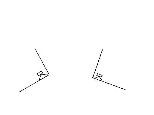

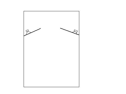

A narrow baffle with wings works well. Haven't tried the slopping roof, though--just a little awning above the driver. Presently, I've the Fostex 8 inch F200A on a 14 inch wide baffle, 30 inches tall, and wings about 12 and 10 inches deep. Good bass.

eg Having a 10" front, one 7" wing and one 8" wing swept back at about 60 degrees results in an effective baffle width for bass purposes equal to about a 38" wide flat baffle. In a 12" wide by 8" deep footprint you are talking about small box speaker size, so which is going to have better WAF?
While there is a slight change away from a pure dipole radiation pattern, I believe it is sonically superior because you do away with a large reflective front and a large blockage of rear wave reflections. This allows much more freedom in placement without losing the open natural sound of OB. In addition it gives you structural support and a place to hide exposed drivers, XO's, etc. With a grill cloth across the back it will look like a box speaker with an interesting shape.

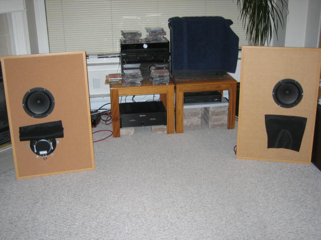

Well, I decided to take my "experiment" to the next level (thanks to Ed "adason")
I ordered another pair of B200's and mounted them in the corkys below the original B200s. I mounted them in reverse as per Ed's Lowther setup - in effect a mechanical XO with the magnet cutting off the HF. I still thought I could hear some comb-filtering so I attached a piece of felt cloth over to cover most of the bottom B200's. This really made things come together!
All I have to say is WOW! The added LF response sure completed the picture. This may be just the right amount of bass for our apartment setup. The mids and highs are better balanced now. I can honestly say these are one of, if not the best sounding speakers (LF limited) I have heard anywhere, at any price. Not too shabby for under 700 clams.
The additional dipole bass is truly something to behold and must be experienced. I can see what all the buzz is about now.
I made the mistake of wiring the drivers in series (out of phase) to start with. There were some distortion artifacts. Parallel definitely was the way to go. Such clean sound and I still have lots of volume to play with on the preamp. For 96db speakers, the B200's will eat quite a bit of juice.
The corkboards are probably the weakpoint (flex?) now and some more solid baffles are in the works. Also, I had to pull the speakers another 2 feet away from the back wall as the bass was gettting a touch boomy in the original position.
The picture below shows the felt cloth lifted over the left speaker so you can see the bottom driver.
Thanks again everyone. These drivers are a-mazing.
