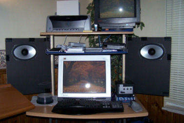

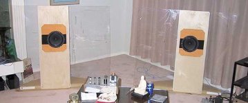

What are those anyway Dave, around 12' wide or so would be my guess? 😀 Bet the wife'd love those in the lounge. 😀
Scott
Scott
There's no room for Ruth in Dave's lounge. She has her own areas and one of them is under the same poly, behind the right speaker. 😉
Scottmoose said:around 12' wide or so would be my guess?
The posts holding the deck up are 12' apart so the baffle would be closer to 16' wide and 1.2 m tall IIRC.

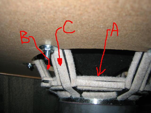

I decided to try damping the speaker frame (as suggested by Omega) so back down to Wal-Mart I went. Came home with several packages of "Feltac" polyester furniture protector strips (1"W x .5"H x 58"L).
A few hours and a whole bunch of trimming and cutting later, I ended up with what you see in the attached picture. Definitely made a difference in balancing out the sound more to my liking. The key part of the damping (IMHO) is shown as "A" in the picture. There's about a 3/8" metal groove between the speaker frame and spider that just can't be doing anything good for the sound. "B" and "C" are probably key as well. I wish I had an RTA!!!!

Now if only those drivers were waterproof, Dave wouldn't have to worry about fitting them in the living room.
We first listened to them at my place many months earlier, and with a diagonal room placement, there wasn't enough space between the panels for me to scoot behind. (Dave - you still have those photo's?)
Tom: there's a quality to the bass response on an open baffle that's hard to describe, but the smile is easy to detect. Even the FR125/WR125's are amazing in this configuration - although sensitivity and Xmax limitations could be a problem.

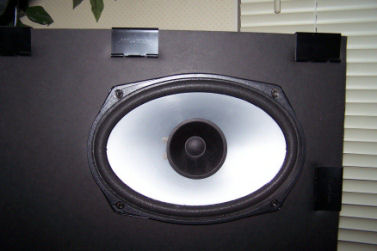

Kensai said:This is a close up of the driver. You can almost make out the OfficeMax logo on that center binder clip at the top.
Are the cones aluminum or just painted... You'd get better horizonal disepersion and a wider sweet spot with more extended top if you rotated them 90 degrees.
Look like a good candidate for phase plugs 🙂
dave
I'm actually using one wire from each pair for + and the other wire from each pair for -. Sounds just the same as using the 10' lengths of standard 10ga speaker wire that I run in the living room.
They call the cone material "pearl mica P.P." so I'm not exactly sure what its made from. It feels somewhere between a treated paper and propylene.
I had thought that they might do better mounted vertically. I've actually had the fresh pieces foam core to make baffles for that set up for several months now. Just haven't come across the proper time/motivation quotient needed to get me to do the work yet.
I'm interested in trying to mod these with phase plugs. The whizzer is paper, and the dome in its center is about 3/4".
