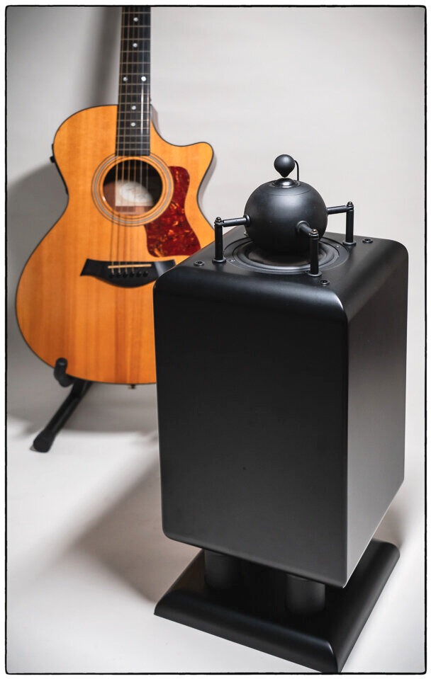

Sure? Speaker are about reproduction... I'm not convincing at alla that a speaker should "work" like a music instrument. So many different instruments with their individual way of emitting sound in different directions. A speaker model for solo violin, an other for solo congas? Hm...Surely this is further mimicking what happens with a live instrument, and therefore beneficial to the impression of realism...

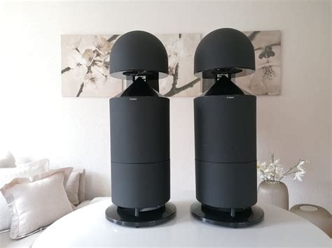

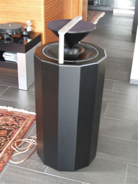

if its so difficult to combine good time response and omnipolar response still the classic configuration can be a problem solver:
like this one but with a dsp'ed fullrange like Fane Sovereign 12-250tc.
but a concentric design would do, too.
last one from canon s70 has the advantage of not collecting dust over time
Of course, however a conventional forward-firing loudspeaker will have a polar distribution quite unlike most acoustic instruments. I'm quite open to the possibility that the ideas cited above have real merit, but of course any omnidirectional speaker is only omnidirectional to a single listener if it has something to reflect off, and that's where its effect - for good or bad - gets difficult!I'm not convinced at all that a speaker should "work" like a music instrument. So many different instruments with their individual way of emitting sound in different directions.

A speakers radiation must have something to do with how microphones "listen"... I suppose there must be some symmetry in the rec/repl chain in order to make a faithful reproduction. Multi mic/ studio/electrical instruments can only hope to be "nicely" played.

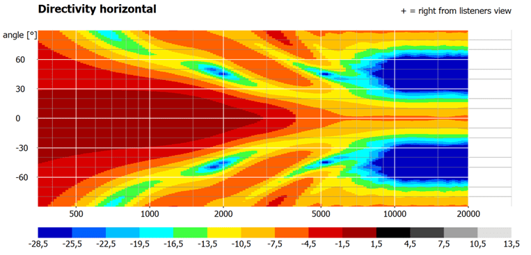

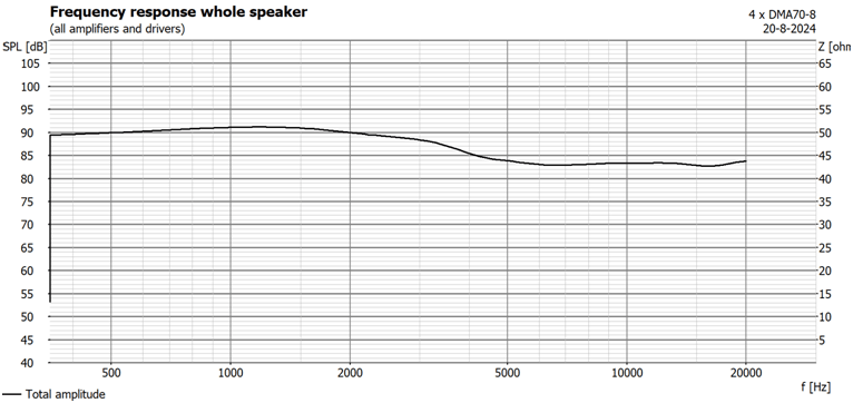

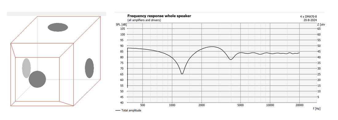

Thanks for the hint. Although a cube is quite different from a truncated octahedron, I made an attempt to simulate the behavior of the omni with Boxsim.As Visaton boxsim software can model a cube with a driver on each face I did that
For the simulation I placed the four drivers on a cube (riblength 20 cm) as below, resulting in the frequency response as shown.
The agreement between the simulation result and the REW measurement is clear (see post 33 of this tread).
Also the directivity plot of the simulation is not in disagreement with my REW measurements.

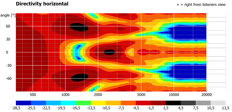

Next I gave the direct driver the amount of delay necessary to virtually place it in the plane of the indirect drivers. This plane is perpendicular on the listeners axis (see post 19 of this thread), The applied delay was 350 usec.
It is clear that the nasty dip at 1300 Hz on the listening axis has disappeared, as expected.
The above exercises have given me confidence that Boxim can be a useful tool in the further development of the omni.
