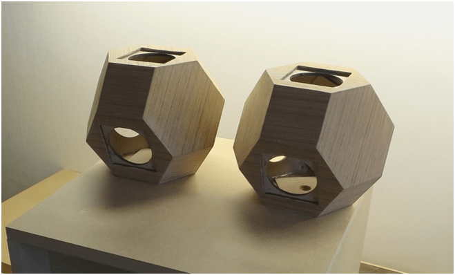

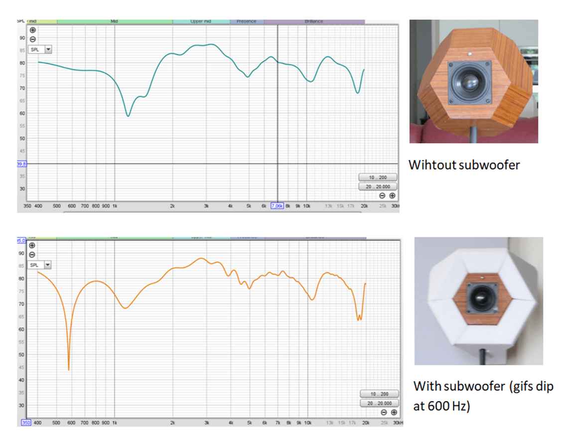

I often heard experienced listeners say about omni-directional speakers that the sound was sparkling but that the stereo image seemed a bit woolly.
Some time ago I argued in this topic that diffraction results in a poor spl, leading to a less optimal stereo reproduction for my omni’s.
I now think that it should be possible to greatly reduce the diffraction effects by placing damping material on the outside of the omni’s. By sheer luck, this is possible with the shape I chose for my omni’s.

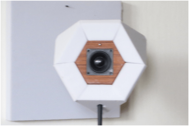

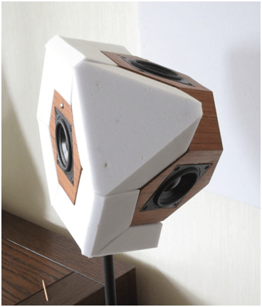

The omni’s have the shape of a truncated octahedron, consisting of eight hexagons and six squares. The drivers are mounted in four of the hexagons.
Due to this arrangement, there is an empty plane (hexahedron or square) between all the drivers. Damping material can now be placed on these empty surfaces to reduce diffraction.
I took a sheet of melamine foam (4 cm thick) and made the slices from it. This turned out to be quite difficult due to the strange angles and double and triple miter. However, in the end I managed more or less to do so.
Halfway through I realized that only the areas visible from the sweet spot had to be covered. Both speakers were treated in this way.
I didn't bother to take SPL measurements, I was only concerned with the stereo behavior. Because I know of no objective method to measure stereo quality, I just started listening to music.
The result exceeded my expectations. The improvement was immense. The stereo image was sparkling and very detailed. Better than I'd ever heard.
To be honest, I would like to emphasize that I am not an expert in qualitative assessment of loudspeaker systems, nor an experienced stereo listener, but I liked what I heart.
In short, I am now very happy with my omni directional speakers.
My only remaining concern are the WAF aspects.

I took a REW measurement with the foam-covered omni.
A measurement of the omni without foam is also shown for comparison.
Although there was a clear difference in stereo separation, the improvement in SPL is noticeable but not very spectacular.
I suspect that thicker foam will work better but this is not possible without limiting the field of view of the drivers.
Also given the problematic practical implementation, I see foam covering as a dead end for this moment.

A couple thoughts:
1) is your gating/windowing short enough to remove room effects?
2) have you tried measuring the front driver alone, then adding the other drivers one at a time to compare frequency response flatness? I'm not sure what's inherent to the enclosure/baffle shape, what's inherent to the driver, what is because of multiple spaced drivers, etc.
ad 1) I hope so. Mic distance was 1 meter, window was 2.5 msec
ad 2) I think these kind of measurements are only useful if the results can be
compared with a theoretical model. Unfortunately, the maths of diffraction
effects are way over my head.

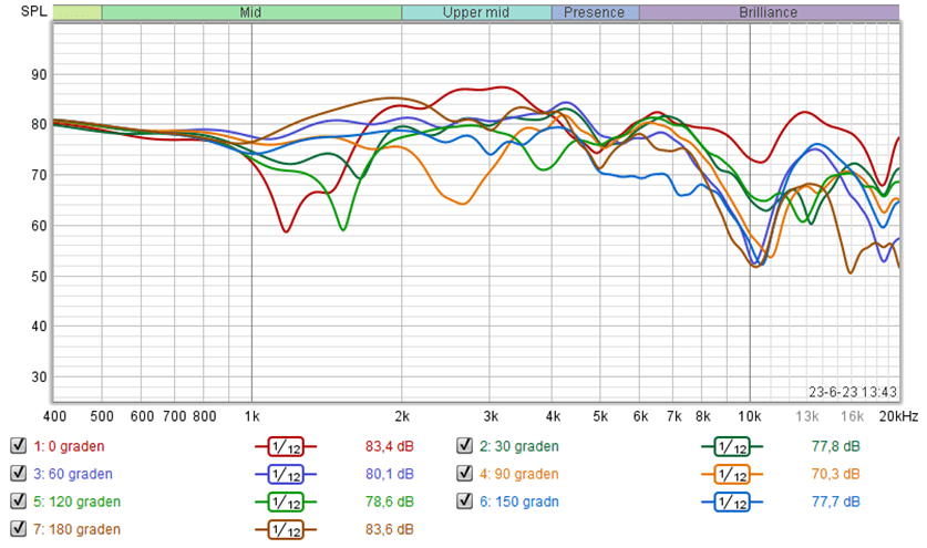

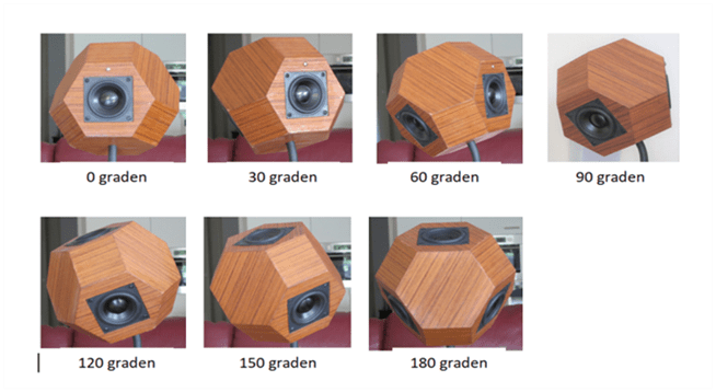

Herewith some measurements I did on the omni's last year. Obviously without the foam slices.
The omn's were rotated in the horizontal plane at 30 degree intervals. Because the omni's are left-right symmetrical, a coverage of 180 degrees was sufficient. The pictures, taken from the microphone position, shows the position of the omni at the respective measurements
Clearly, the combination of diffraction and interference make a mess of the speakers' transfer functions.
Apparently our hearing in general can handle this just fine because it is evolutionarily trained.
However, this practicedness does not apply to stereo hearing; we have known the phenomenon of stereo for less than a hundred years. And there I think lies the problem of omni based on platonic bodies.
