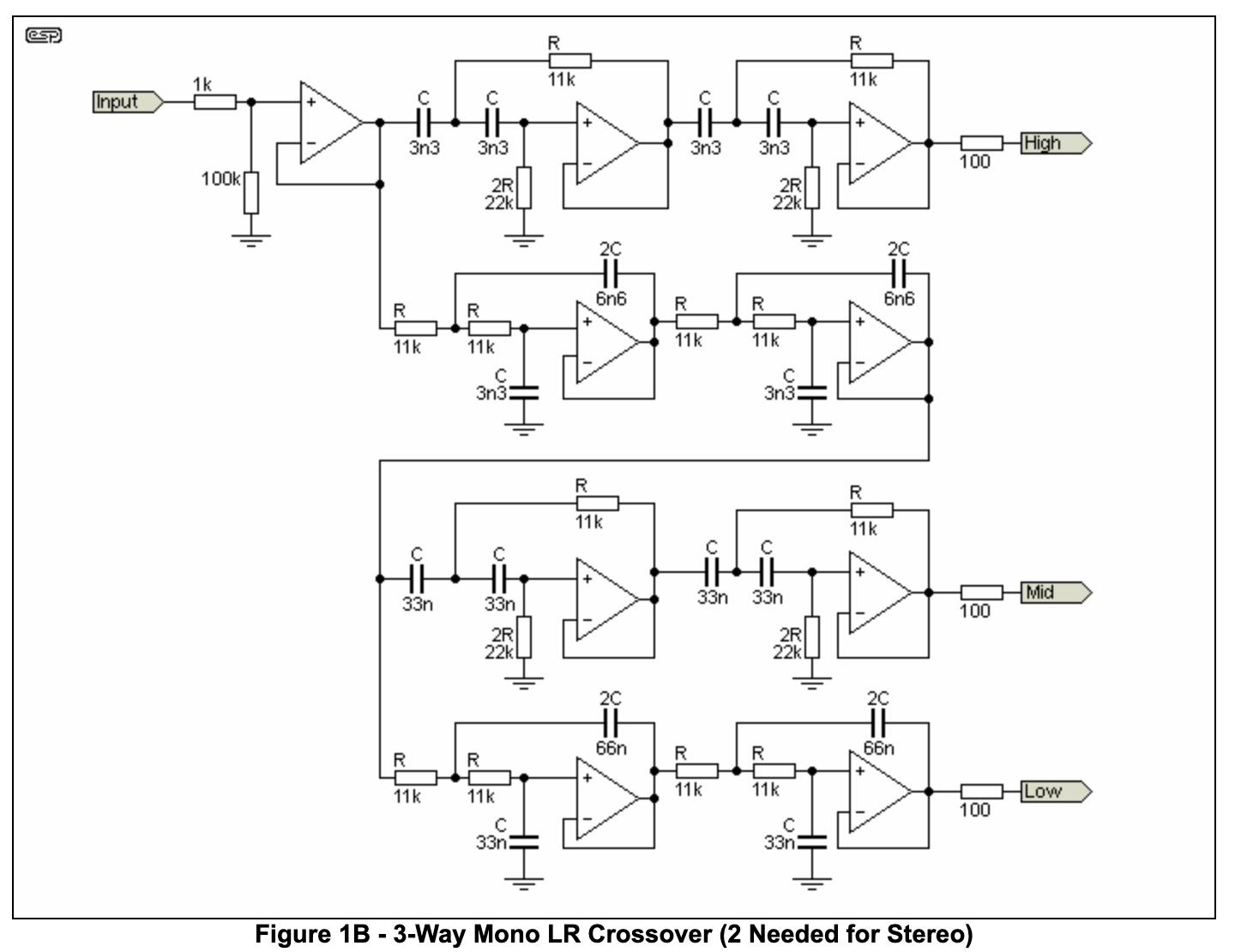

DIY newbie: variable 3-way 12 or 24dB LR crossover build
Dear Audiogods,
after some reading I have decided to embark on my first active 3-way xover build and I'll be etching my own pcb's.
I dug into a few of Rod Elliott's projects and bought a bunch of NE5532 Op-Amps and a 15-0-15v transformer. The rest still has to be decided but it will be used for both hifi and small PA systems. Initially unbalanced inputs, then if it works and it makes sense I might consider improving.
I like the fact that a 24dB LR is in phase but I would like to have some flexibility regarding xover point. I read this is difficult as many R's would need to change.
If I decide that a variable xover is what I care most about I'd need to chose a 12dB filter that is easier to implement, the down side is phase shift.
1) CHOSING A SLOPE
Case A, Rod Elliott's 24dB LR: the only easy way of having "variable" a 24dB network I can think of is building multiple separate circuits with a fixed frequency, and have a switch to change between them (although not practical as I'd need X amount of opamps, R and C's for every passband. It would work but seems like a stupid and wasteful solution)
Case B, Rod Elliott's variable 12dB: Variable 12dB means it has one output that is 180° out of phase so it needs to be inverted. How does this work in the case of a 3 way filter to be in phase? Would it need to have Mid switched 180° compared to the Low, and then the High switched 180° compared to the mid Which ultimately has low and high in phase with each other? Or did I miss something?
In his project 148 he mentions a bandpass which is 90° out of phase with 6db rolloff which isn't very usable, does this refer to the midrange output I'm hoping to obtain? Or is it something different?
Ths article from linkwitzlab suggests NOT to use 12dB slopes at all though so I'm stuck and confused.
Any expert advice on how to get a 3 way crossover whith phase coherent outputs(regardless of the slopes used)?

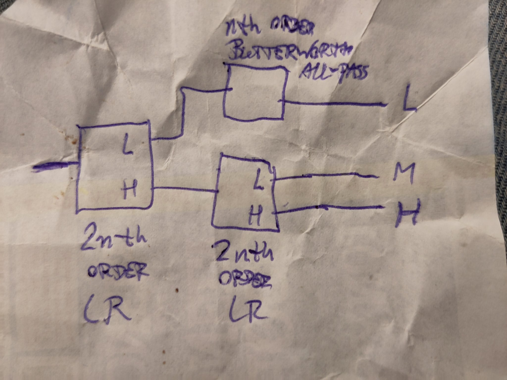

You are bound to get lots of comments that instead of designing a theoretically correct filter and then somehow getting aberrations caused by driver imperfections under control, you should just throw together a random filter and use numerical optimization to get the acoustical response right. You always get those when you ask any question about crossovers.
Anyway, theoretically you need to add a Butterworth all-pass filter of half the order when you want to make a third-order Linkwitz-Riley crossover, like this:
Its purpose is to ensure that the upper path gets the same phase shift (give or take 180 degrees) as the bottom two paths. An nth order Butterworth all-pass filter has the same phase shift as a 2nth order Linkwitz-Riley filter with the same corner frequency (give or take 180 degrees).
When you use an even order that is not a multiple of four, such as 2nd order, 12 dB/octave, the mid channel is out of phase with the others and needs to be inverted, like you already figured out. High and low are in phase.
Regarding an auxiliary high-pass to get rid of subsonics, I think you can best put it in front of the whole thing.

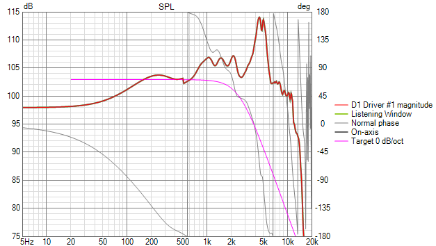

It has been said a million times before and I will say it again more: for proper functioning of any (multiway) loudspeaker crossover, the individual SPL characteristics of the speakers (=drivers) used must be taken into consideration. It is all about the combi of so called transfer functions both filter and driver.
All the wonderfull qualities of the electric part of the filter vanish into thin air once the filter is combined with a real loudspeaker. At the end of the day the acoustic output is al that matters, so the speaker plus filter must be jointly taken into consideration.

What is needed in the first place are measurements of the drivers in the box. For that you need measurments by others or measurement gear. The neasurements usually come in .zma format files for impedance (not needed for active) and in box SPL measurements of the drivers involved in .frd or .txt format. Then you need to optimize the transfer functions of the filter in a simulator, which finally provides the correct (non standard!!) C and R component values in the active filter stages.
The background of all this is that an in box loudspeaker, say a 6,5"woofer, behaves very differently in a real box than when measured on a big AES baffle. Most manufacturers measure on on such baffles. To make things worse, most loudspekers do not quite behave as perfect ruler flat textbook like SPL devices.

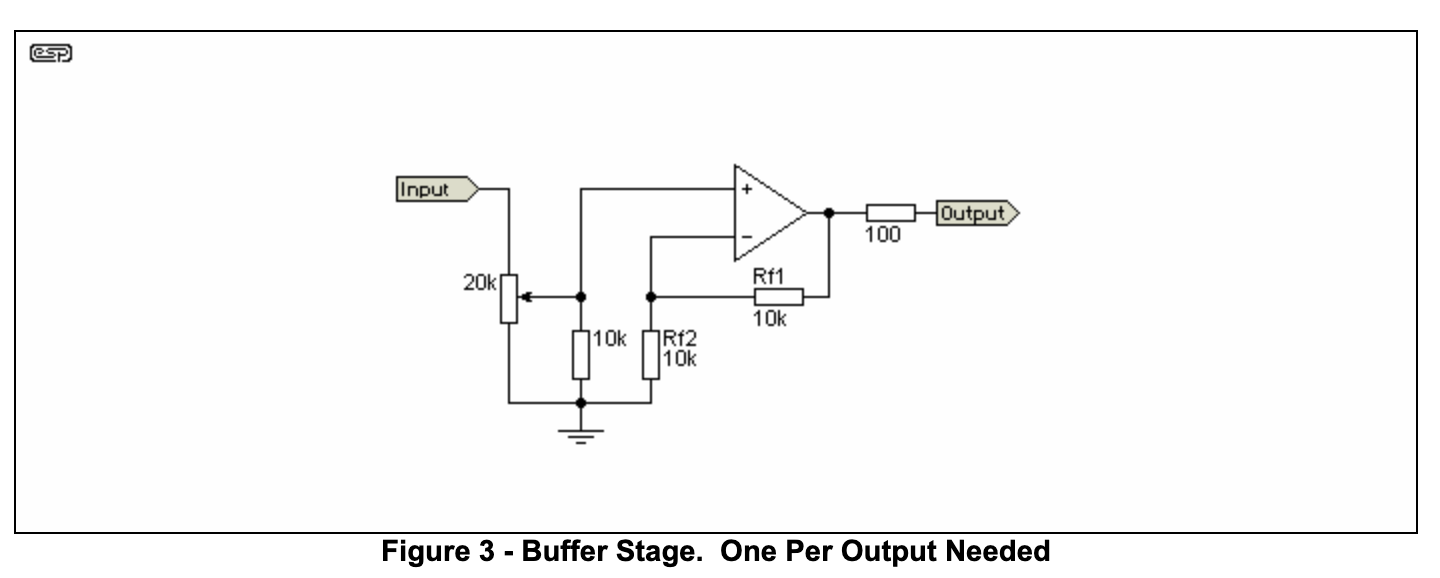

Doubt on how to integrate the buffer stage on the outputs to have volume control:
Do I omit the 100 Ohm resistor in the crossover output and add the buffer stage after it? Or do the 100R output resistors stay there in both parts of the circuit?
Does it also mean I have to effectively add another 3 Opamps to the project?

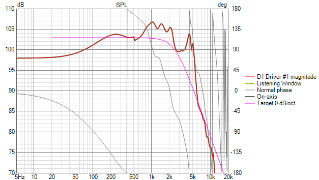

To illustrate the point: attached are two graphs of a real, rather difficult midwoofer in a box, heavily breaking up at around 5 kHz and also showing the infamous Baffle Step.
The purple line shows a textbook BUT2 lowpass transfer function. TRhe second pictures demonstrates what happens if the -nightmare- real driver is filtered by our textbook BUT2 electrical filter.
The resulting driver output is nowhere near the ideal purple line, but all over the place, requiring a number of additional correcting network elements to turn the acoustic ouput into something half decent.. I did not even try to go there.

If in the schematic provided I want to add a volume control buffer stage, do I remove 100R between the two circuits? or is one per stage needed and i simply connect them together?
Re the 100 ohm resistor on the output of the filter stages; You could probably remove them, as Your volume pot's on the buffer stages are 33k. To be sure, do always check the data for Your op-amps so You don't get stability issues.
