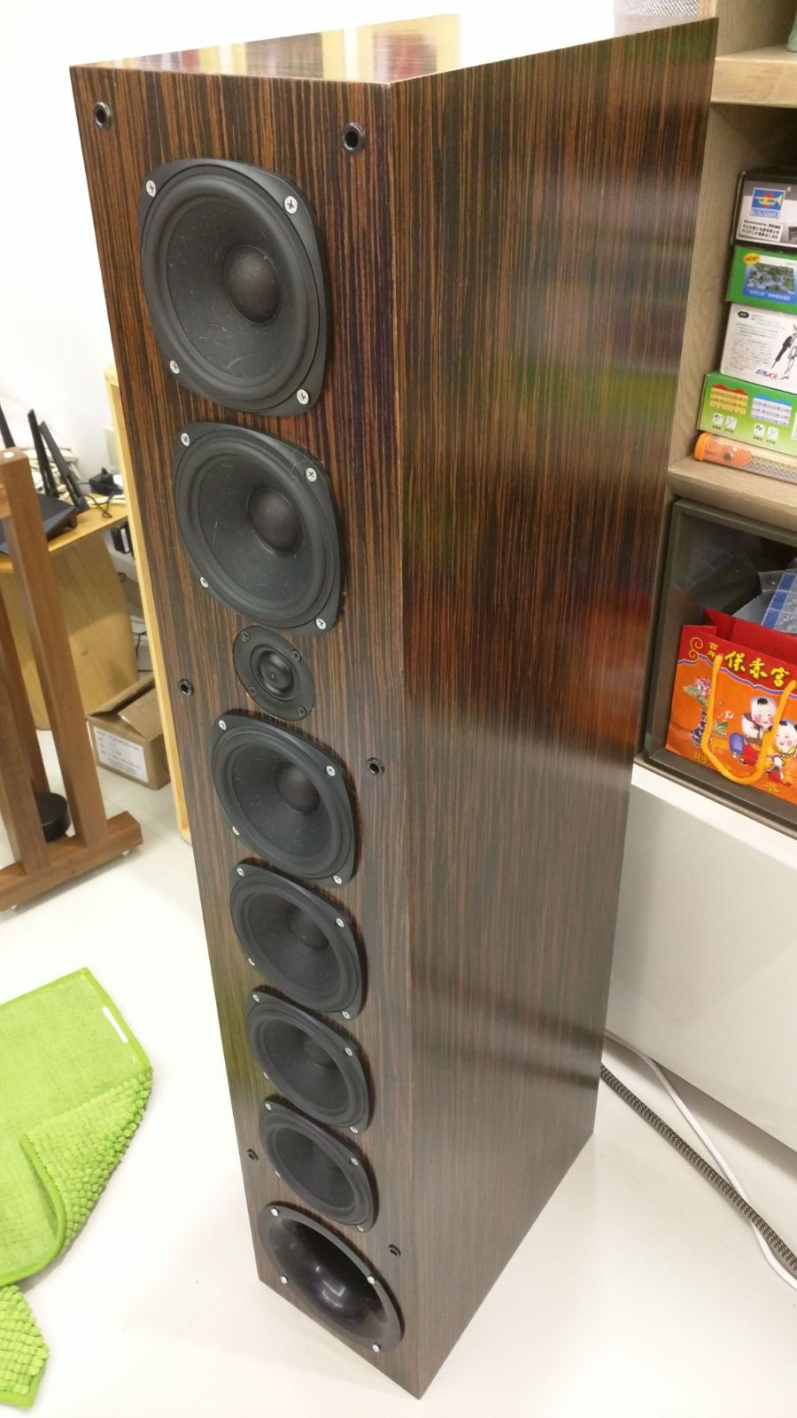

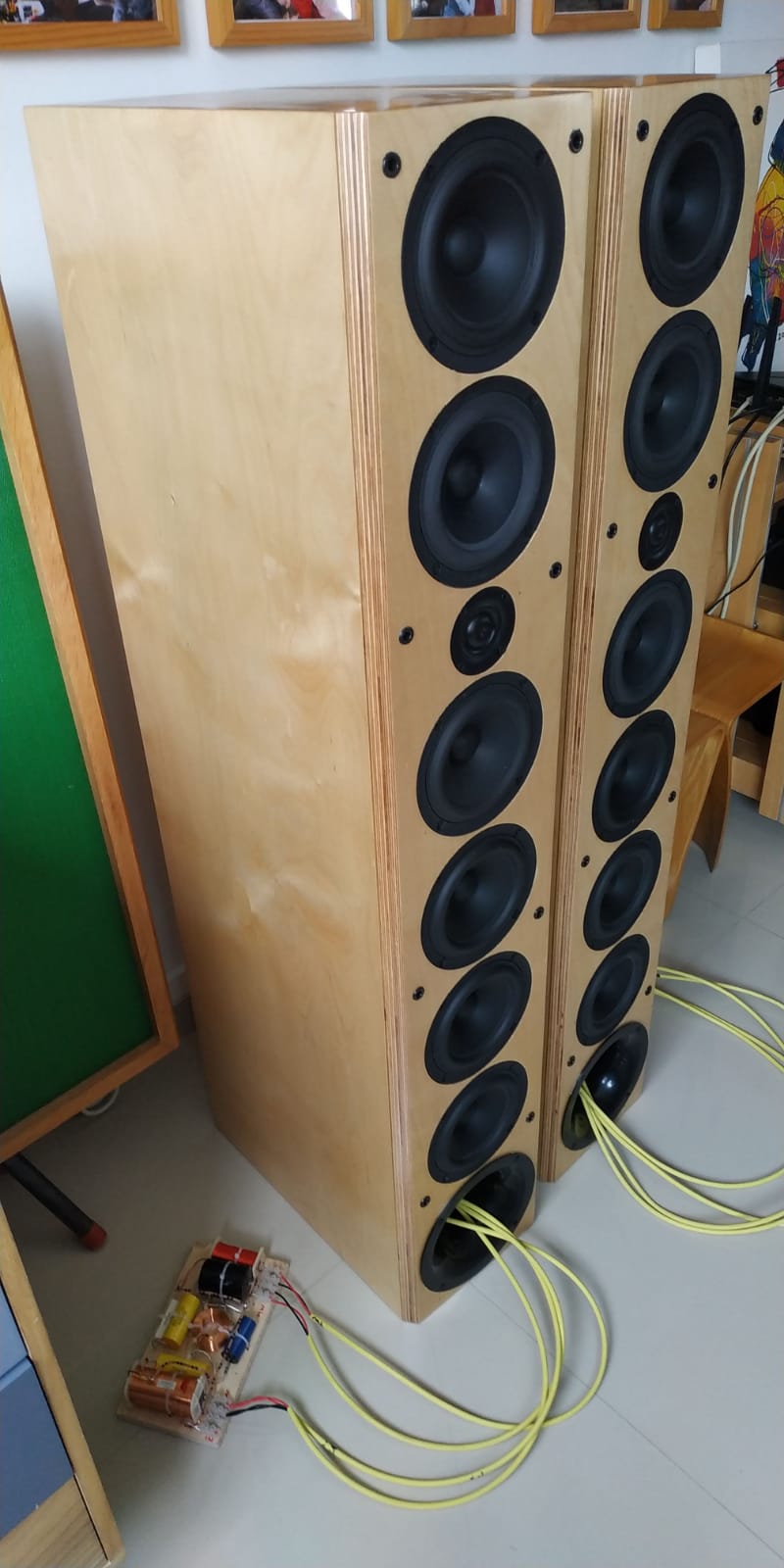

This was my pair of Uluwatu
Yeap, they were definitely easy to drive as only the Uluwatu & Altec 604 could rock out on the 2A3 SET.
Again, the bass is WORLDCLASS in terms of punch, depth, speed (no overhang) and ability to GO LOUD. I never heard drums so real reproduced ever.
What lacked was, despite 6 woofers per side, they aren't detailed. They cant be matched as a woofer modules to high end diy designs I had.
Sure you might say it was unfair i wanted them to match to Acoustic Elegance TD15M and JBL beryllium compression driver but the bass was THAT GOOD and in my scenario i had hoped it worked.
I tried the same design with higher end SB midwoofers, the SB15NRX but it didnt work as i planned.
Ive contacted someone to help design me something with Satori midwoofers in hopes to get the same magic but at a higher fidelity level.
Midrange? Voices? This is where they aren't as good as 3 ways. Being a 2.5 way the vocals are by 2 mids that also does bass. It could've been cleaner but pop/rock fans accept them as is. One could consider using the uluwatu midwoofers and cabinet only as a bass tower to match to any bookshelf speakers they want to get best of both worlds.
Imaging? SB Satori drivers' QC is unparalleled from what I was told by them. I've measured a pair of Rinjani entire speakers and found the impedance to be within 0.5% of each other. Whilst Uluwatu doesnt use satori drivers, imaging was rock solid despite a big tv between the speakers.
