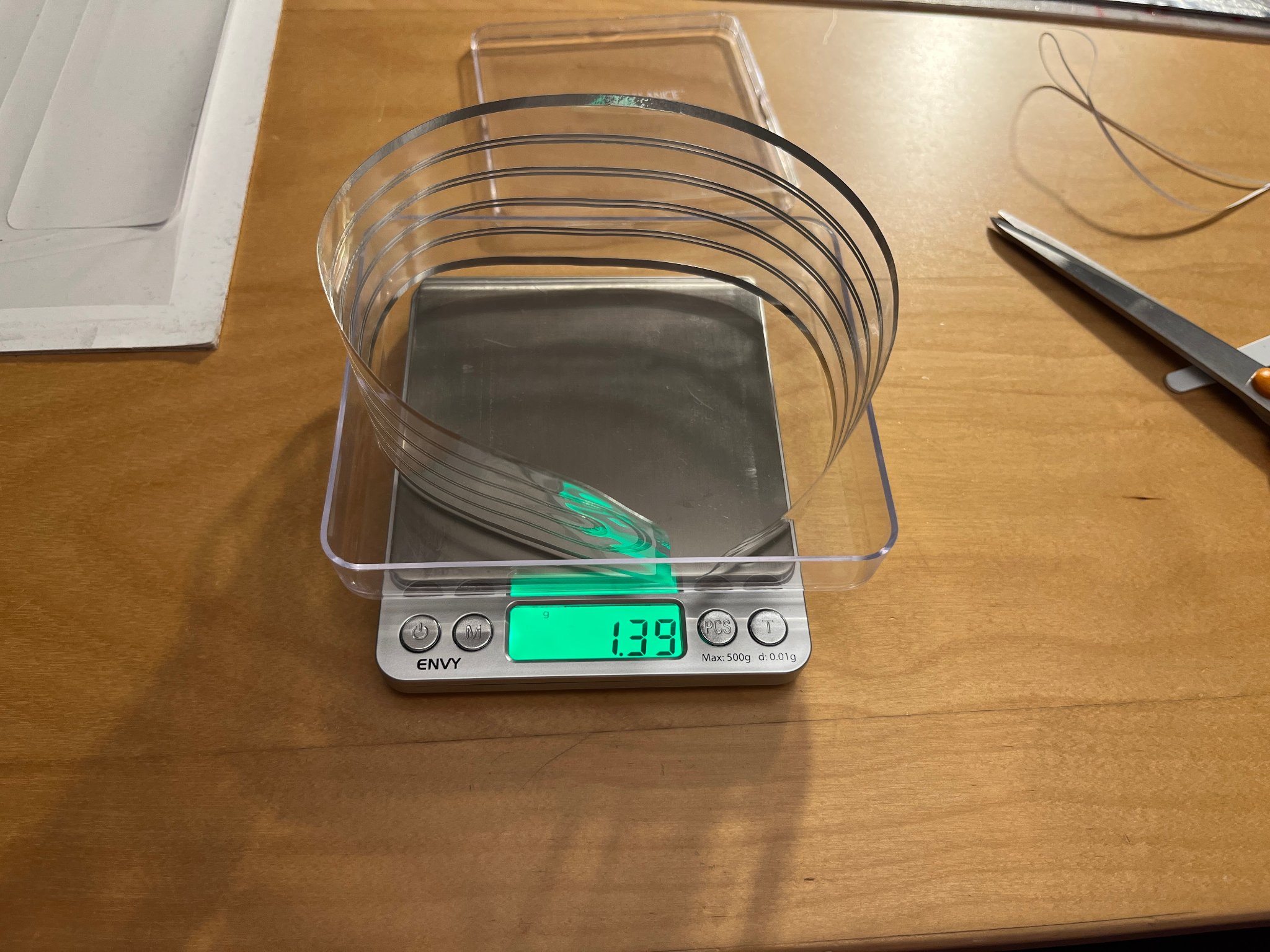

Here's what a bare (no adhesive) 3M 74 PET film (13µm) looks like after baking at 140°C for 10 minutes:
Very interesting!
That looks stiffer than my experiment, although I did not test how stiff it is without any aluminum. It might be worth for me to play around with increasing the temperature.

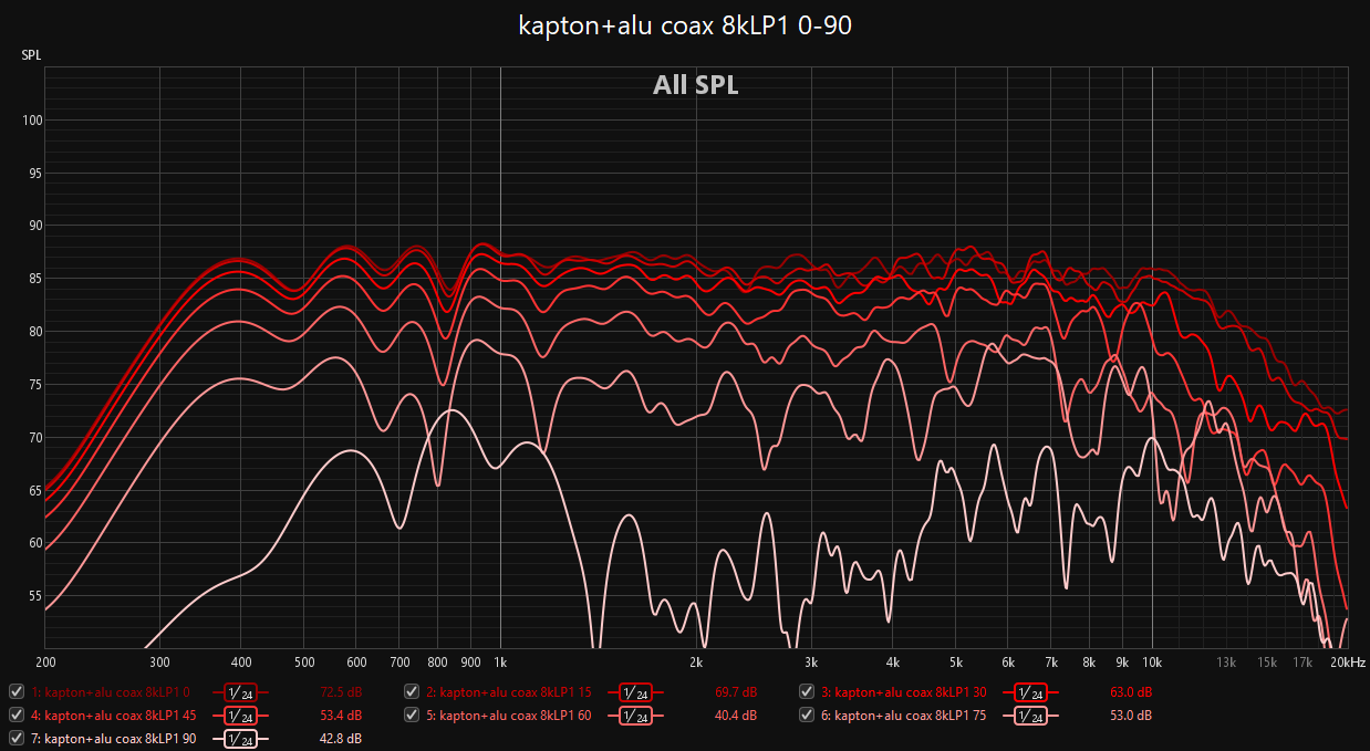

I have measurements from the foils in this post.

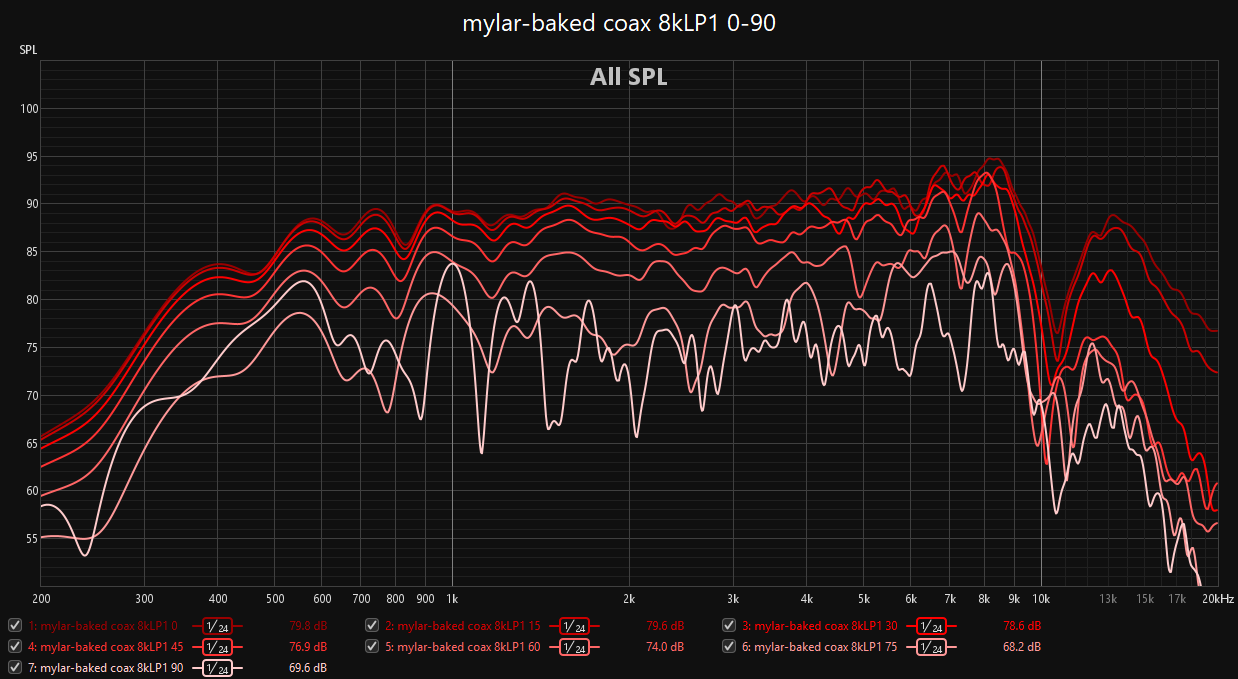

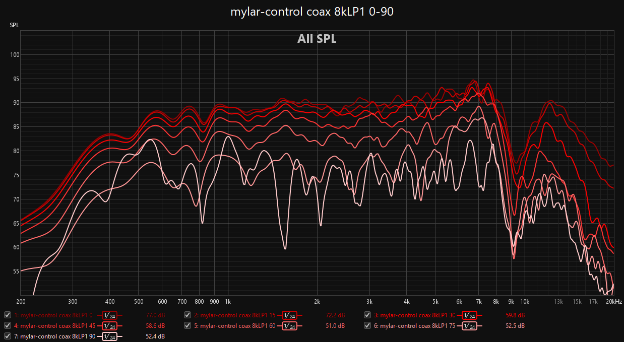

First the "default" 12 um kapton + silicone adhesive + 12 um alu:

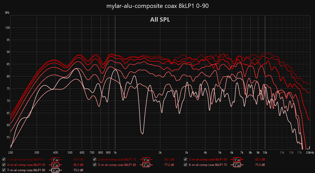

Next the 10 um mylar + 15 um alu composite I got from @solhaga
Next the control 12 um mylar with lots of gaps:
Lastly the baked 12 um mylar, baked @ 140 degrees C for 20 minutes:

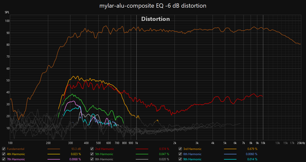

In conclusion, the mylar-alu composite is a lot more efficient than the kapton silicone adhesive variant. Also, while I did not feel much of a difference between the baked and control membrane, the baked one does seem to be stiffer since the dip is higher up in frequency. I still believe that a 23 um mylar variant would probably perform better, but this at least shows that baking does work. And maybe it will work even better if I dial in the temperature.

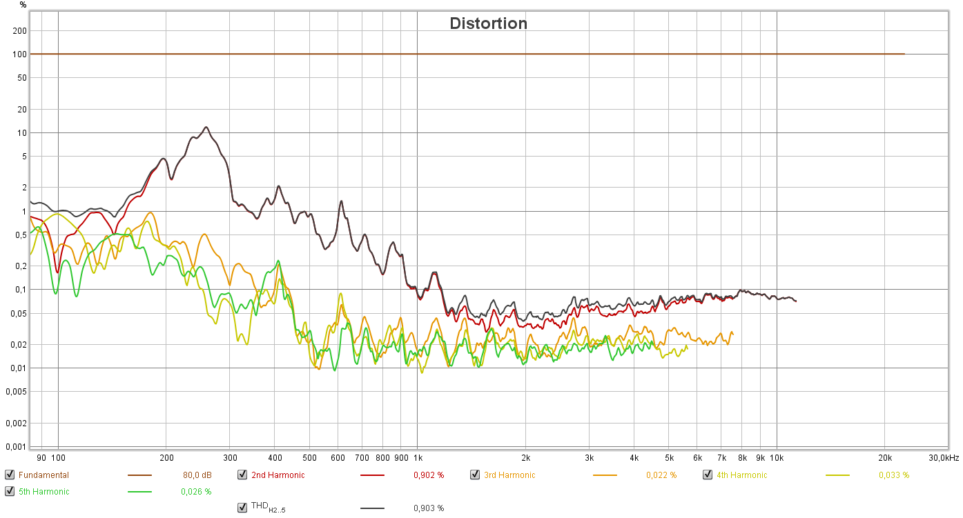

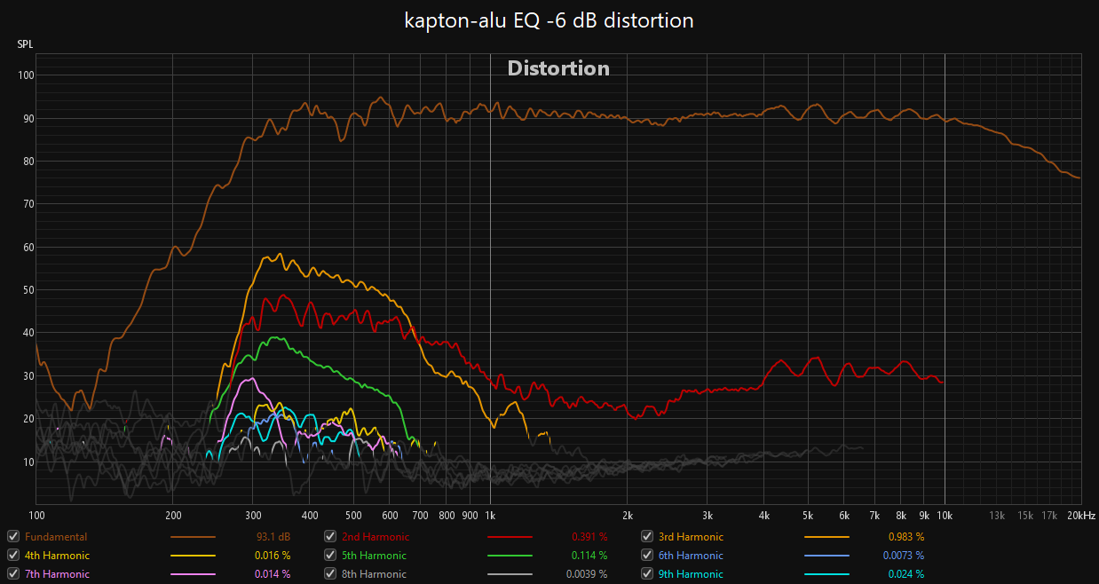

I also did distortion tests between the kapton-adhesive-alu and the mylar-alu-composite. Both of those is with the same signal and with a 370 hz LR4 roll off which is lower than I will probably go for in the end. But the interesting part here is that the mylar-alu-composite is not only more efficent, it also has lower distortion.

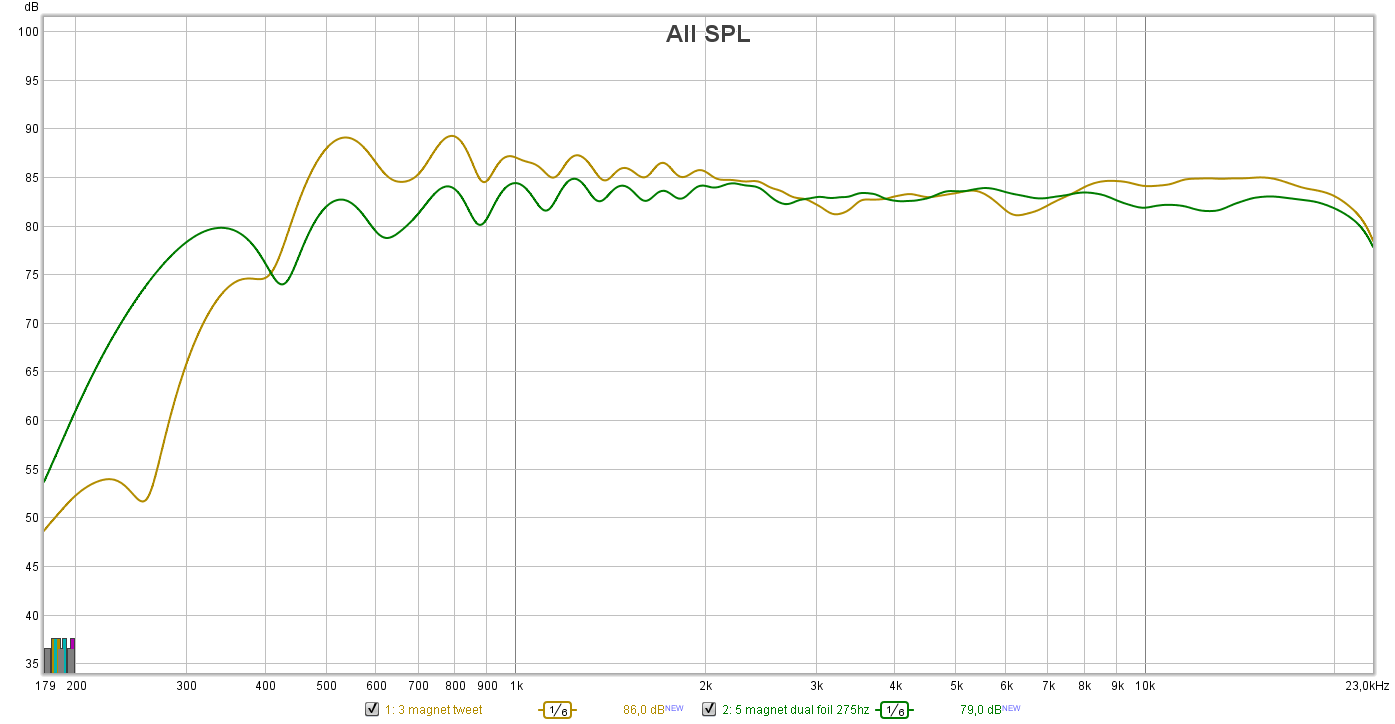

i made another version of the panel i used in my latest tests, but used the Laminate as carrier. but i made it 2 magnets wider to try to lower resonance down to the other panel... it overshoots.... so laminated has res of 280 or something and the regular tweeter variant 450-480hz. the laminated looks much better in the lower end. (even does look better in the top end but i think its due to its width still allows top end to add up. but dispersion sucks)
FR
Brown mylar and alu coil
Green laminated mylar with 2 more magnets 4 ohm compared to 2.8 of the tweeter.
Distortion regular mylar with coil
Distortion laminate version
of course the tweeter was never meant to be crossed this low 🙁. but its nice to see the extra stiffness does work pretty wel for a wider panel. i dont think it works nice for tweeters.... or line source since the mid low will already be much louder (unbless you remove that to just get lower distortion and you are ok with the max spl the 15Khz can put out.) then the top end. but in your case you have allot of unsported mylar. that might work wonders !! i hope it does !

A nice benefit is that the frequency response is also smoother, less dips and peaks.
And you could possibly do a tweeter that wide, if split the inner and outer coils such that you can drive them coaxially 🙂.
well it did. not sure if it has to do with the foil or the method i put it in the frame... then again the lower end looks better.Cool!
but i am sure it does lost top end, but because its wider it still managed to reach 20khz, making it less wide will ramp up resonance and make the top end fall off earlier. thats why in a longer / less wide version it might look different in the top end

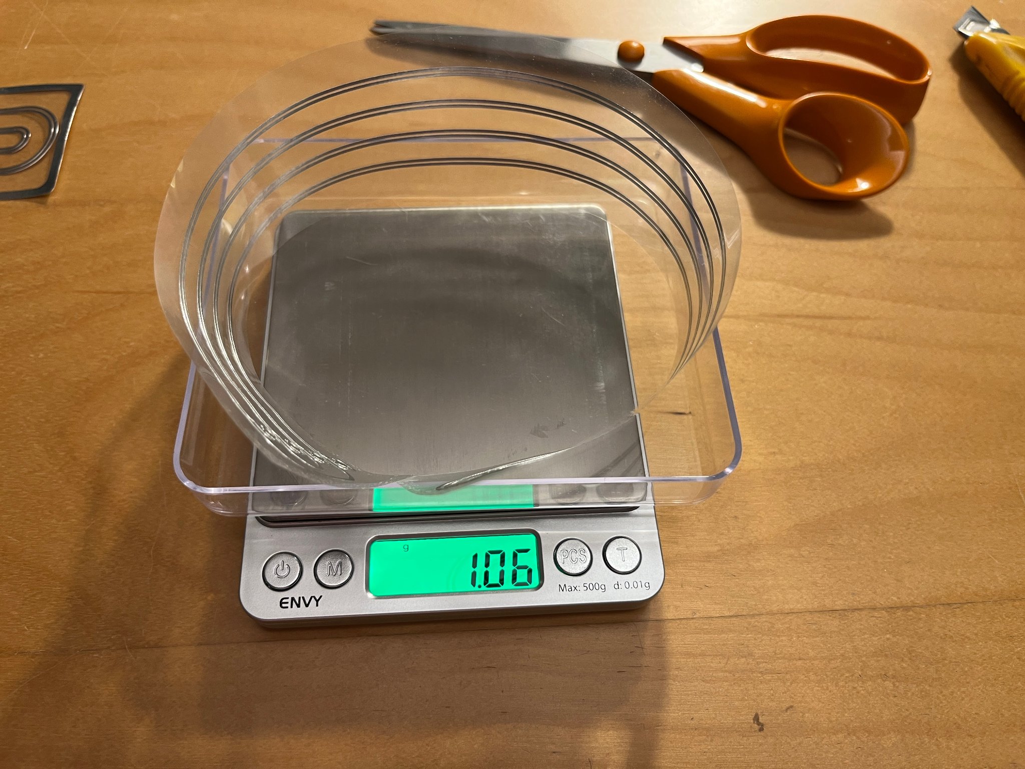

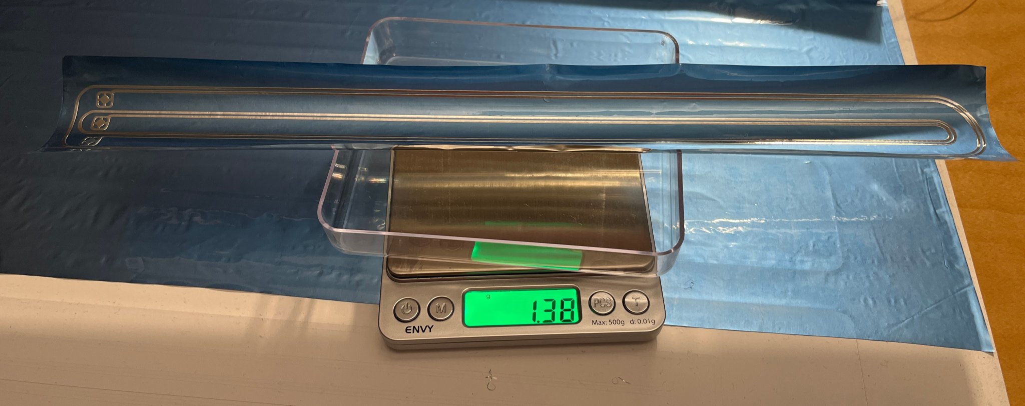

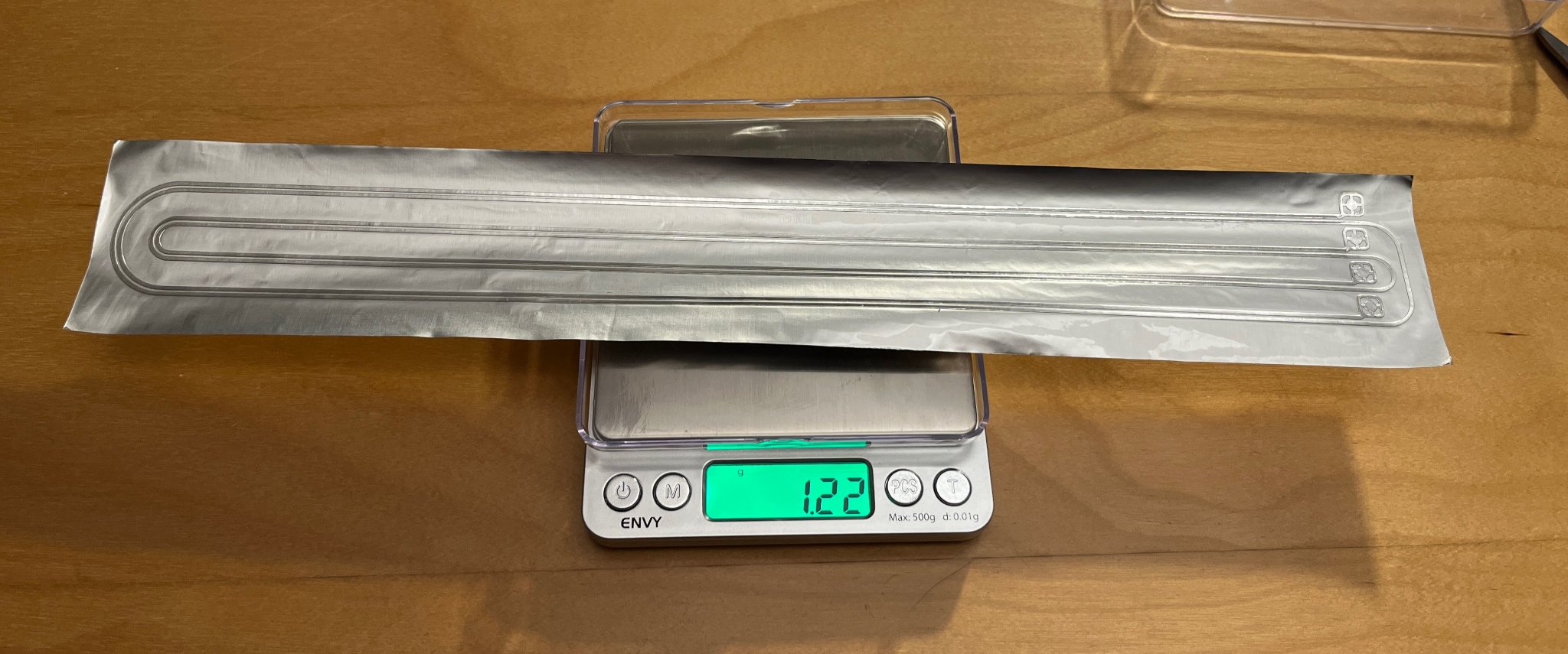

Here is the 12 um mylar + 9 um alu. Or at least that looks to be what we think it is. It is very heavy though. Either the mylar or alu is thicker or there is some adhesive or extra layer that adds a lot of weight.
Compare this to the supposed 10 um mylar + 15 um alu from @solhaga
Either the 9/12 is a lot heavier / thicker than the spec, or the 10/15 is lighter / thinner than we think it is.

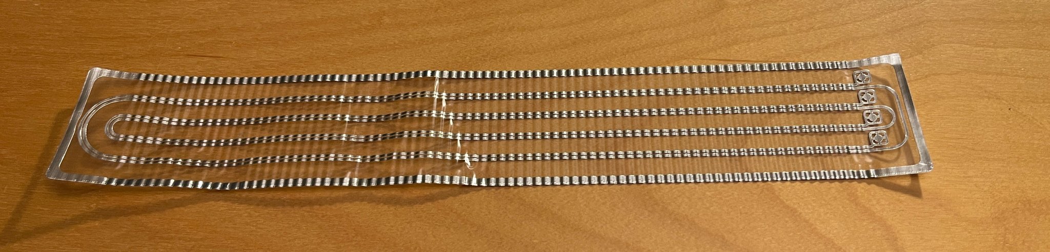

I also played around some with the 23 um thick mylar:
Here is with and without the border. The border adds a lot of weight so if I go with the plain mylar, it might be worth playing around with using a thinner border to save weight.
I also tried to corrugate a 23 um mylar + 30 um aluminum without baking / annealing it, and it definently does not work! The mylar is too stiff so it does not hold the corrugations:
I might try with some thicker aluminum traces also, to use 50 um alu instead of 30 as used here but in the end I think baking might be a neccesary step when using this thick mylar. This probably also means that using plain 25 um kapton, which has too high glass transition temperature to be able to be baked / annealed without burning the acrylic adhesive to the alu traces, can be discarded as an idea.

Oh that is indeed heavy!!! yeah so the datasheet might not be correct 🙁 that explains the loss in top end in my tests.
