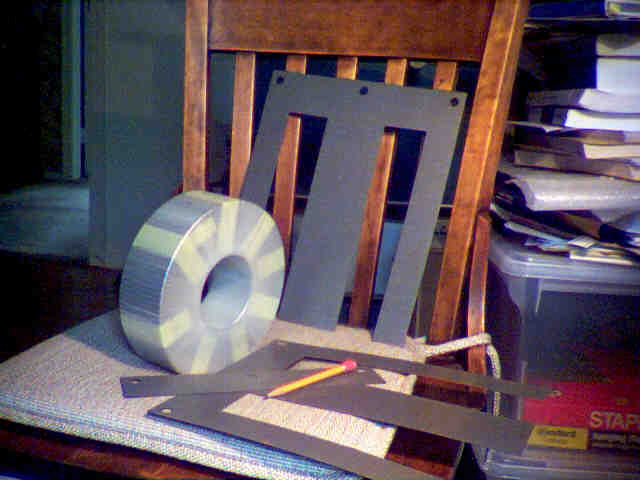

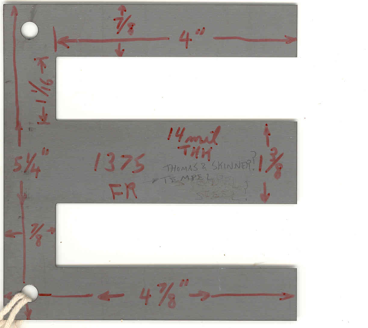

Going from a toroid core or C core with two bobbins to an E-I core will sacrifice some HF performance. More winding interleaves only goes so far, until distributed capacitance starts getting excessive.
For low leakage L -AND- low distributed capacitance, the windings must be long and thin and in-phase magnetically for the full length. Toroid does that naturally.
A long E (E-I) can also produce that effect. Partridge OTs used this (it was the BIG secret back then). Long E lams rarely (never) get used these days, but would work perfectly for placing two bobbins on them for the Twin Coupled design (all windings driven by each tube, so in-phase). Long E lams would further increase the performance of a Circlotron also.
I have a 60 lb box of long E lams from Tempel Steel that are M-6 material and made for constant V xfmrs (by adding some shunt shims half way along the long tongue). Two standard bobbins fit on them. They were giving the stuff away as samples 10 years ago, no one making constant V xfmrs anymore.
It is inexplicable that modern high performance (and moderate cost) OTs don't use these type of lams. Just as easy to wind as standard E-I xfmrs. Edcor could easily make high performance OTs with the winding equipment they already have.
(NOTE: for long E's: putting half of a center tapped P-P winding on each bobbin loses the long in-phase advantage, each half of the P-P CT'd winding must extend across BOTH bobbins to get low leakage L and low dist. cap. )

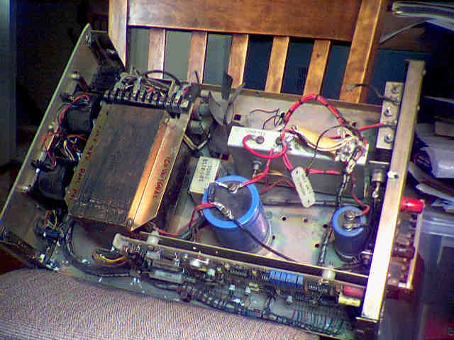

Above pics:
The really Big Long E lam in the second picture I got from a scrap yard in Stamford Ct years ago. A pile of them were in a cardboard box with a shipping label addressed to Dick Sequerra, designer of the Marantz 10B.
The last picture is of a Lambda (or Kepco) power supply. They used long E laminations to squeeze a big power transformer into a lower profile case.
Correction: It apparently was Acrosound (not Partridge) that used the long E lams for OTs.

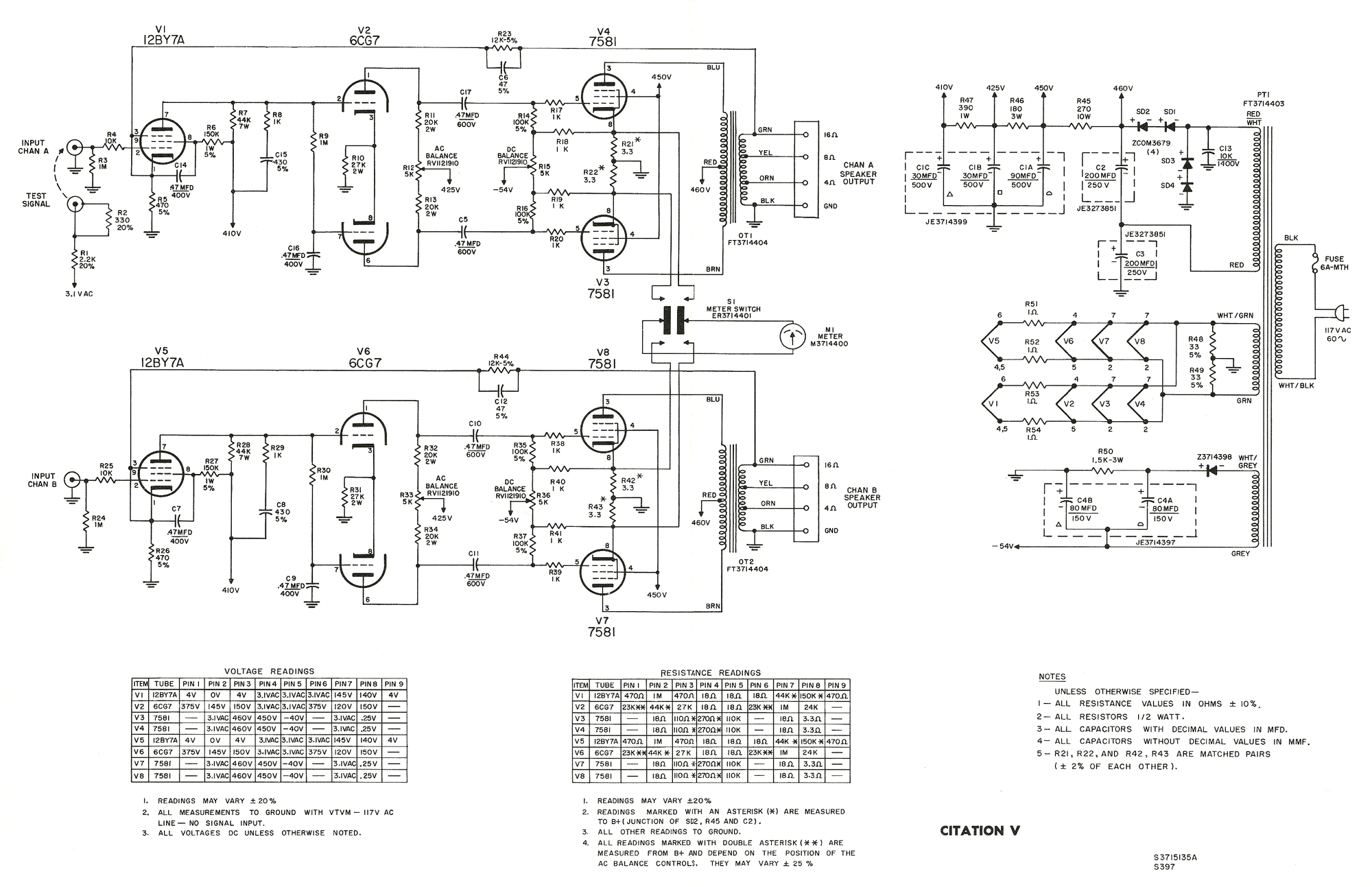

I suggest you use the Harman/Kardon Citation V as the model. The Cit. 5 is a superior implementation of "classic" Mullard style topology. Mullard style will yield decent results, even with O/P transformers of so/so quality. High quality "iron" yields excellent results. Let your budget decide, while still getting good sound.
Supplies of the 12BY7 voltage amplifier are becoming more and more problematic. I've provided a cascode of the in production 6922 as an alternative voltage amplifier.
