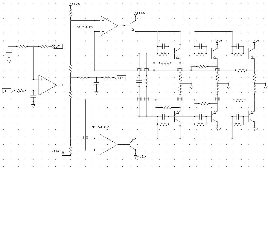

Now to improve efficiency we would need to adjust the main rail power supply. This also has the advantage of keeping the output transistors collector voltage close to constant.
We can do this with either a linear or switching method. The trick is where to insert the semiconductors. I show this with BJTs although if switching there are better choices.
And then if you change the resistive feed from the +/-12v supplies for a pair of CCS..?
Edit: or one could simplify by keeping the resistive feed - but fed from a heavily-filtered 'tap' of the output rails, for simplicity (Chucking away c.50v allows a very large RC, or at least wide range of choice of R feed versus series I.R drop, surely)
...D'oh. Its the end of a long week.
...logical extension would be: surely you could then make the two series feed resistors from +/-12v supplies into two pairs of series resistors fed from the output rails instead - and merely join the two 'centre-tap' junctions with a cap...
(I can't quite visualise the stability risk in my head right now, but it can't be too far awry if the cap is large enough)

What happens if no loudspeaker is connected? 🙂

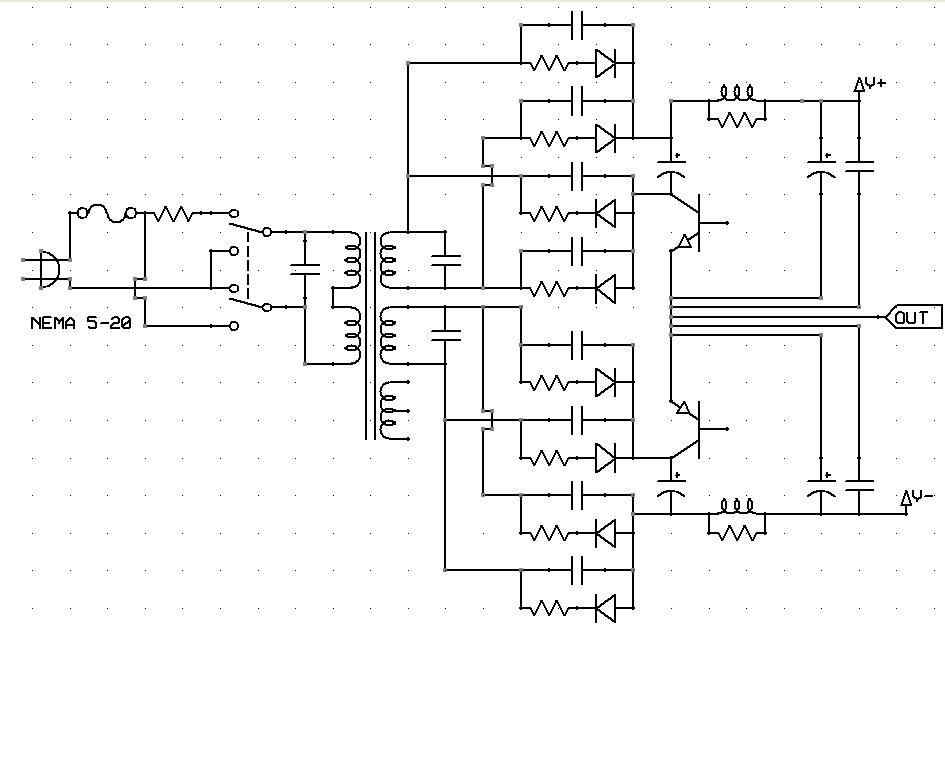

The cost of the extra windings is just 60 turns on the toroid core. Although a separate transformer would give you a cleaner power supply feed particularly if you use a flatpack dual bobbin style.
As to a CCS you are getting it. Although what is being shown now is a maximum power amplifier the floating power supply has advantages in a very high performance design and has been sold as such. Personally I would use it with a single pair of output transistors for a 100 W+ amplifier.

So if I use a 65 volt dual winding transformer what VA rating would be required and what power would the amplifier deliver into an 8 ohm resistor? What would it be into a 4 ohm resistor?
Trick question! Since the AC line is fused at 20 amps a transformer much greater than 2400VA continuous rating is only of limited use! So how do you determine the intermittent transformer rating?
Now 65 volts at 120 volt input would give rails of 90 volts. The rating of our output transistors is 180 volts. So if we look at SOA we most likely will blow them up!
Even with 90 volt rails we only get 500 watts into 8 ohms, but 1000 watts into 4 ohms. The amplifier would be able to actually drive a 2 ohm load to just under 2000 watts as the transformer would begin to sag. (Or the power line!)
