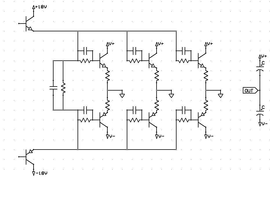

As pointed by some , the usual double EF is beta limited,
while a triple EF is hardly stable.
The better path is to use power mosfets since gates capacitances
current requirements are far easier to deal with , not counting
a better phase response that allow more energic feedback
to compensate for the lower linearity of powermos...

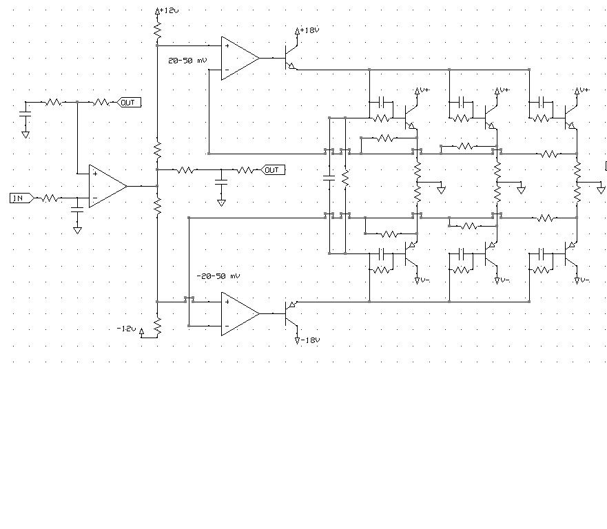

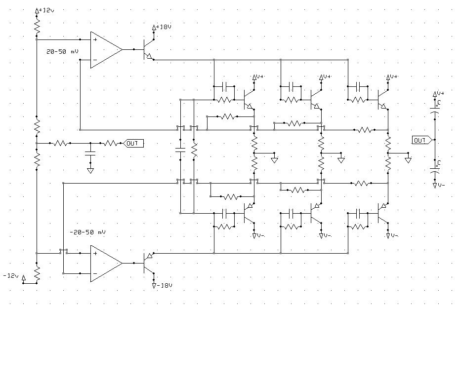

Let us look at a possible output stage that is easy to drive!

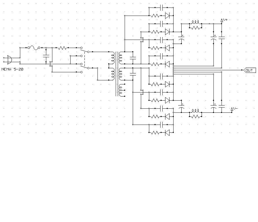

Yeah, that one's easy to drive, but now you've got to buy two transformers. Unless of course, you're only building a mono subwoofer amp.
Two of the issues to address are the type and manor of feedback and the influence of noise on BJTs.
The best way to address the noise of the power supply is to keep noisy circuits isolated from cleaner ones.
You can use an extra winding on the transformer to power the rest of the circuit or you can use more transformers. You would need to wind 60 turns on atypical toroid to get the extra winding. Not really a big deal.
This is a maximum power from the AC outlet design so of course it is a mono block. You really don't want to drive a tweeter with more than 1000 watts. Although I do have a system that did.

The input line cap should be after the switch! That cap should be a 10 uf motor run type. See McMaster-Carr
Part # 7602K27
Now who can tell me why the DPDT switch for power?
Part # 7602K27
Well so far the few suggestions have been reasonably good, but the next issue is how to bias the output stage. The design I have in mind not only provides accurate bias, it also reduces output stage distortion and DC offset.
Any guesses how this is done?
