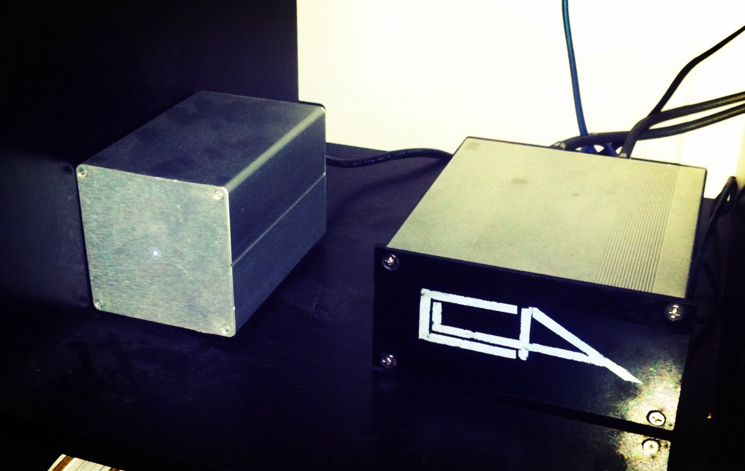

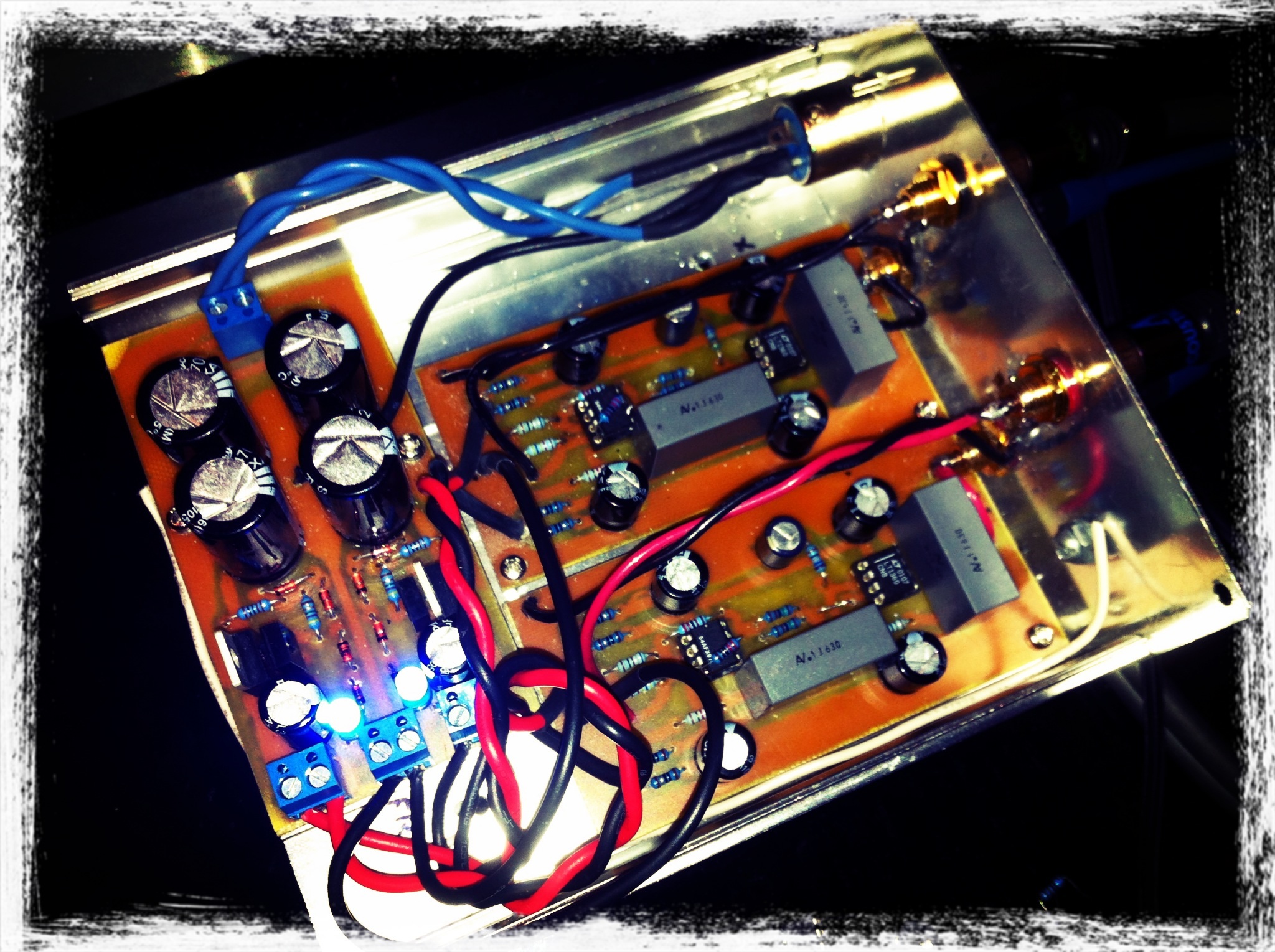

A couple pics of the phono stage 🙂, simple, ultra low noise and very carefully chosen ic's. Fully Dc coupled I to O with no dc servo.
Hi Colin ,
Thanks for the pics ! great building quality .. short path .. decent wiring etc.
great job ! I see lots of MF resistors .. were you hunting for the lowest noise numbers / acuracy ? I play/switch a lot with resistors in order to tune the sound !

Thanks Paul,
You would think using ic's would simplify things, not the case at all in reality. It took a lot of rolling, resistor/capacitance ratios, gain mods, and power supply tests to come up with this. After all how easy has it ever been to combine the punch and precision of Solid state with the harmonic richness of tubes without raising noise?. It's basic operation is similarity use in the Vendetta, but wih a Fet input high slew op amp for the input and a high slew diamond transistor vfb op amp to the active stage. All the while paying meticulous attention to the feedback ratio for the active stage, too high = no life in a nutshell.
Colin
