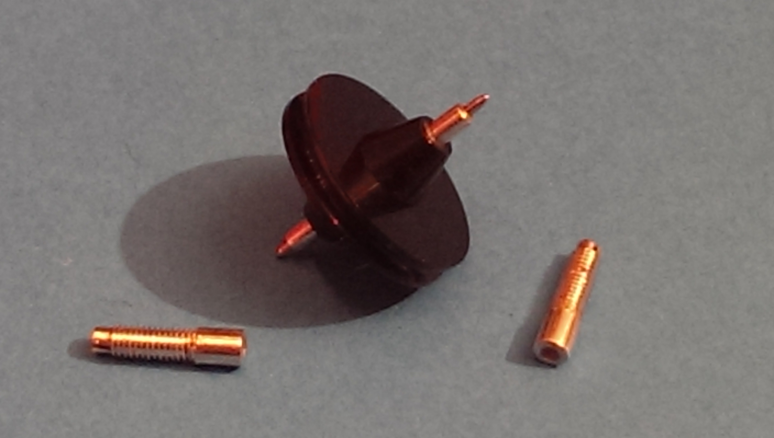

Hi Bill.
The chatter I was referring to is not caused by rotation. Within the bearings the radial load is supported by only the balls at the bottom of the race. If axial load is low the rest of the components in the bearing will only be in light contact with each other. During record replay vibration from the stylus passes via the carriage to the bearings causing the loose components to rattle against each other producing further vibration which in turn is passed back to the cartridge. The effect occurs at discrete frequencies where the components resonate against each other. The effect is audible as a harshness associated with certain notes.
This is probably a moot point as cantus, clearaudio and the contributors to this thread all use unlubricated ball races and don't seem to suffer chatter. I have heard an old sme with shot bearings that suffered chatter.
Pin bearings are definitely worth investigation. They're relatively easy to make and cost a lot less than premium ball races.
Niffy

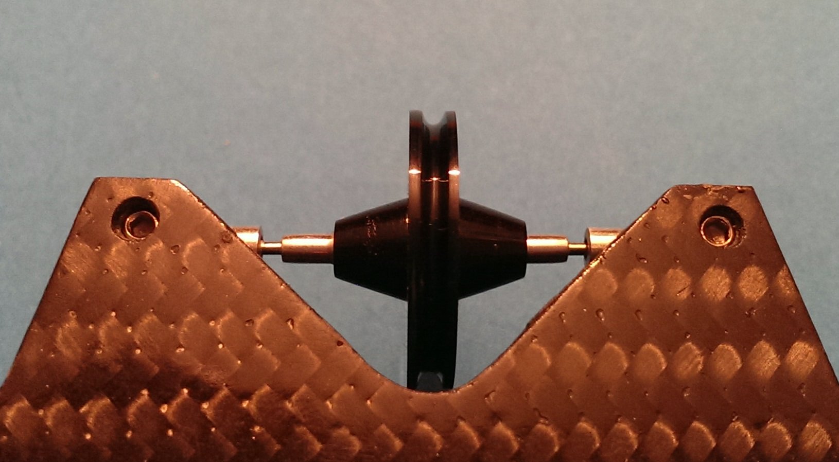

Here are a couple of pics of my pin bearings. I hope the pictures are clear enough. I've shown them attached to the yokes of the carriage and separated for clarity. The attached wheel is 21mm diameter to give a bit of scale. The wheel is a little eccentric and is to be discarded.
The vee cup is just visible in the end of its mounting. The mounting is made from 3mm aluminium and is 13mm long. It's threaded for mounting and adjustment. The vee cup is fitted into a 1.6mm diameter hole in one end. The vee was made by inserting a short piece of 1.6mm teflon into the hole. The teflon was formed by pressing a heated former, a 40degree cone with a 0.65mm domed end, into it using a drill press keeping everything nice and square.
The axil is threaded 3mm aluminium again. The thread has been removed on the exposed section. The pins are 1mm diameter stainless steel with a 20degree cone with a 0.5mm domed end. They are press fit, with a bit of superglue for safe measures, into 1mm holes in the ends of the axils.
The wheel as shown is held in place by threaded hubs made of acrylic. I am hoping that these hubs, at 7.5mm diameter, will be large enough to lock the outer race of 3x10x4mm bearings allowing them to be used as wheels.
The overall length of the axil, from pin tip to pin tip, is 25mm. There is virtualy no play and this keeps the axil very stable with no wobble. The axils are also 60mm apart giving the carriage a very stable footing.
If you need any more details let me know. Unfortunatly I couldn't get the drawings to upload.
niffy
