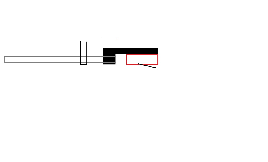

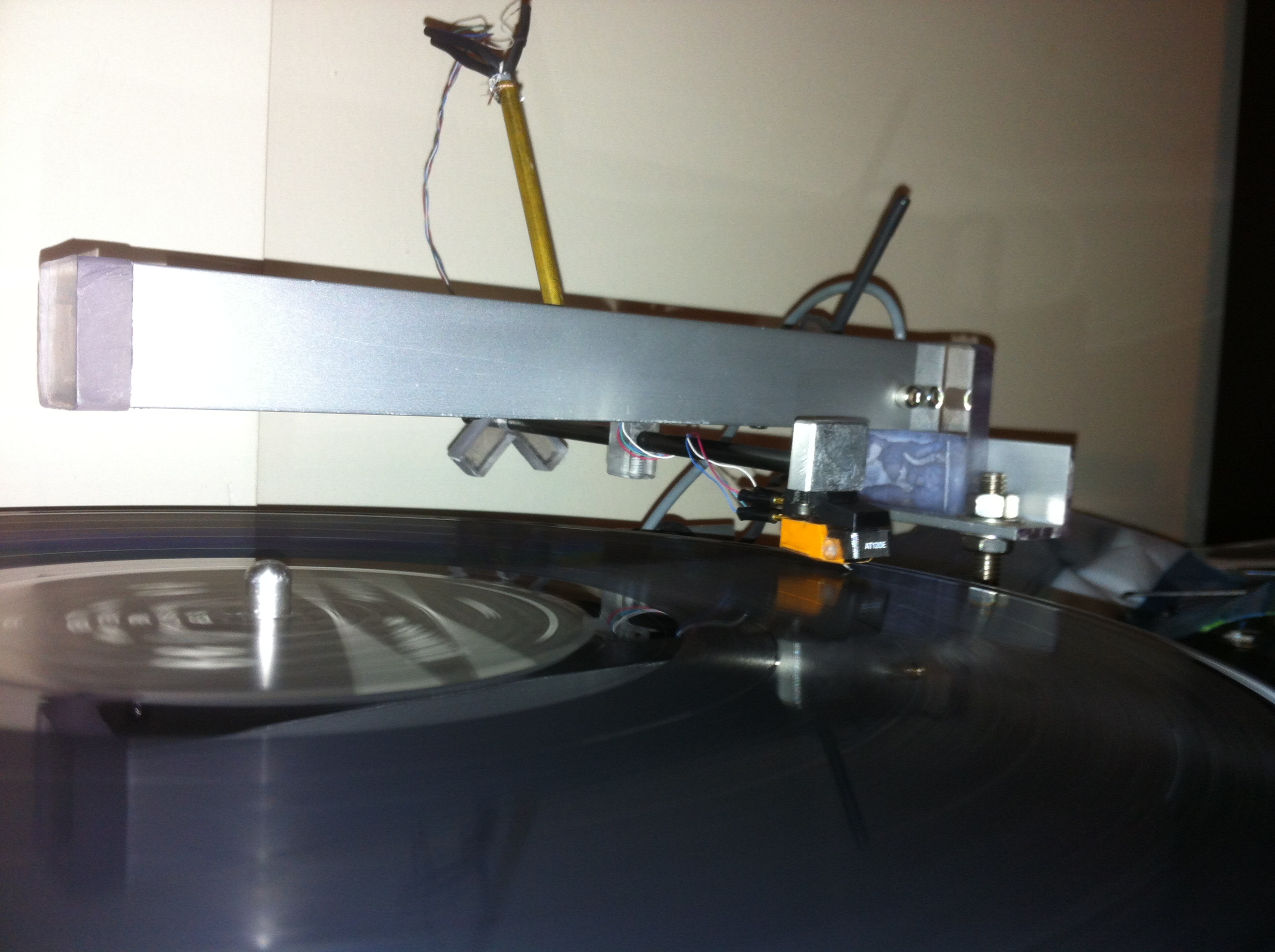

To all,
Just made a new armwand with a 5 g solid alu block headshell, a substantial improvement !. It is 3/4" w 5/8" h and 1/4" deep, and the cart mounts to the underside 3/4" x 1/4" section . I'll post pics later, had quick listen and tracking is even more improved noticed on the first 10seconds easily 🙂.

This is about as good as it gets so far, no lf resonance due to rigid mounting, and the aluminum headshell has taken it another notch up. Mass loading above the cartridge is a good thing here, and with the headshell being wide but shallow diminishes microphonics since as many may have noticed the typical thin/ flat headshell seems to become its own amplifier in many cases.
This aluminum block diminishes greatly the sound heard with volume off comng from the cartridge which means less energy lost from tip to coils.

I had a bit of an experiment tonight. I added extra mass at the cartridge end, courtesy of a steel 'spacer' I had from a Clearaudio cartridge and counterbalanced it at the counterweight end. Result-a significant improvement was immediately noticeable-everything was more 'real' and tangible. I'll be fabricating a new carriage this weekend incorporating the higher mass principle.. This is beginning to get more than interesting! I don't think that adding mass under the pivot will give similar results.

Glad to see you have tried it, it's a night and day difference in the focus, power and imaging of sound. Weight below the pivot is wasteful I feel, use it to improve stability and vertical mass at the same time 🙂.
If I do the rough math here the cart 6.5g alu 5g and wand 1.5g makes for a minimum vertical mass of 13g. the total lateral mass is about 30g now.

Moray,
Thanks to an adjustable armwand azimuth and reach by a single.set screw, and adjustable bearing reach with the bolts I can change the cog to anything I want or works best. The best I have found is having the cog slightly in front of the pivot.

To all,
Colin
Colin,
Real curious as to how you got those dimensions up to 5 grams. I cut a piece of aluminum to those dimensions and get 2.9 grams. Does either or both of us have scales that are that far in error?
BillG
Bill,
I cut mine from a scrap of 1/4",thick aluminum and measured the weight of both that i cut at 5.g from a scale in our lab at work, and yes the scale was zeroed 🙂.
Colin
Colin
Hello BillG and vynuhl.addict
I solid modeled an aluminum block measuring 5/8x3/4x1/4 and according to my software, it weighs 5.2042g.
Sincerely,
Ralf

Ralf&Colin,
Thanks guys. I guess my scale needs new batteries or throwing out.
BillG
