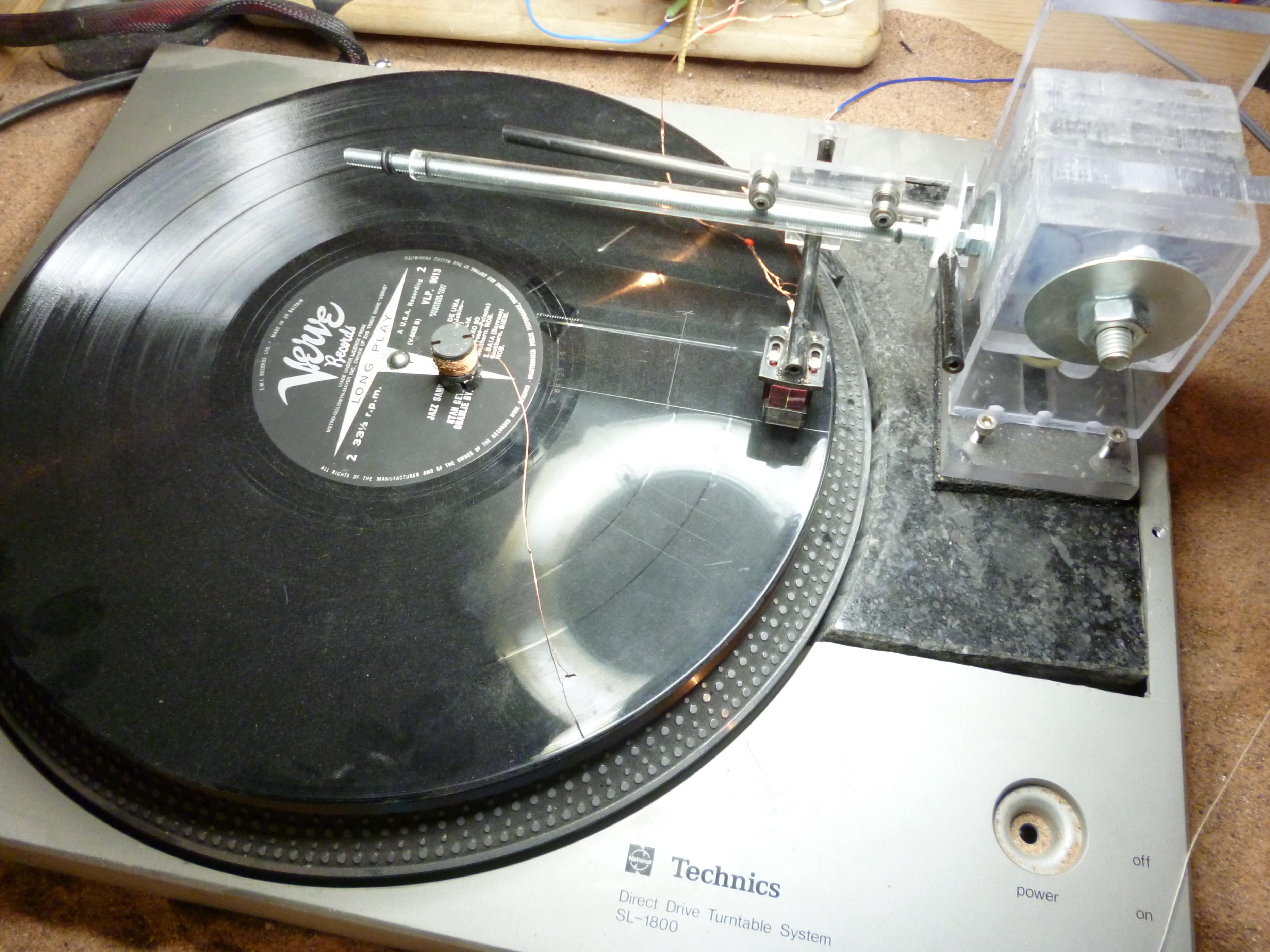

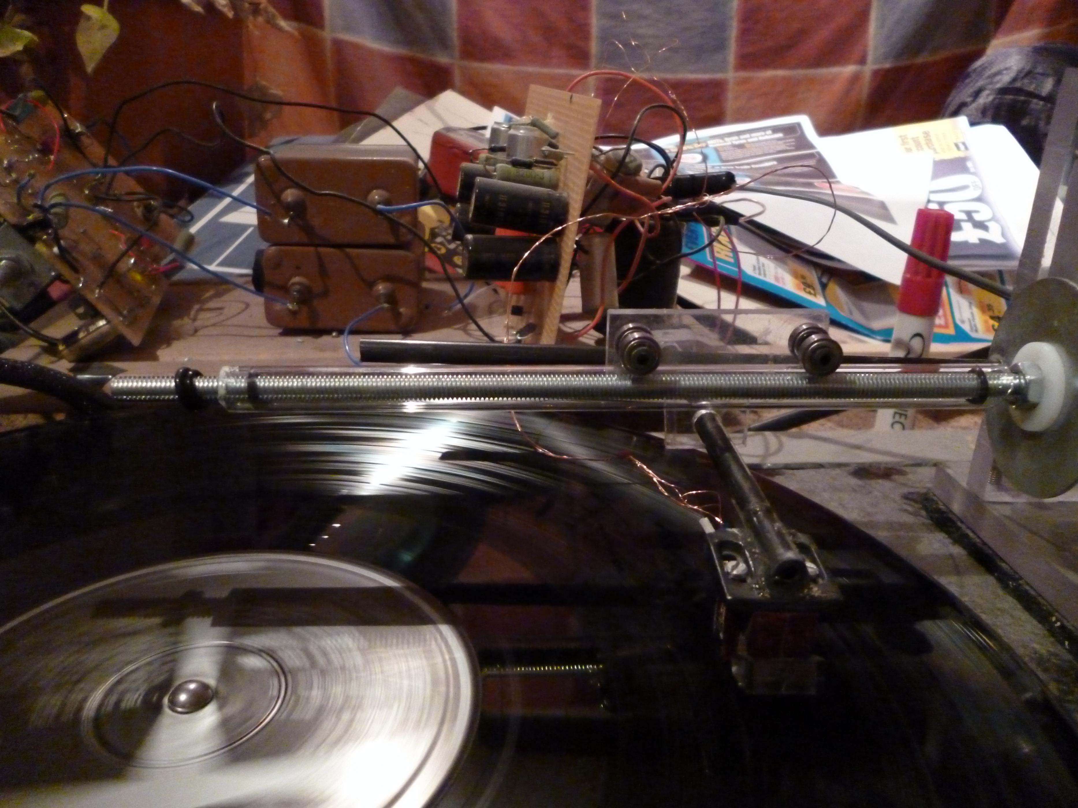

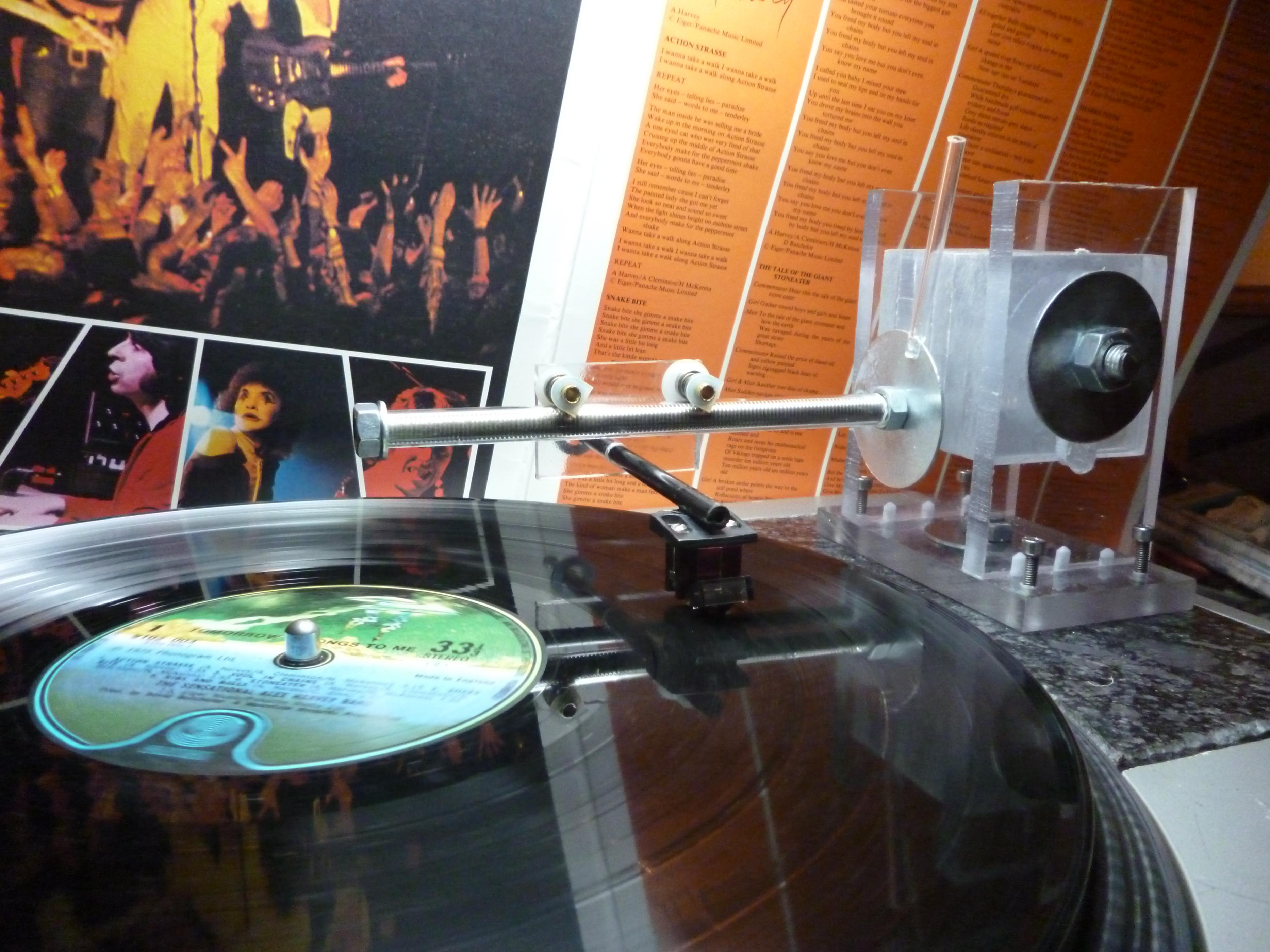

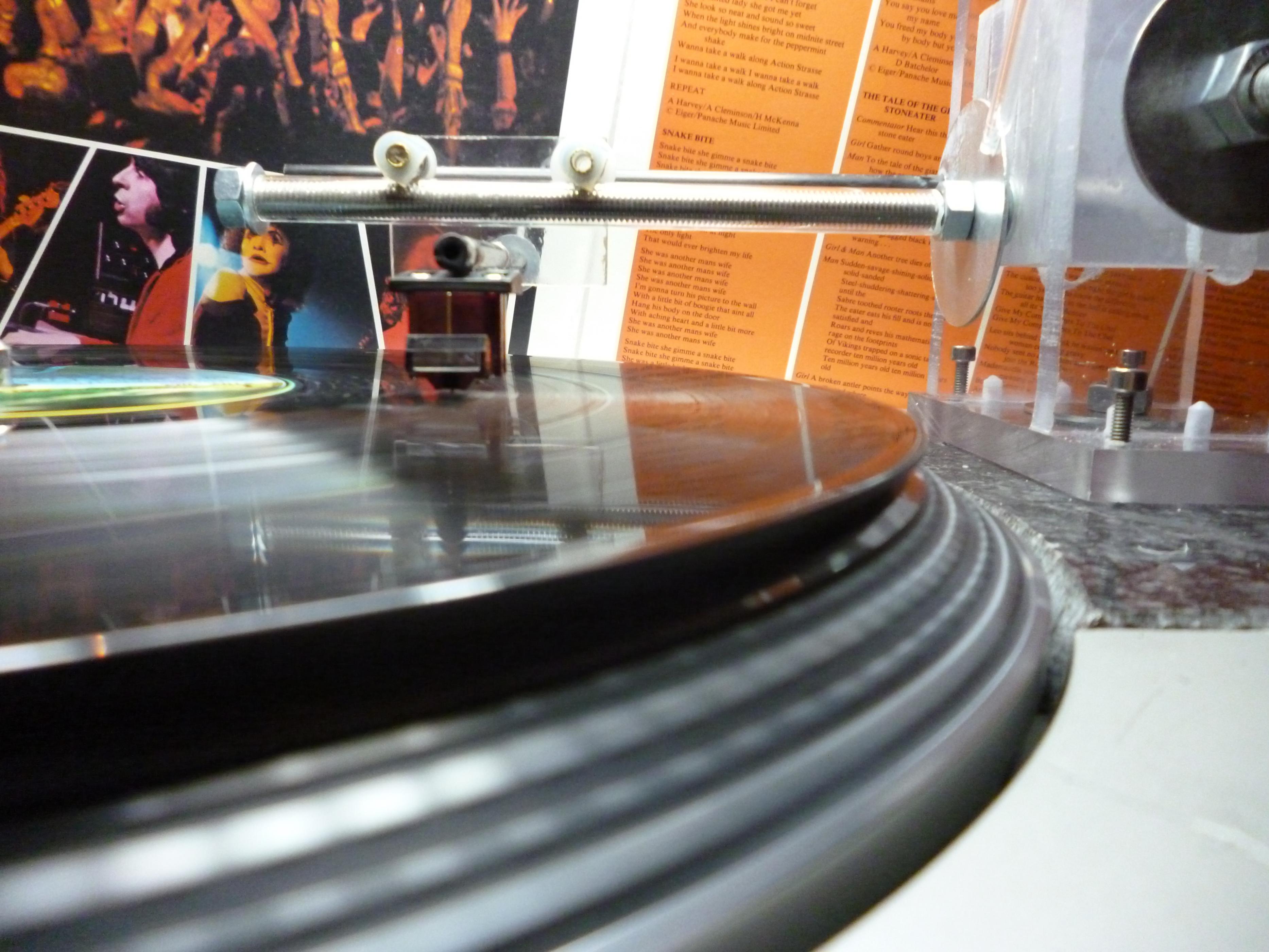

Photos please 😀
This is an old picture. It's currently disassembled.
I will change the wood dowel to aluminum in a week or so.
It consists of 3x10x4 bearings. using 3mm screws which have a long shank, blank brass standoffs as spacers with a transistor isolating tophat at the end,
3mm plexiglass. Riding on a 12mm glass tube held on a threaded bar with a few o rings and bolts. I will post a picture when finished.
My next attempt will use a Lenco collar with an old japanese arm riser.
Kffern

Kffern,
Glad to see your build, the dimensions as you have noticed are no accident. So much so for any future inquiries you can pm me for info on exacting details 🙂. This arm, turntable design and phono design based on the inverse of the Neumann sab74 cutting amp card is as close to the master as attainable I feel in analog audio, forget tubes, they are a P.I.T.A,besides only the oldest or modified amps are based on this.
Colin

Hi,Bob, I have not made any other changes to the rest of it except making sure the supporting metal rod does not touch the channel I had cut in the laminated perspex block carrying the arm. It is held to the block only by the bolts now. I have used fibre washers and I am going to castle cut the washers to minimise surface area contact.
My first set up is so ridiculously bad at transmitting vibration I figured it was best to leave it as it as it will be a hard test for any modification to the arm and carriage. The rubber washers on the metal rod is the onlt success I have yet had in reducing the thud when you tap the assembly, apart from putting the whole table in a bath of sand
The base is a granite block glued on to the bottom half of the turntable chassis. Its rubbish! My next plan is to change the base to either a multi material laminate structure. Or as BillG reports : to simply wood. This time the base will be held only by 3 points to the chassis. Or, I might have it independent.
Colin's idea of using things to absorb vibrational energy has made me wonder if the decoupling fixings etc should have springs on them where possible . I have tried rubber washers but it had no effect.
The only affordable ,small , accurate, level I have ever come across is the Fat Max Extreme Torpedo. I use that to get my levels but you can also level the arm to the table simply by measuring the distance from the platter to the bottom of the arm end/middle/start with some calipers. I get the arm height by eye, I set the counterweight, then adjust the arm height until I see the cartridge running level to the record. To set the carriage's track I scored a fine line in a bad , but flat, record; chock the platter ; then watch the needle track the score line . I set VTA by eye, the arm is held to the carriage by tight fit so its just a matter of twisting. I am going to try a cross line laser level to set up every thing at a later date . With my arm adjusting is very fiddly affair; the church is putting up for the ,position " Alan Saint of Patience ", but its worth the time. I get the feeling that the arm posted by Colin is the result of a lot of time trying 'things' and perhaps this is the set up to copy I did mine like that because I had no angle iron but loads of Perspex and glue. Sorry about the build quality but the whole thing is experimental. When I learn what works best I will try and make it prettier. Final shot also shows where there is loads of super fine enamel wire in every TV set chucked out in the rubbish
