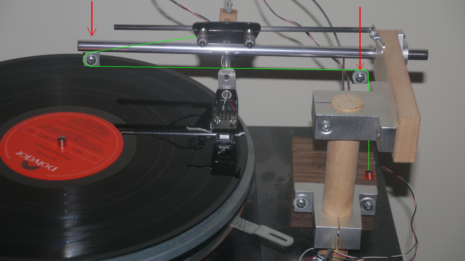

I fitted the new bearings and it still wouldnt track. Removed the moouse wire leads and it tracks fine. There is a problem with the new bearings though (as they are metal sealed) if I don't fit the spacers correctly (6mm brass standoff i use) it can bind the bearings.
Put the original bearings back on and it looks like it tracks well if I hold the wires directly over the carriage. No point in messsing about with a better cable stay as I will get new wire soon. It will have to be movable from the look of it.

Straight tracker, The tilting of the arm was a last resort. I normally have it straight. What was it, that it didn't do well? It occassionally stuck in a groove, but I now put it down to the wire.

The ony changes since this picture are the 12 mm glass rod and changed to 6mm spacers from 5 mm spacers(cut down 6mm brass unthreaded standoffs)
Again, I played a number of LPs with both configurations until I attempted the polishing.

Can you check out my idea, can you test it..
If you ad two small pulley with thread and some weight on the end just to help the head shell to track better.
I think is good idea if you mount the two pulley the right place and pick the right weight just to ad some help.

I see what you are trying to achieve, best ist to have a level tube and alight carriage. I went through many carriages before I settled on the last. You want to try and keep most of the weight at cartridge level as this helps immensely. The pulley idea assumes perfect vinyl, none of which.is and the pulley will cause huge issues tracking an off center record back towards the right hand plane.

My idea to add just enough weight to help the carriage, let say about half force or so..
These need to be tweaked in real life with the right weight.

Isnt this the same as tilting the arm inwards, letting gravity do the job.
This can't be good for the stylus or the LP.

Isn't this the same as tilting the arm inwards, letting gravity do the job. kffern
Bingo!
