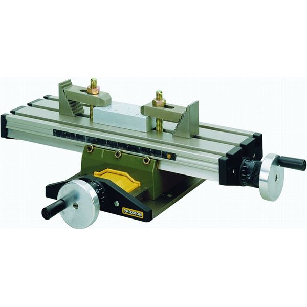

Why not just get an xyz platform? The work is done for you and you bolt the arm mount to the platform. I'm not talking about something that cost big bucks here, maybe about $250US or so. You will likely have micrometers for the movement (most that I have seen do) and you can adjust forward, backward, up, and down. Would work perfectly.
Or a :
PROXXON - KT 70 - MICRO COMPOUND TABLE
€ 80 brand new. ;)
