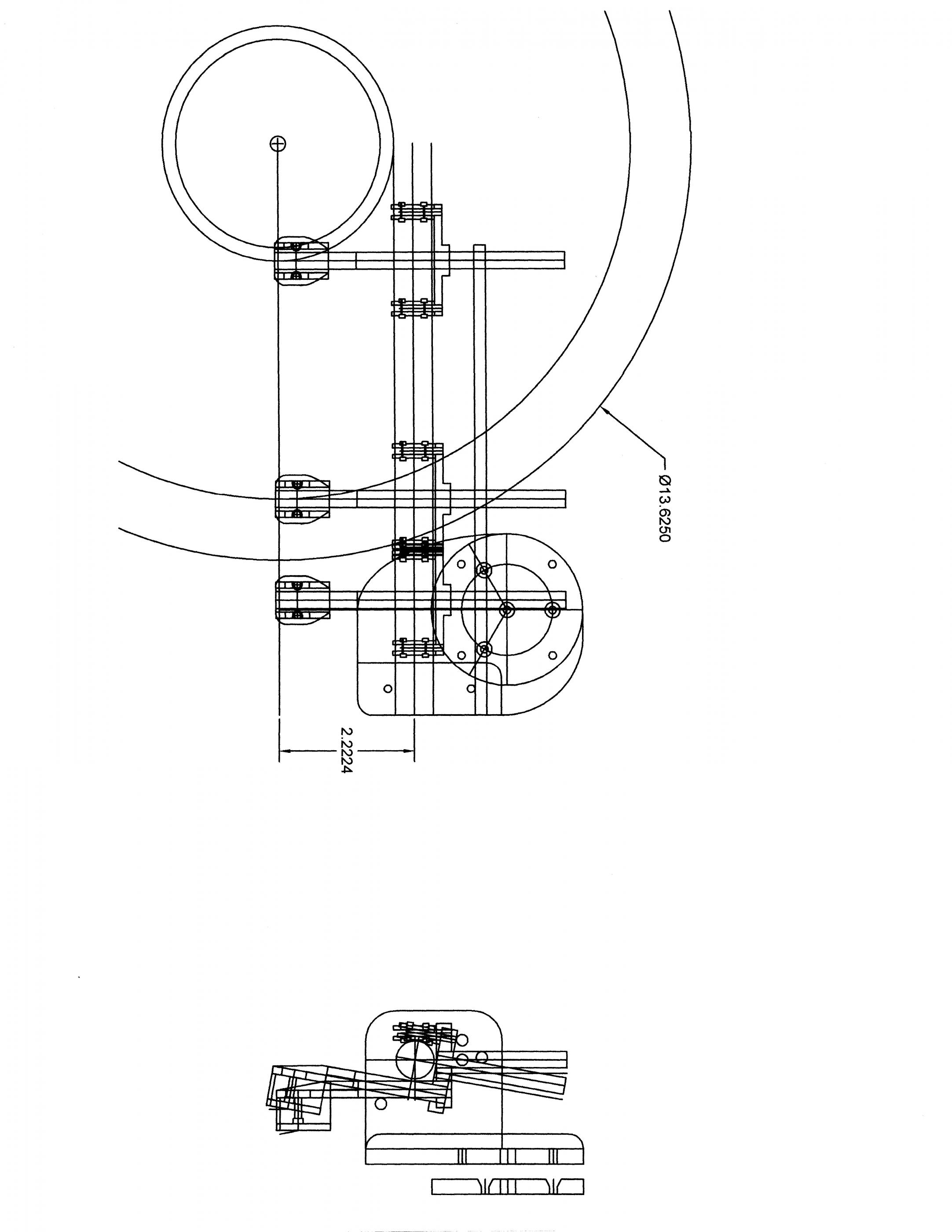

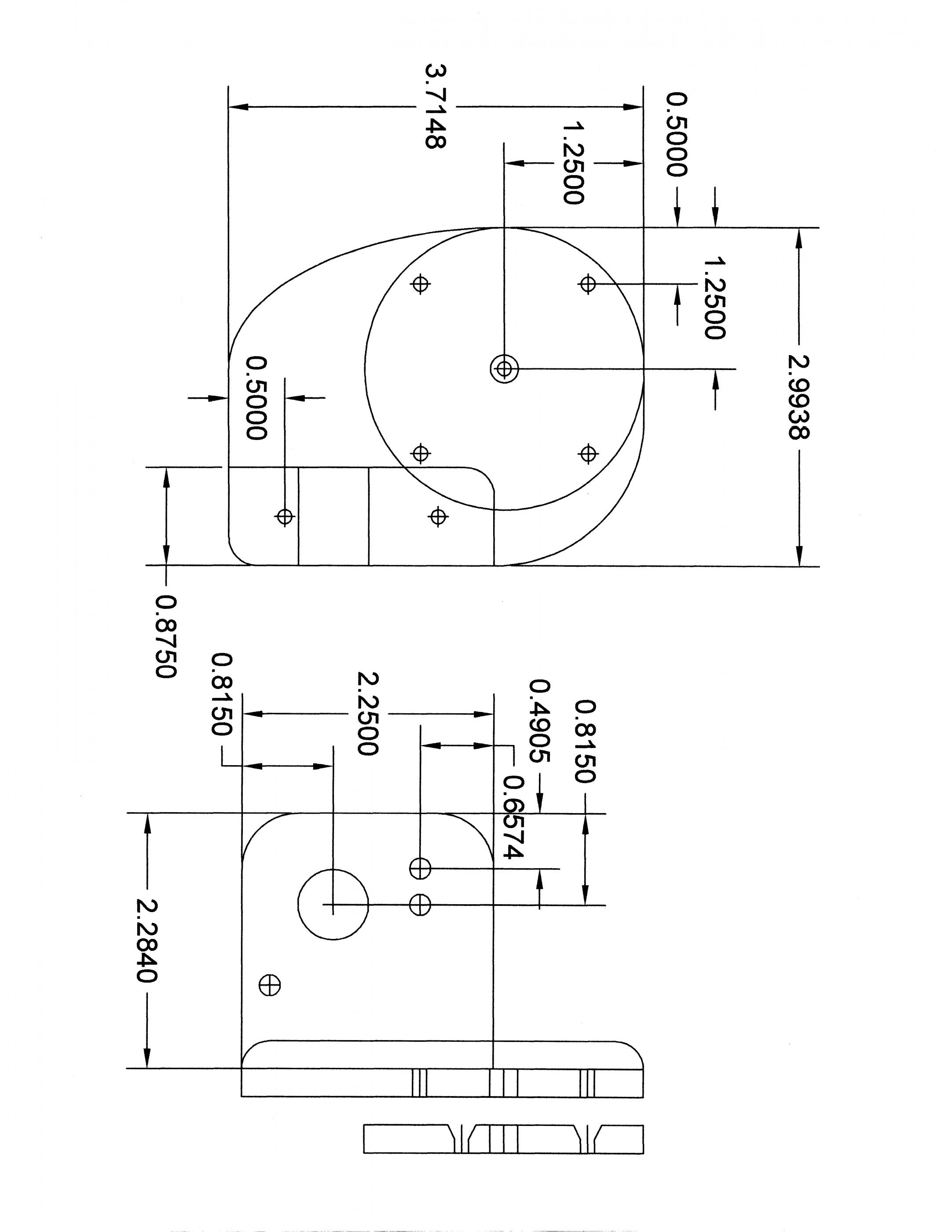

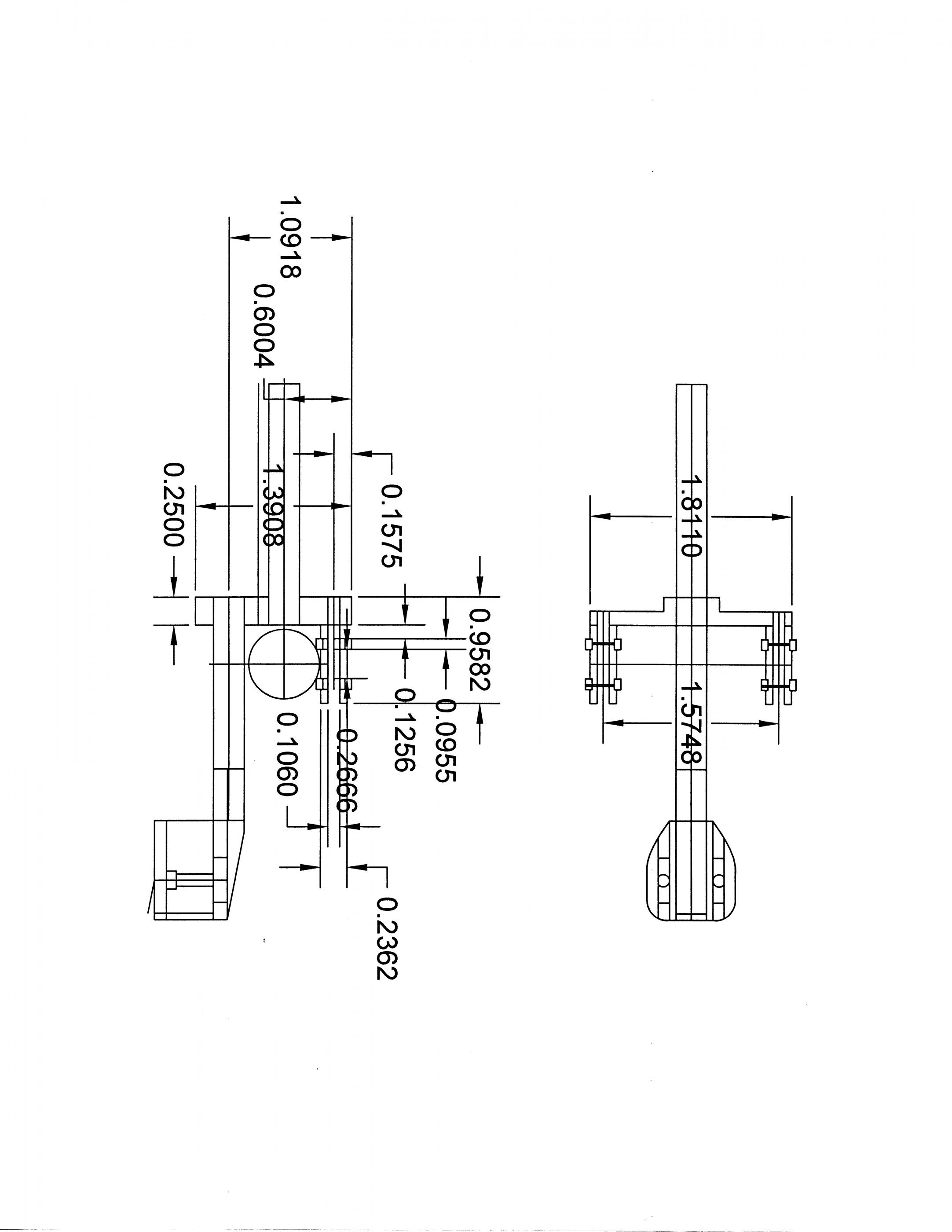

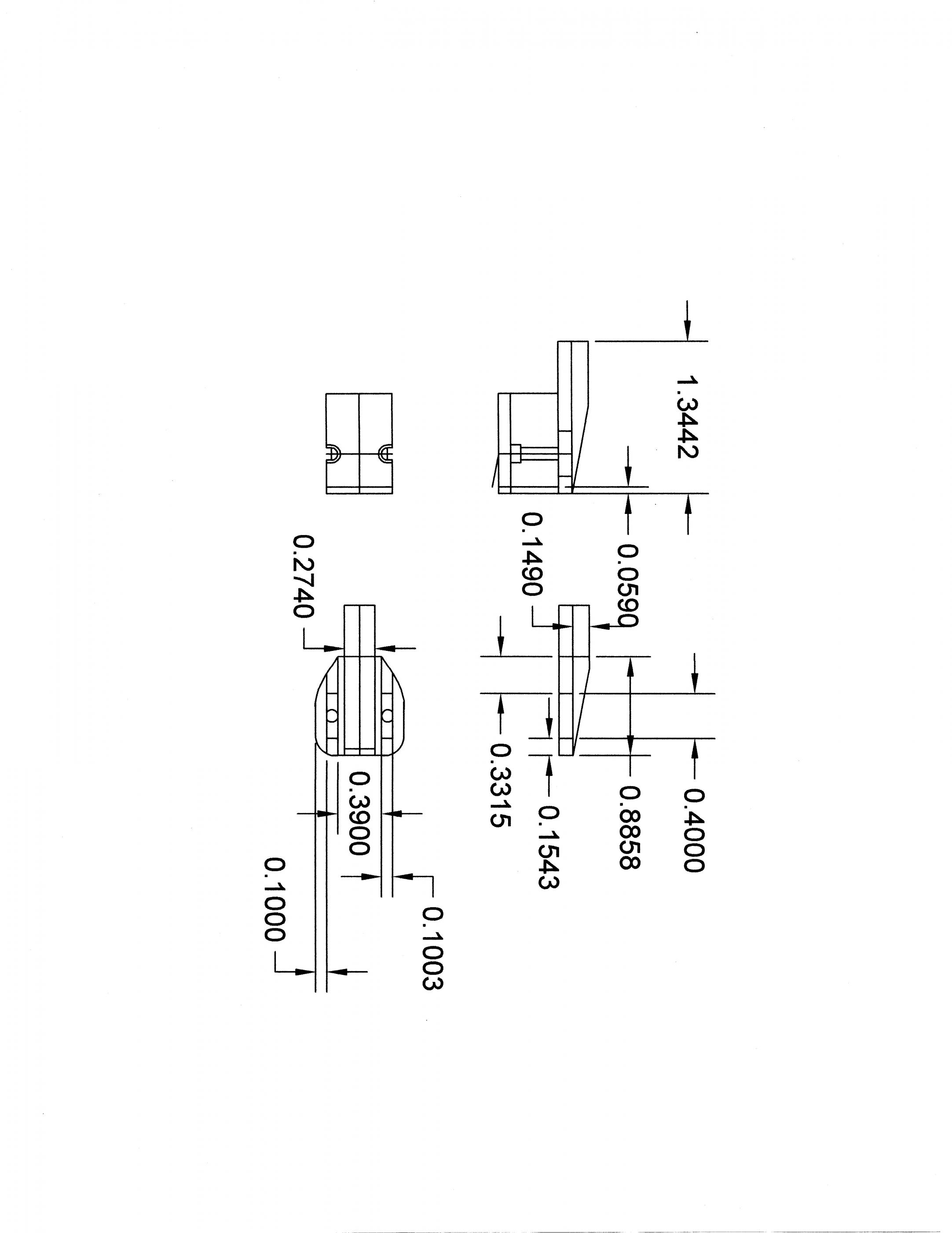

Drawing of My Arm
Attached are the drawing made for the construction of my arm. I can make pdf's if you need for scale. I also use a 16mm heavy walled glass rod for my design. If enough want it and you have a bit of patience I can redraw with the specified 10mm tube that most people have. Easy enough to estimate for yourself though.
This arm is working like a champ with a Denon 103r. about 2gm tracking force as best as I can estimate. VERY dynamic and solid soundstage. Very clear sounding with no smearing evident.
This arm has not worked well with my Lyra Keos though. Need to play with it some more to make sure I set it up correctly.

Your measurements are in inches right?
Yes. Unfortunately we still havn't figured out that metric is easier here. So my shop equipment is in inches meaning that I have to make the drawing in inches.
Lol... right you are. I try to do everything in metric when building. It makes things SOOO much easier and SAE is just so backwards compared to metric. I just keep my caliper handy.
