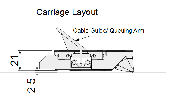

As I have eliminated the armtube in my design I don't have anywhere at the rear of my arm on which to press down. For my cueing device I have added an additional tube that doubles as a cable guide. The cueing mechanism is a cam that runs parallel to the rail. The cam has a 3mm rod glued to the inside of a 10mm tube. The outside of the tube is covered with heat-shrink to give a bit of grip to make cueing easier and safer and to damp the tube. The cueing mechanism can be adjusted by changing the angle that the cueing lever is attached to the 3mm rod.

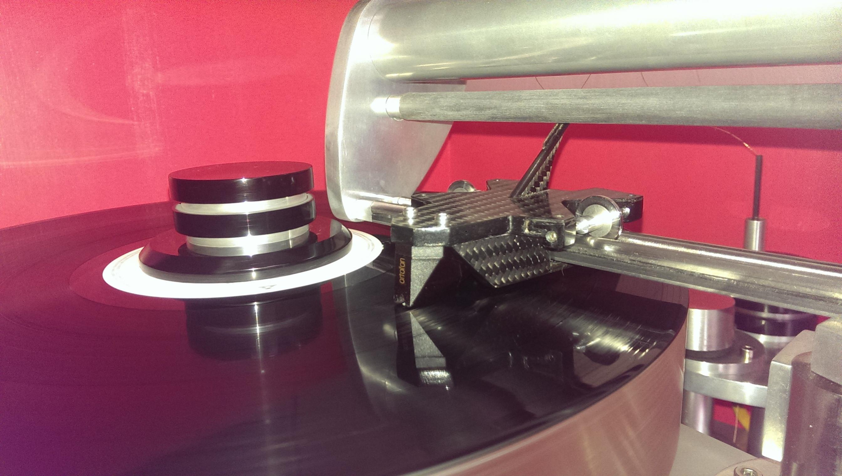

So Niffy, the whole tube is cam shaped? That looks like a beautifully simple solution and I think I could probably embody a variation of that. My protoype takes about two minutes to remove from the TT as I suspected it would be a work in progress.
That's a lovely bit of engineering there by the way!
Hi Apache100,
The tube is just a plain round tube, 10mmOD-8mmID. The 3mm axle is epoxy glued to the inside of this tube. The center of the tube will be 2.5mm from the center of the axle so it acts as a cam.
The amount the stylus is lifted from the groove is adjusted by changing the angle of the cam to the lever. The lever is super simple. It is a short piece of 8mm round bar that is internally threaded 3mm all the way through. It also has a 3mm hole drilled through sideways which takes the axle. Two 3mm bars, with the ends treaded, screw into the 8mm bar to lock it to the axle. A single 4mm bar acts as an end stop for both the raised and lowered positions.

The attachment doesn't work for me, but I get what you mean. It can naturally have an 'overcentre' lock so the carriage can't fall while you slide it back, which is an enormous relief because operating this thing by hand is terrifying!
