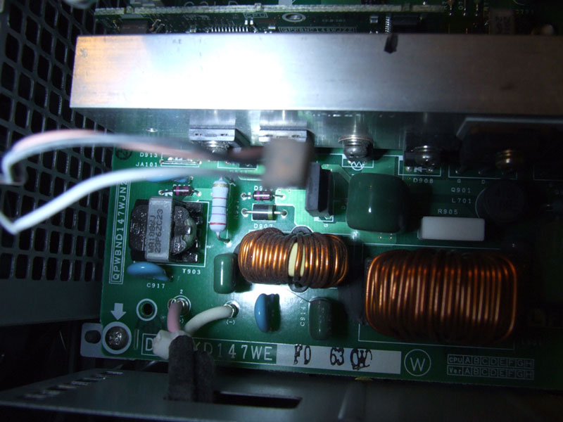

You can see the ballast part of PSU PCB on attached image. Converter uses two 2SK2699 MOSFET's, a single Schottky diode (probably 60V 10A - I'm unable to find exact datasheet) and two high voltage diodes FMV-G2G (6A 1700V) near output section. I can completely remove the board and investigate schematics if you wish, but it seems that this is an ordinary PWM DC-DC with push-pull output stage, сontrolled by a proprietary Sharp chip. I don't see on this board a sort of sealed high voltage ignition module like in my Toshiba RPTV and lamp wires are simply soldered to PCB (pink and white wires at the bottom) so may be ignition voltage for this lamp is not too high.

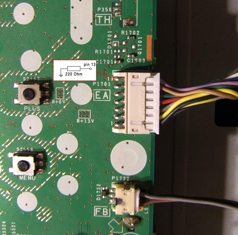

My VISA card quest is still in progress, so I try to entertain myself with reverse engeneering. 🙂 May be this info will be useful for others. If you need to disable ballast lamp check in Sharp DT100 projector, you will need a 220 Ohm resistor (or other one with similar resistance). You must solder it between pin 13 on "EA" connector (connects the mainboard to the power supply) and ground. I added a picture with this connector and mark the correct pin on it. It works perfect in my case, may be it will work on most Sharp projectors with the same chassis and case.

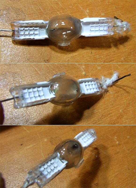

I continue to post various stuff about my experiments that perharps can be useful to others. I have tested various light sources in original reflector: two types of simple galogen bulbs and HQI burner with external ballast. Yes, spot size really matters for DLP optical systems! Optimal justified 12V 45w halogen bulb with small heating coil looks only half bright compared to 70W MH lamp with big 8-9 mm arc (although both are too dim for normal usage). MH lamp overdrive (~130W) helps, but not too much - the arc is mostly out of focus.
After that I try to connect now useless AC HQI burner to original DC ballast (yes, ywh says it's a bad idea, but I like experiments 😀 ) and watch how fast it fails. Ballast was in low power mode (probably ~200W - nominal is 270). One of the electrodes was melted by the big startup current very quickly (15-20 seconds) and I prefer to shut down the projector before the lamp explodes. I think that main problem with AC lamps on DC ballasts is not the the DC supply itself, but the huge startup current at the fast warming-up sequence on most PJ ballasts. Later I will try to use a sort of constant current mode on AC lamp with DC supply as experiment (and - may be - to destroy another burner 😀 ). Below are some photos of the melted burner.

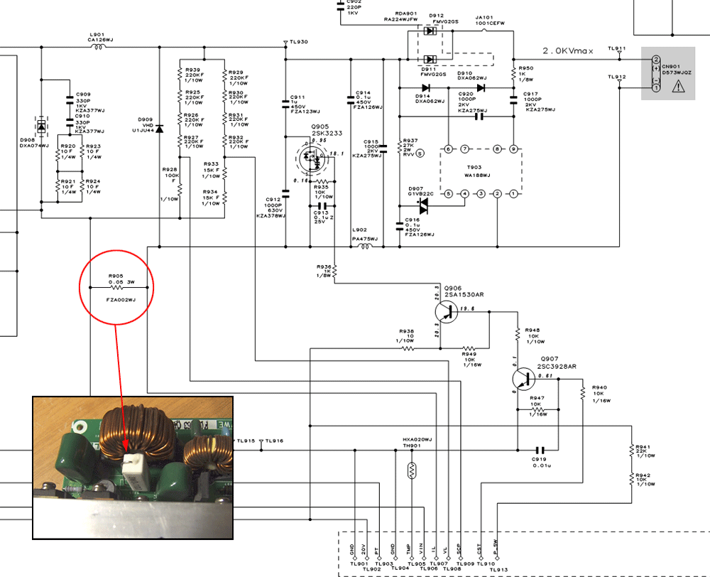

I have not too much time for experiments right now, but I can make a little update. Now I have a service manual for Sharp XR10S with complete schematics (pretty much the same unit, but with other DMD chip) and can make some useful research. You can adjust lamp current with R905 (see included picture); bigger value means lower power. Microcontroller uses two feedbacks for keeping lamp power constant: voltage (VL pin on daugtherboard connector) and current (IL pin). When lamp current increases, voltage drop on sensing resistor increases and microcontroller decreases PWM power supply target voltage. After increasing resistance from .05 Ohm to 0.1 Ohm I was able to connect 70W HQI bulb to projector and lamp works well about 1.5 hours without significant anode damage (I think that lamp works at ~100W-130W - I vorget to measure). Brightness is bad, for sure, but... (tadaaa!) ...AC lamp works from DC source! 🙂 More crazy engeneering stuff is on the way. %)

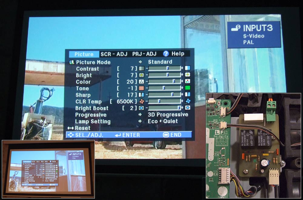

Another update. 🙂 I have made a simple soft-start block for ballast unit: 40 seconds delay at 70% current before lamp recieves normal power - this helps preventing anode melting. It uses current sense resistor relay switch, controlled by Lamp Lit and Eco Mode signals. This is not the best way to control the lamp startup power, but the other solution (with additional optocouplers and dynamic OPA feedback adjustment) is more complicated due to inconvenient construction of the PSU controller daughterboard. Now the lamp (70W nominal) starts with 100 watts and later (after 40 seconds delay) recieves either 140W (eco mode) or 175W (bright mode). At this time the lamp current already drops to 1-2 amps and extensive anode melting is unlikely.
Now I can say, that the dark room projector performance is at last acceptable in most cases. 🙂 The "ambient light" (two 60 watt incadescent bulbs) performance can be evaluated on attached photo (at the left bottom corner). The most interesting question (overdriven lamp life) remais unanswered for a while. %)
