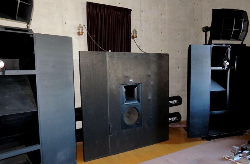

I want to build a two way DIY Klangfilm Eurodyn speakers. See attached photos.

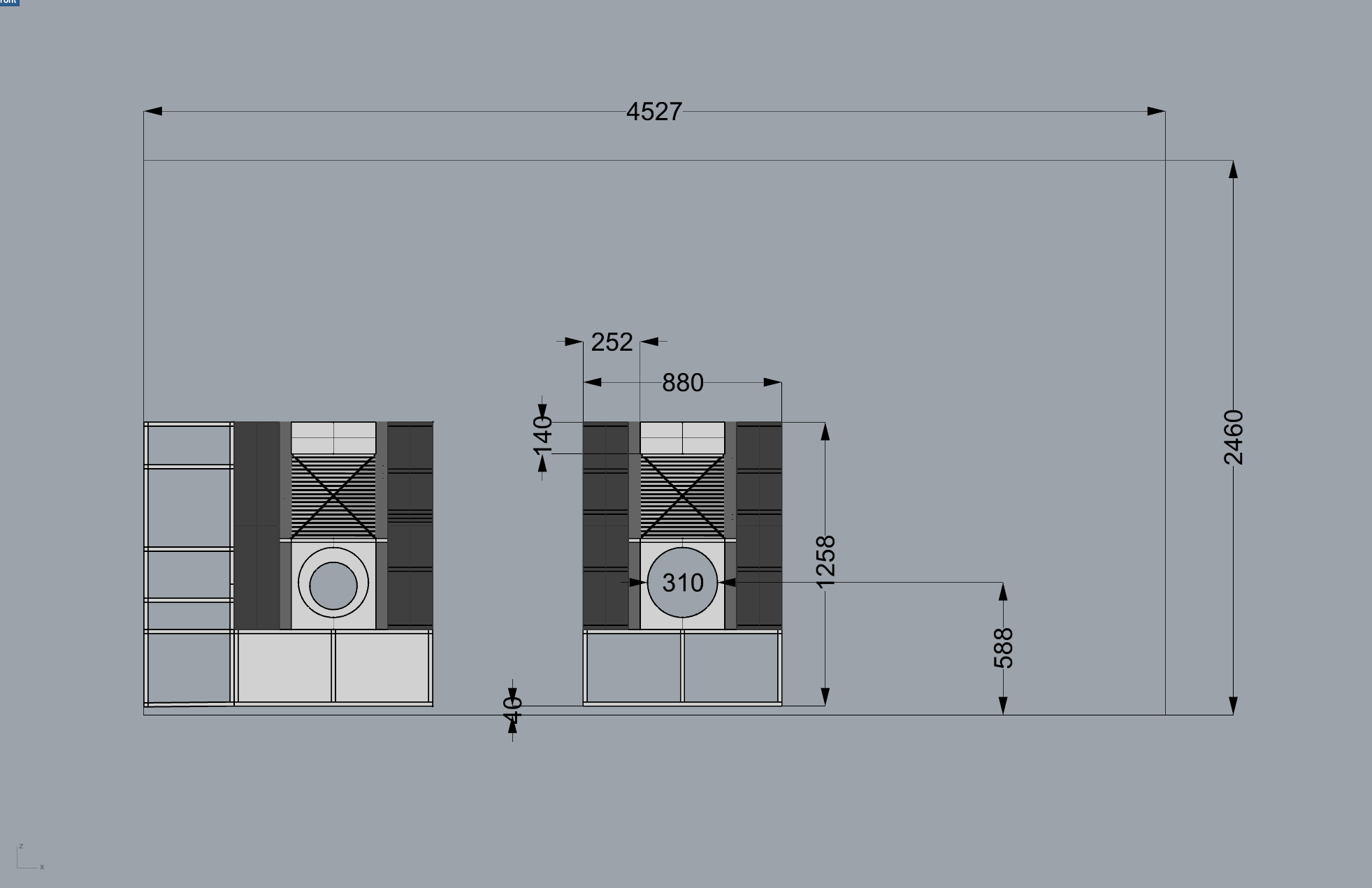

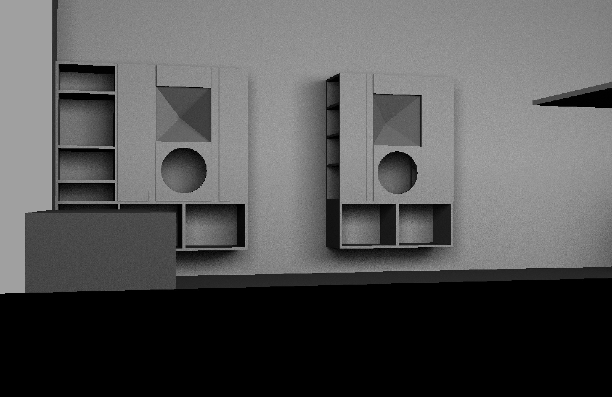

My plan ( with a lot of holes )
See attached renders and digital drawings.
I want a passive dividing network for this two-way setup.
I want the rear panel ,of the two single constructions , to get the lower frequencies to play - I have been told I will need a channel between the front panel ( placement of woofer ) to the rear panel + a opening in the rear panel + a distance from wall and rear panel to get this to work.

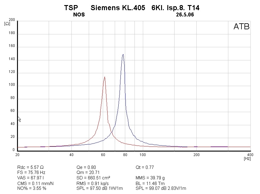

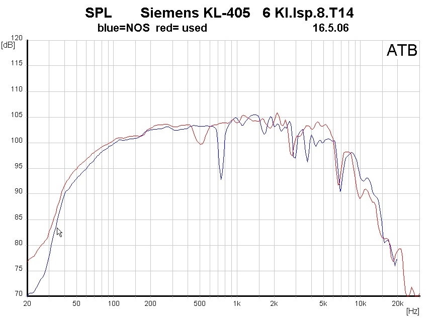

Regarding the KL405 ( the driver that started this Quest for me... ) : it is a really expensive driver . I`m quite sure that a new ( with a lower price tag ) driver in same size will be a better choice: for example: Audiophile-grade 15" Open Baffle Woofers
Perhaps. Q is a reasonable match for a baffle, although as GM notes, the 60Hz Fs is a bit high, so if you can get something with a lower resonant frequency & mass-corner that would probably be advantageous.
These are the only specs I found, so my question is; do you really want a driver that only plays down to ~60 Hz?
GM
GM, the curves you found are for Siemens Klangfim Kl.L 405, a large light weight fullrange speaker (baffle cutout 32 cm).
Picture: http://www.enjoyaudio.com/zbxe/files/attach/images/75/328/040/001/KL_L405_B.jpg
The woofer used in Eurodyn is a very heavy 15 inch type Kl.L 406 (baffle cut out 34 cm).
Picture here: http://www.soundup.ru/images/storie...gfilm-ki-l406-lautsprecher-38cm-15-inch-7.jpg
More pictures on Klangfilm home page of course. Among my files I found another impedance plot for 405, which is however
not the driver of choice for the topic "Klangfilm Eurodyn w. 15" woofer". This one confirms the red curve in your contribution.
Impedance peak is at 194 ohms, indicating a very high Q.
I suspect that the driver measured with the blue curve of post 3 has a problem, for instance dust in the gap.
