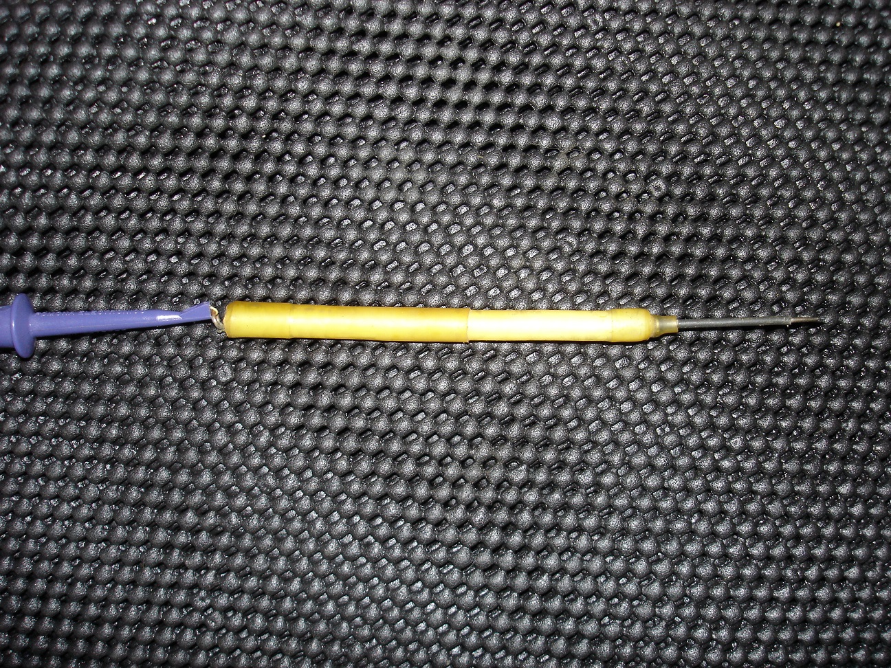

Pedro any advise on silicon wires /heatshrink? 'HobbyKing' is on my radar. they make no claims as to wire diameter. I asked their technical service about diameters of insulation etc and they gave me nothing, if its not on the schedule for website updates they don't move.
Probes are important! all my best are DIY.

Interesting probes. You basically made a diy version of these:
