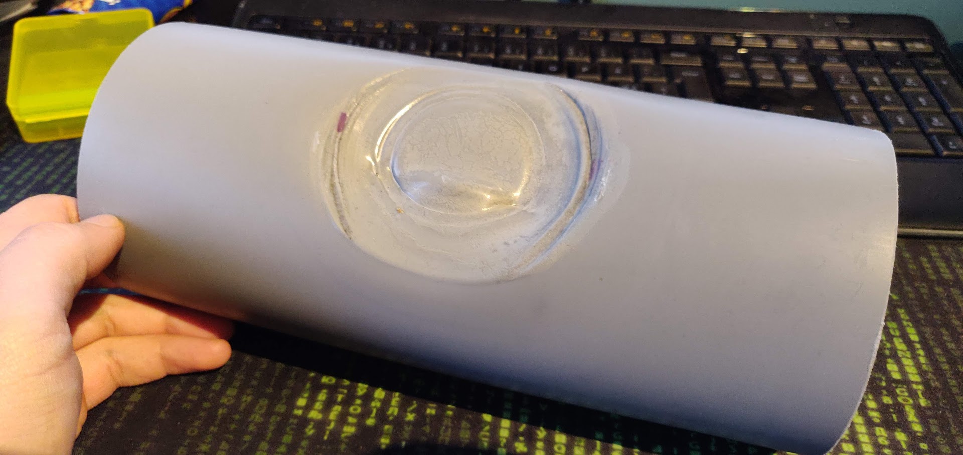

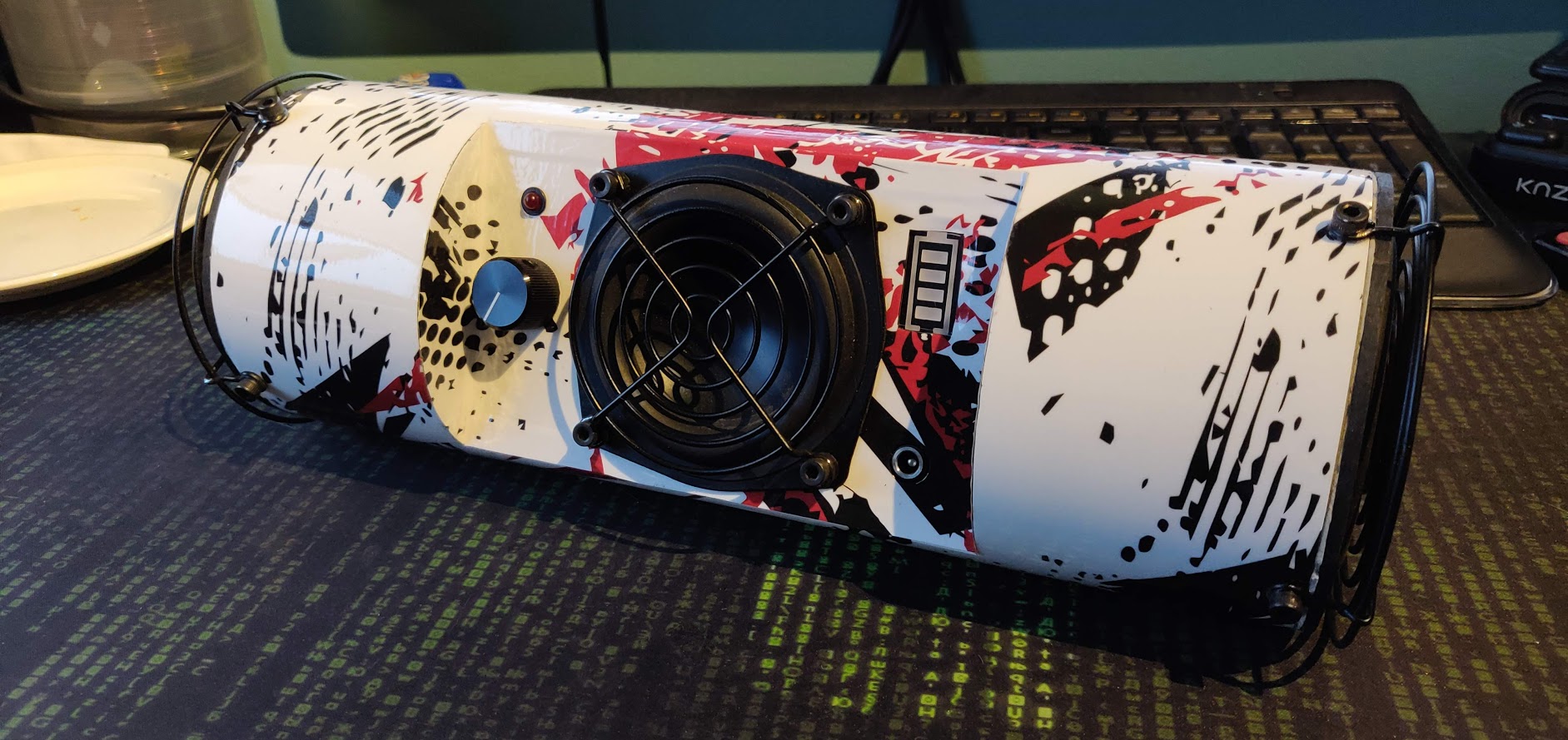

Sorry for more offtopic, but nice job on those pipes! That is a really tricky field of science, that heat moulding I mean. From the first attachment you can see my first and last try 😀
Decided to do it the old fashion way... cut a hole and insert a mounting plate. It ended up quite ok.
