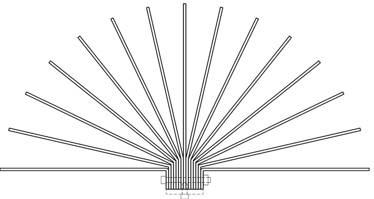

ok i needed a break...here's my grand vision. 75mm fins. 1mm thick. total width 150mm. the stuff at the 'spine' is for e.g. a transistor screwed in - you'd have to tap a hole to mount it of course.
i'm not going to draw one with a 'spine' piece, it's easy enough to imagine it.
Is this referring to the clamp bars that need to be under the bolt heads and nuts to compress the leaves evenly?
Variac said:No, the point is we don't want to deal with heat transfer between layers. The design is not fully scalable. The spine can only be as thick as the combined width of the staggered devices.
The edge of each sheet must contact the back of at least one device for this to work optimally. Of course it will probably work fine if you add a few layers and count on some heat transfer, but this isn't optimal.
There are solutions to that, at least for us amp builders. Remember there is nothing that dictates that all the transistors have to be on a line and on the same fins. That is unless you are building a 4 transistor version with 4 separate heatsink assemblies monoblocks. One TO3P transistor is about 20 mm, but if you place them in a way that each one have their own main fins (the fins they are directly in contact with).
BTW nice drawing Faustian! 😉 Exactly how I meant!
But you don't have to be limited to a half circle shape. By adjusting the length of each blade other shapes can be achieved, like a rectangle. That could probably be easiest done by cutting the pieces to size before assembly. That way you can put them closer together.

well, no i was talking about the possible welded on piece that was mentioned earlier, which would cover the exposed edges at the spine.
but yes, i thought of the compression bars after i drew it. those are necessary, i think.
yeah, i was thinking about that last night...briefly. then i got a headache. the problem is, that is just way more fiddly than simply making all the pieces the same length and bending them. even if you drew it up on CAD and dimensioned all the pieces, actually bending them and assembling them in just the right alignment seems really not fun to me. you're almost certain to wind up with some edges out of alignment, making the rectangle look uneven. having so many parallel lines accentuates any deviation from an even pattern.
but don't let that stop you from trying.

First a comment on the drawing. It would work, but there would be lots of imperfect metal/metal transitions the heat have to go through with this scheme. The best would be a combination. Almost as easy to build my idea, but no losses in bad contact points. There are some advantages with this other method too…. No need to machine a perfectly flat surface.
And the thinness of the sheets DO matter! Although my CPU cooler have 0.2 mm thick fins or so the temp difference is LARGE. When I put my finger down at the spline of the stack the temp is about the temp of the CPU, but the outer edges of the fins are barley above room temp. The fans have something to say here, and this was my reason for emphasing the use of copper. If you take a look at "normal" heatsinks the fins are not that thin. And you could test this by taking a piece of 1 mm alu plate and dip one end in hot water or something. You will discover that there is a quite large temp gradient. Then repeat this with different thiknesses. This is mostly due to the small thermal conductivity to surface area ratio. Large surface area is good (kept at a constant if decreasing thickness), but good thermal conduction (reduced when reducing thickness) is also wanted.
What someone interested in trying this should do is to calculate this ratio on some relevant comparison heatsinks. If you take a look at those figures for forced air cooling sinks and compare to convection sinks there is quite a difference.
The best thing here would be to build tests and figure out what thicknesses are best. Thinner fins mean more surface area, but lower thermal conductance, and therefore lower temps out at the edges of the fins where cooling is most efficient. I have no clue on what the best ratio is, but I would take a look at other fins and study those ratios. I have no way of telling what optimal thikness is, but knowing this would be a great advantage.

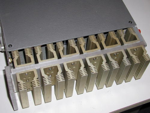

I tried to make heat sink ones too, but it was barely enough for one channel of Zen. The size is 330mm by 90mm. I used 1/2" aluminum base and attached smaller extrusions using screws and thermal grease. I bought the small sinks at $3/pc at local surplus place. It's just one alternative to building everything from scratch.
The problem of Peters design is the height of the heatsink. I am aware of the fact that a 150mm high box isnt everybody's cup of tea, but there is no way around the fact that if you want convection cooling, the efficiency of the heatsinks is multiplied with the square of the height if the heatsink. Its a simple matter of getting the convection to work as fast as possible. If a heatsink is made high enough, the speed of the ariflow will get close to what is for fan cooled heatsinks.
