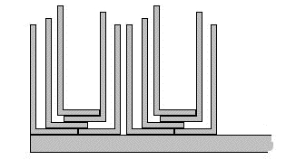

I've used a stacked approach with a 1/2" base plate and 4 levels of 1/8" sheeting separated by 1/2"x 1 1/2" x L aluminum blocks. Mine measures 7"h x 20"l x 4" thick and can dissipate obscene amounts of heat without a problem.

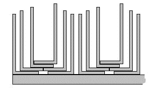

gl, Yes, there is something that just looks "correct" in your chassis and heatsink design. Do all the fins get equally hot?
Starting from you design you could quite double
the perf. with that design, still using the same squares...
Alain.
Alain.
Well, I have doubled the fins, and added some more joints, I will do some calculations about this
and come back with results.
Alain.
Alain.
