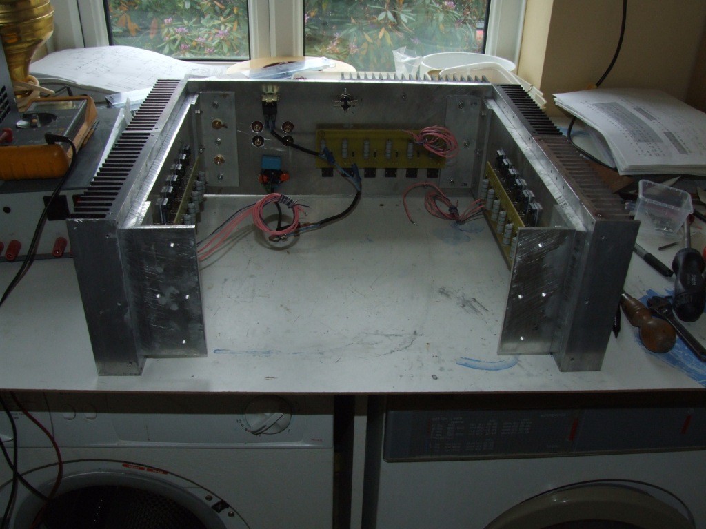

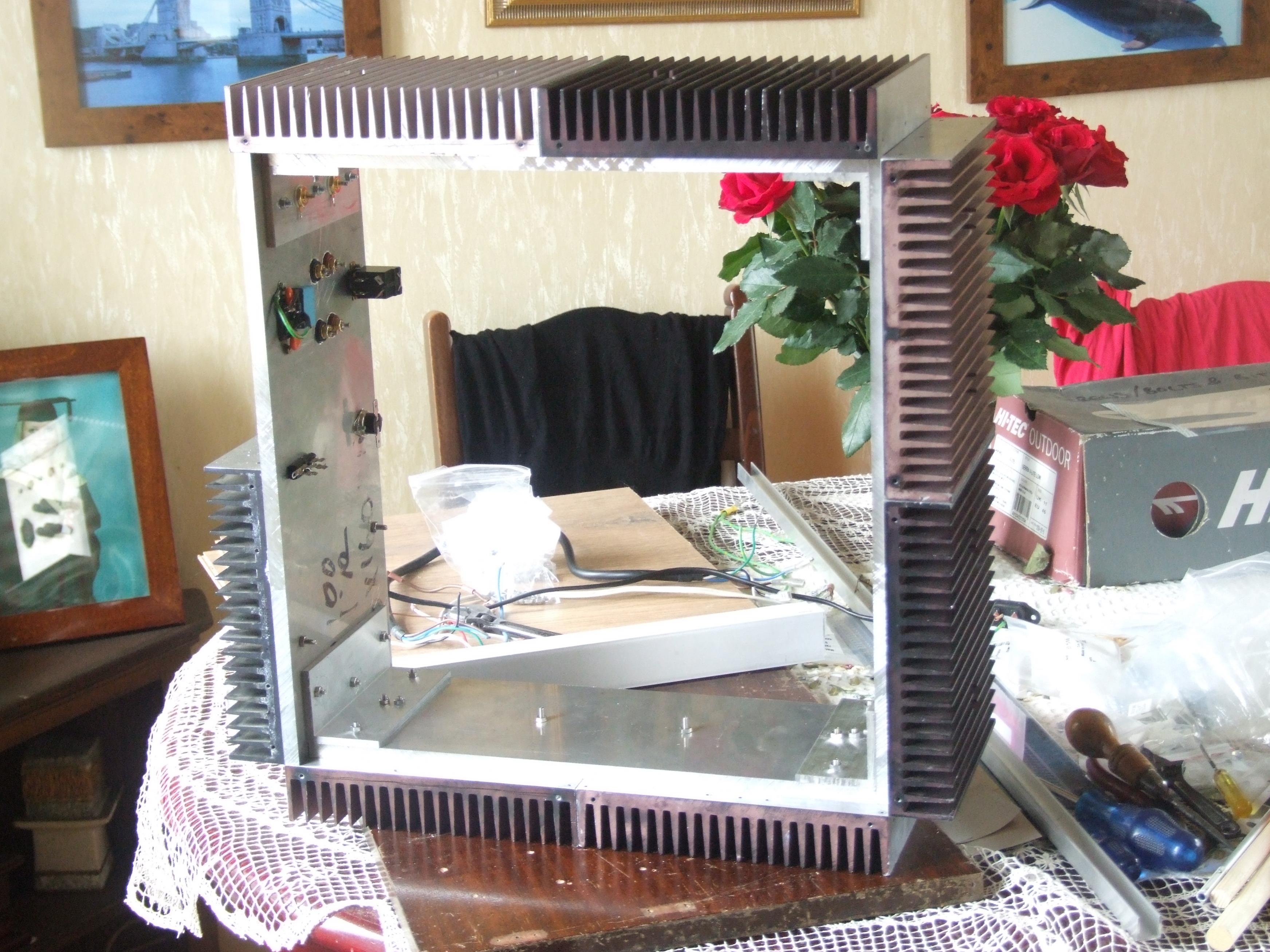

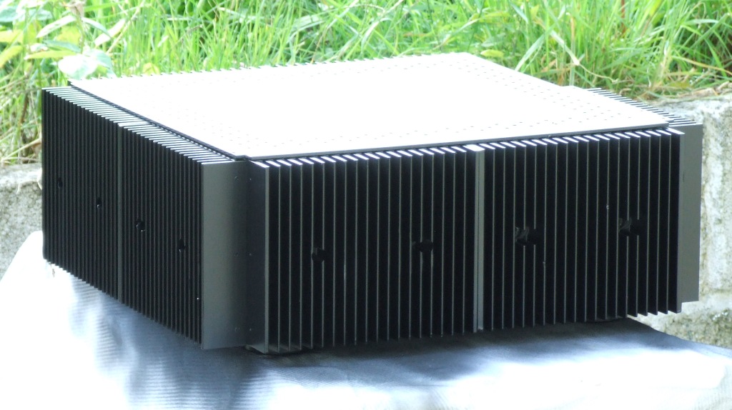

Here's the Aleph 4 that I inherited from my brother-in-law. Just goes to show how to get rid of a LOT of heat.
my amps have a perforated cover over it with 2mm holes, i think that that is the only reason i can get some heat in there.
the cover is a wrap around, only the bottom of the heatsinks is open and about 3cm above the floor.
