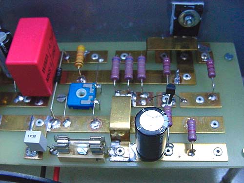

For some reason (fake pcb?) it reminds me of this Zen revisited project in the Passdiy gallery.

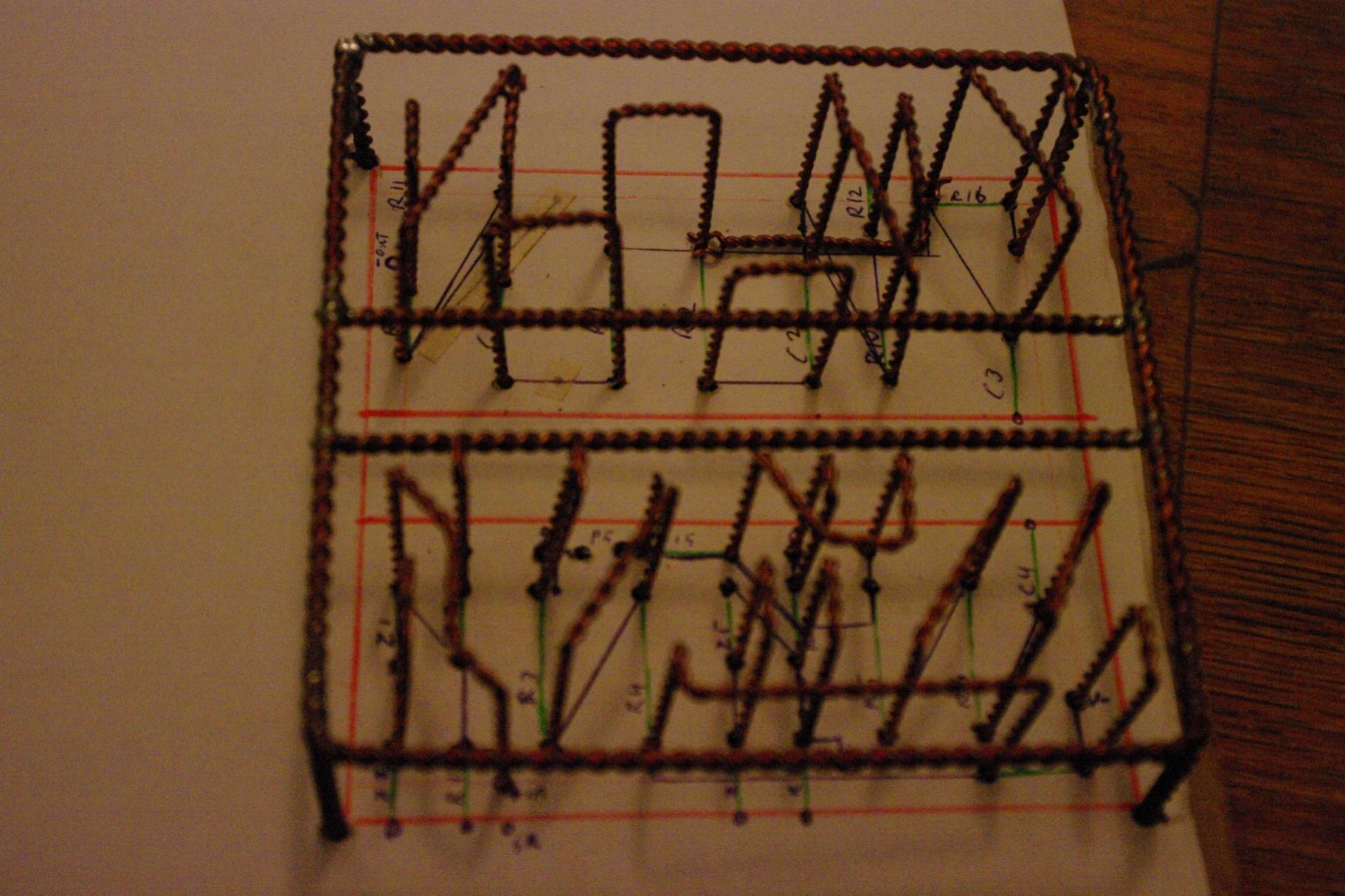

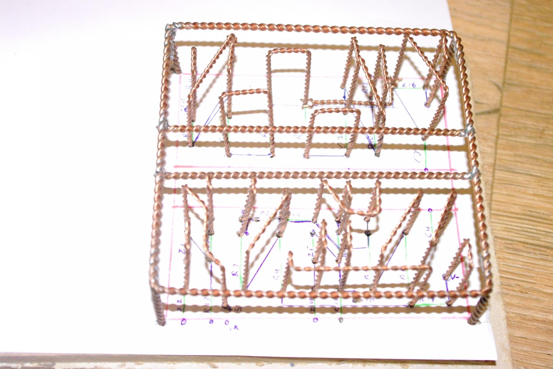

The plumber left behind a roll of 16AWG solid copper wire, so I thought I would try something point-to-point one day...
Interesting. Just remember that the tabs of the TO-220 need to be electrically isolated.
Or just keep them out of reach. Nichts gefingerpoken!
the plumber left a rol of copper wire, that is not something a plumper in holland would use, that is more the material of an electrician.
but stil, use it. point to point can be a work of art if done right.
what is in you picture is also beautiful, i wonder where the copper strip is coming from.

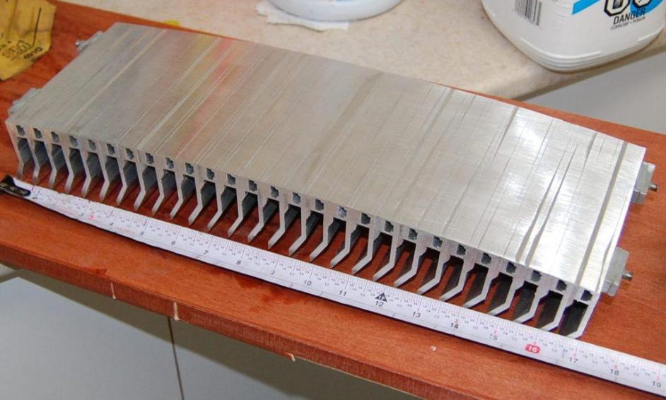

Soldered fin is better than thermal paste for the interfaces.to answer ANDREWT no, there is no thermal paste, all parts are soldered together.

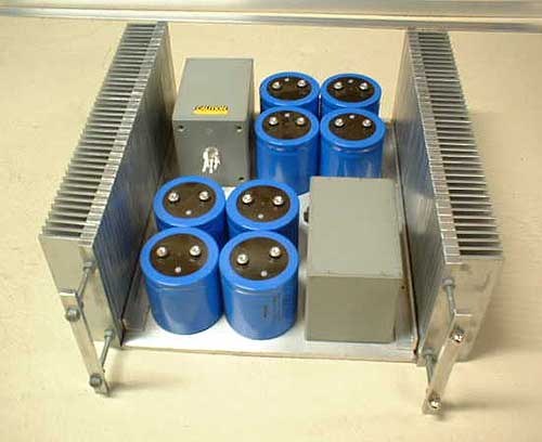

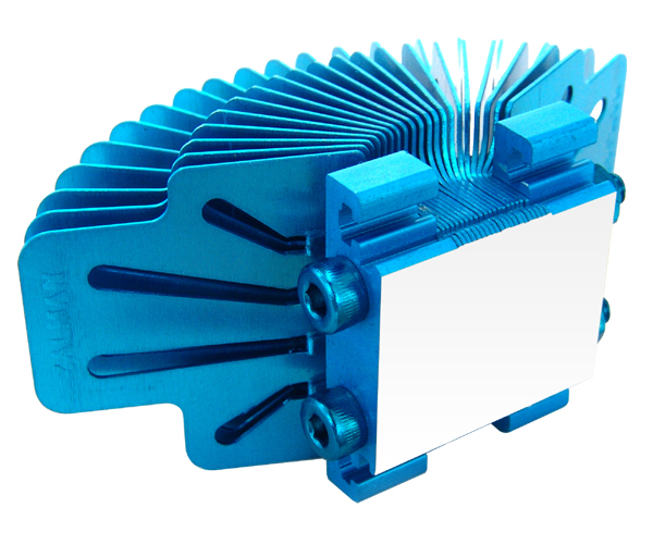

OK, so I read this entire thread and thought I would collect all the 'log cabin' style heat sink pics here:
norwegian???? could be right to, i don't understand either swedish or norwegian, sorry.
getting back to the diy heatsinks, i like the style of the blue ones in the last picture.
relatively easy to make to. make that out of copper and i think it will be a little monster.

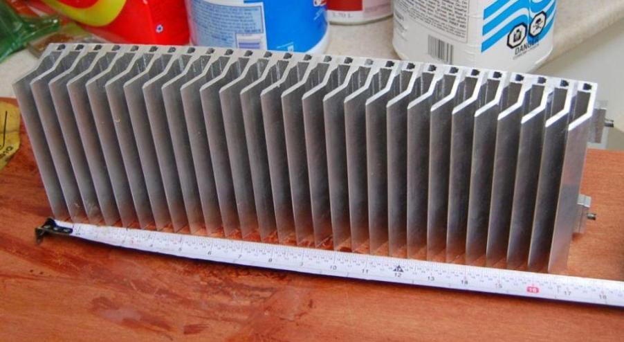

I think you misread that, jdg. Wider heat sinks are more efficient, at least for extrusions. For example if your profile is rated at .5C/W at 3" tall, a 6" section will be on the order of .3C/W not the .25C/W that you might expect. Of course if you can't get the width you need to get the required dissipation go taller.
Many of the DIY heat sinks have conductivity issues across their width because of the joints in their assembly. This may be why you see that the DIY sinks do better taller.
Overall efficiency also depends on the heat distribution. If a single source and not enough base thickness taller might be more efficient. With multiple sources spaced out, wider is more efficient.

This statement is generally considered to be incorrect 🙁 Taller than about 6" tends to loose effectiveness quickly. Longer is what you want. Try reading the data sheets from major heat sink mfgs. Fins mounted in the vertical direction up to about 150mm tall are the most effective. 200mm is a common maximum size and as tall as I have ever used. Some styles will dictate using 2 side by side which would be much more effective than 1 300-400mm tall heat sink. 😀...What I gained from reading it is that tall heatsinks are better heatsinks....
