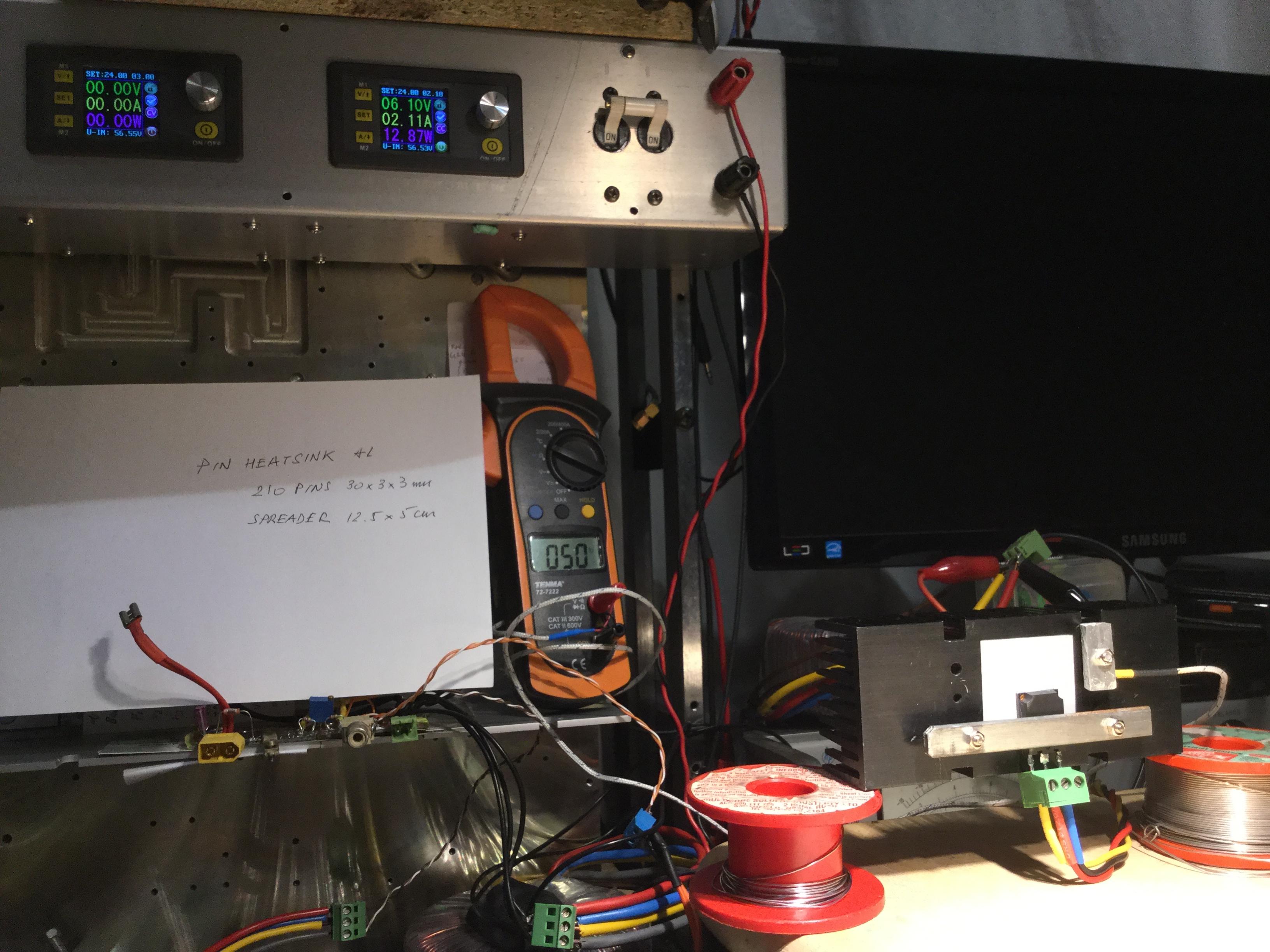

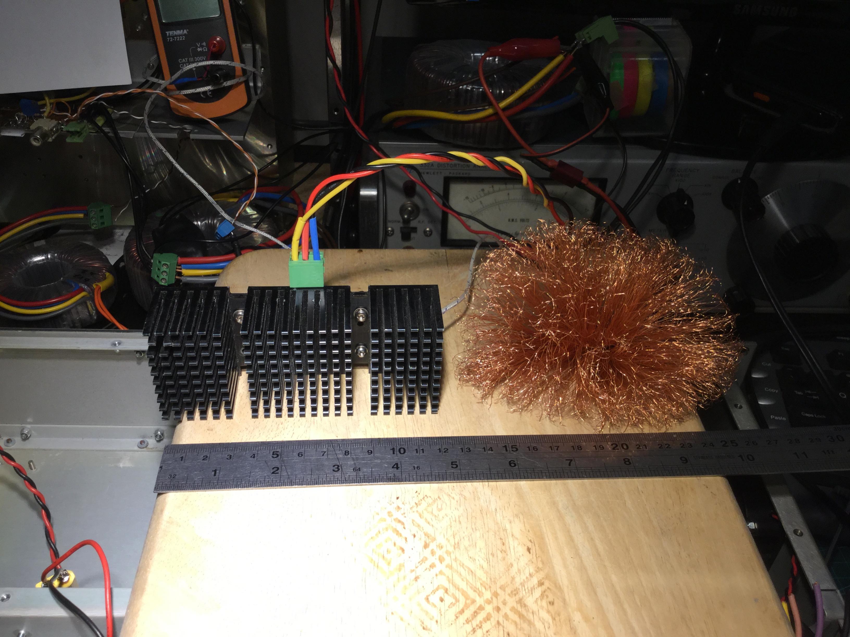

Blonde Hedgehog
My blonde has 7cm hair length.
It is quite extra long, textbook formula would shave her all up.
A comparison test with a near similar size heatsink (210 pins 30x3x3 mm on 125x50 aluminium substrate spreader) shown a respectable gain of her.

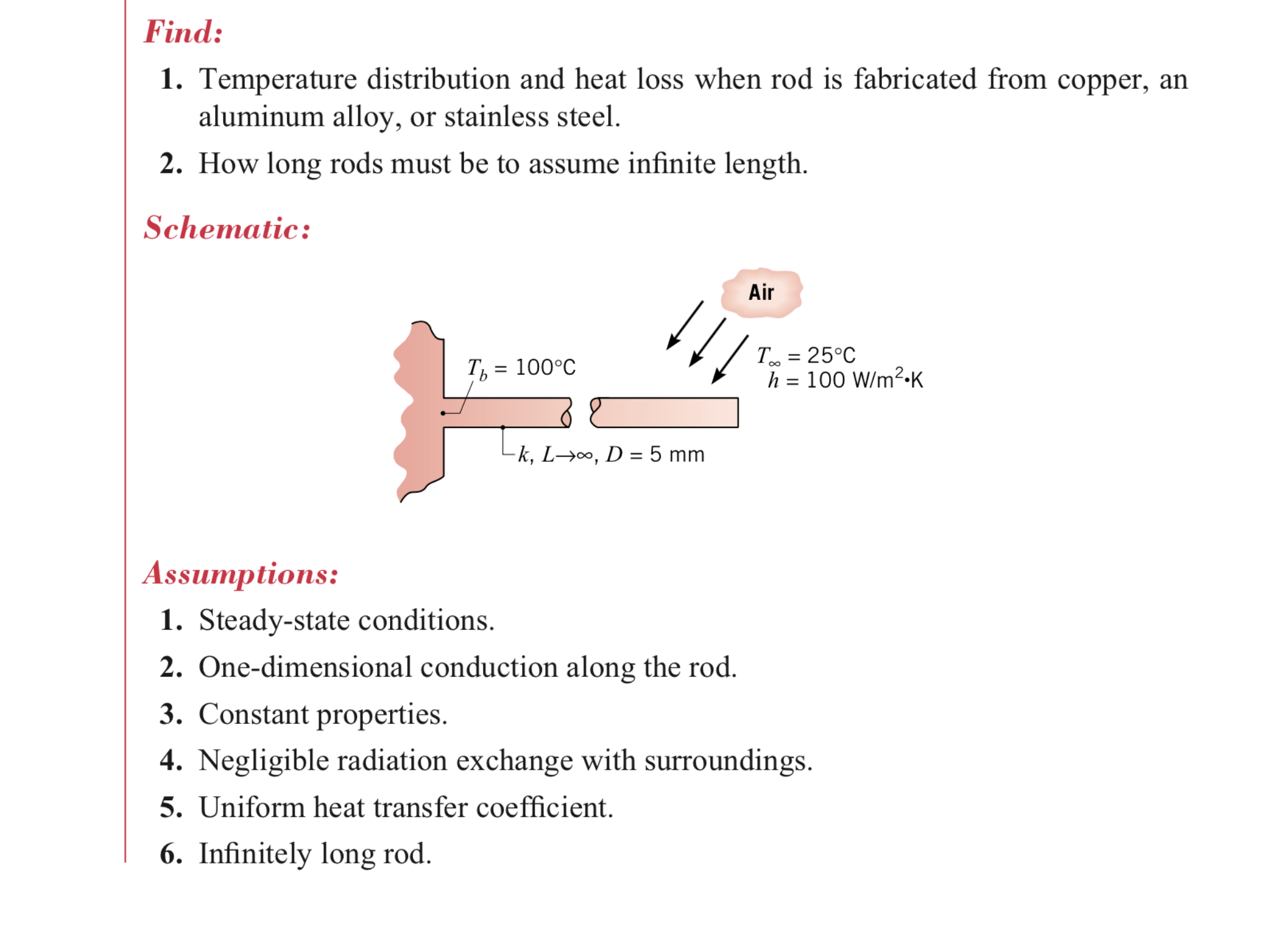

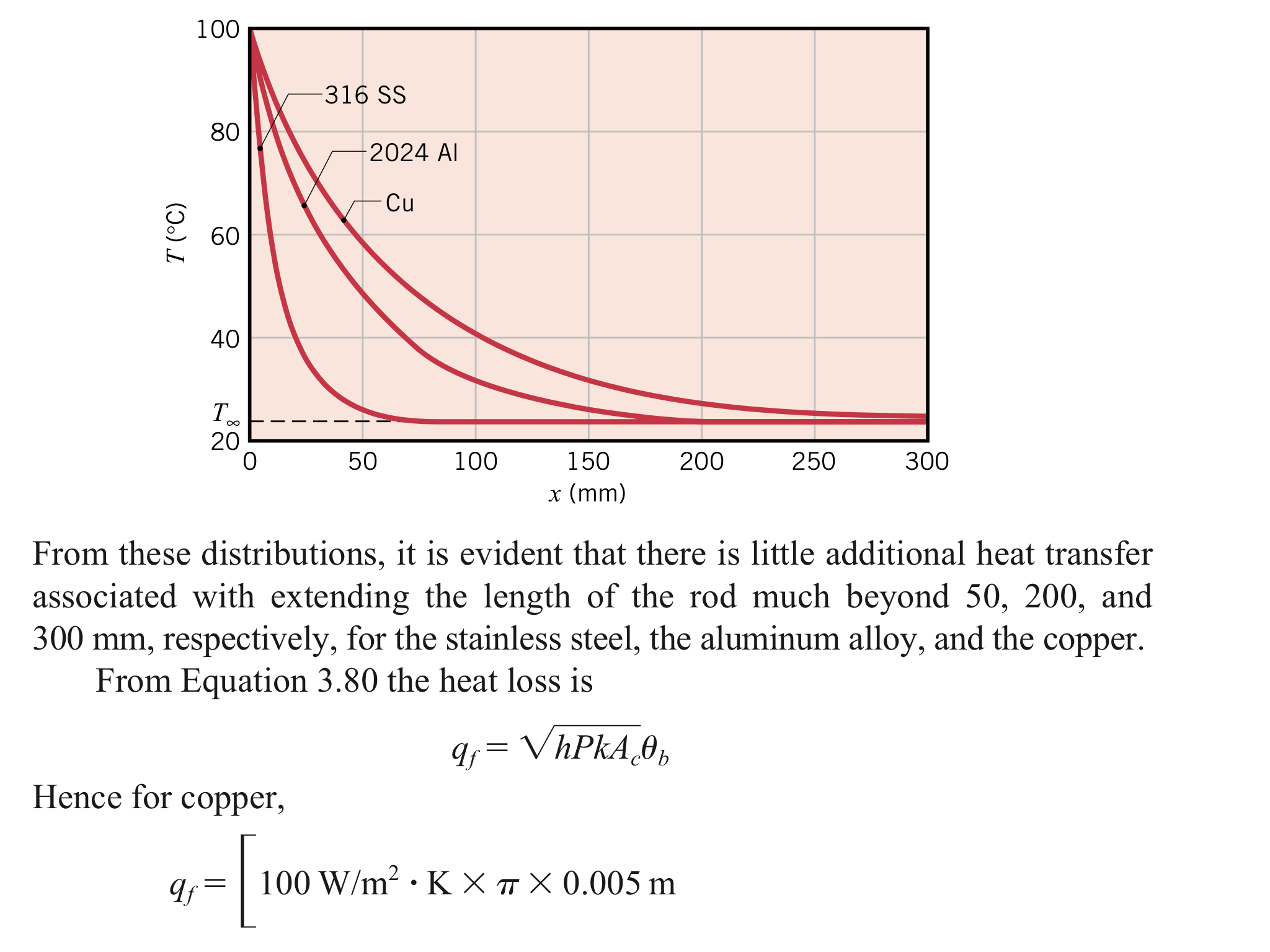

Resurrecting this old one; that is an excerpt from Fundamentals of Heat and Mass Transfer, Incropera, Dewitt right? It brought back my memories from the Undergrad times 🙂

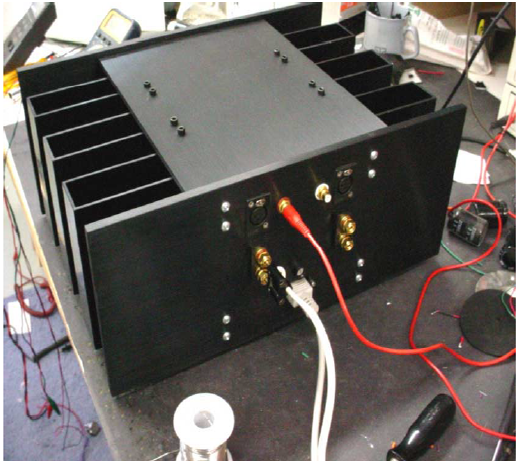

Hi All,
First Post here. Just collecting bits for an LM3886T Amp. I intend trying a 1/2" X 3" X 10 " chunk of plain aluminium bolted to a 1/8 thick aluminium chassis. It will be insulated by a single layer of Kapton tape and insulated washers and tubes or o rings for the bolts .
I know fins increase the surface area but the chassis should have plenty of that. Only question for me is the heat transfer through the kapton tape but I think the sheer size should do the trick anyway. at least the uninsulated chip should well coupled to the heat sink.
If it gets too hot I will bolt a few fins to it, or another chunk of Ally. I could get fancy and cut slots or drill vertical holes but more bulk will be easier IMO. I quite like the idea of vertical holes acting as chimneys as well as increasing surface area, but find drilling holes 'Boring'.
It will be running on about +_ 20v DC into 4 ohms
Will let you know how it goes. Has anyone else tried such a crude approach?

1)use grease between chipamp and solid bar and between bar and chassis.LM3886T Amp. I intend trying a 1/2" X 3" X 10 " chunk of plain aluminium bolted to a 1/8 thick aluminium chassis. It will be insulated by a single layer of Kapton tape and insulated washers and tubes or o rings for the bolts . ....... Has anyone else tried such a crude approach?
2)Fender does, in 100W Guitar amps.
4 TO247 power transistors mounted on a 30mm wide by 12mm thick by 200mm long solid aluminum bar, which is boltd to 1/16" thick aluminum chassis.
They are successfully dissipating way more power than you.
