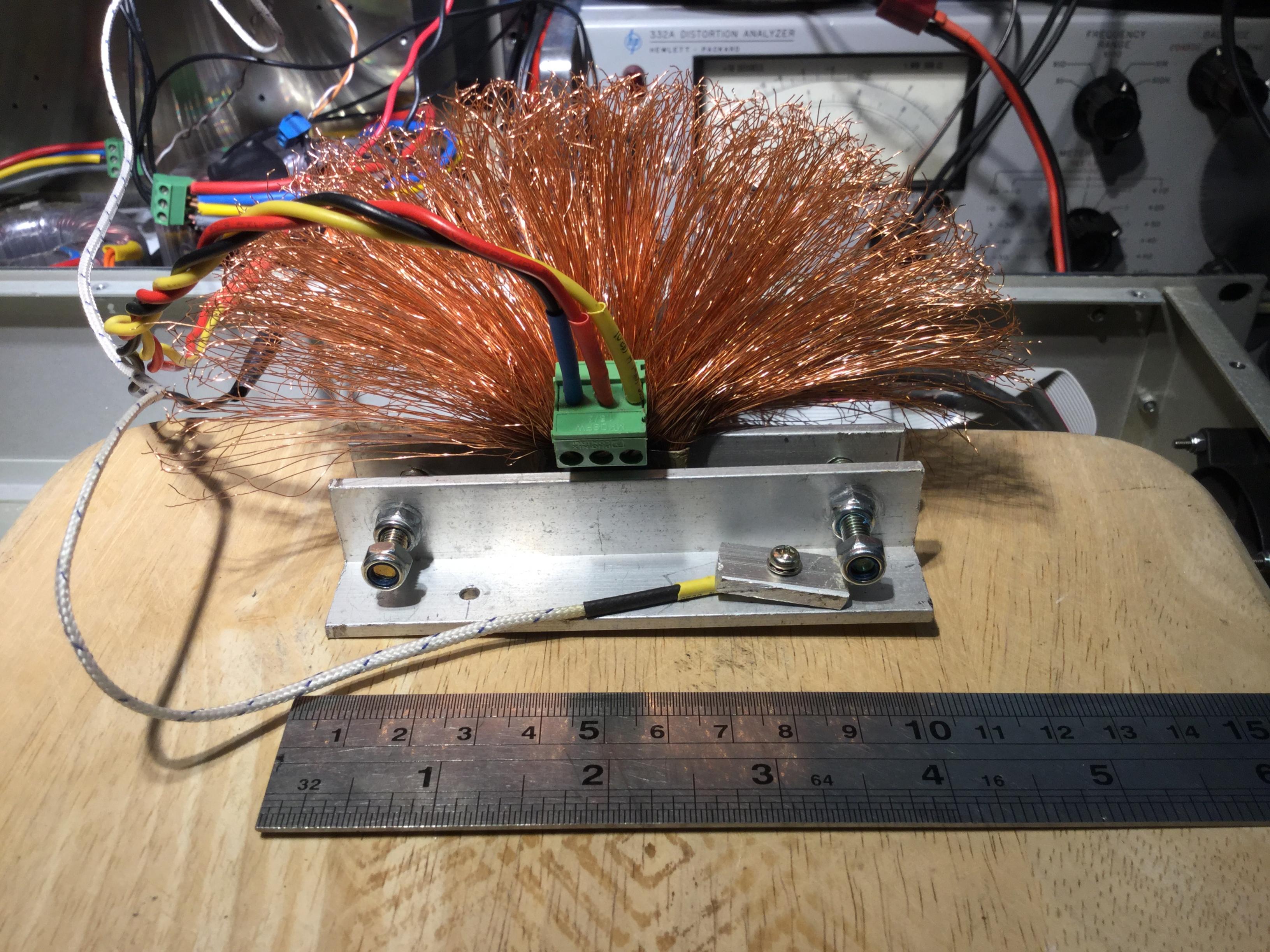

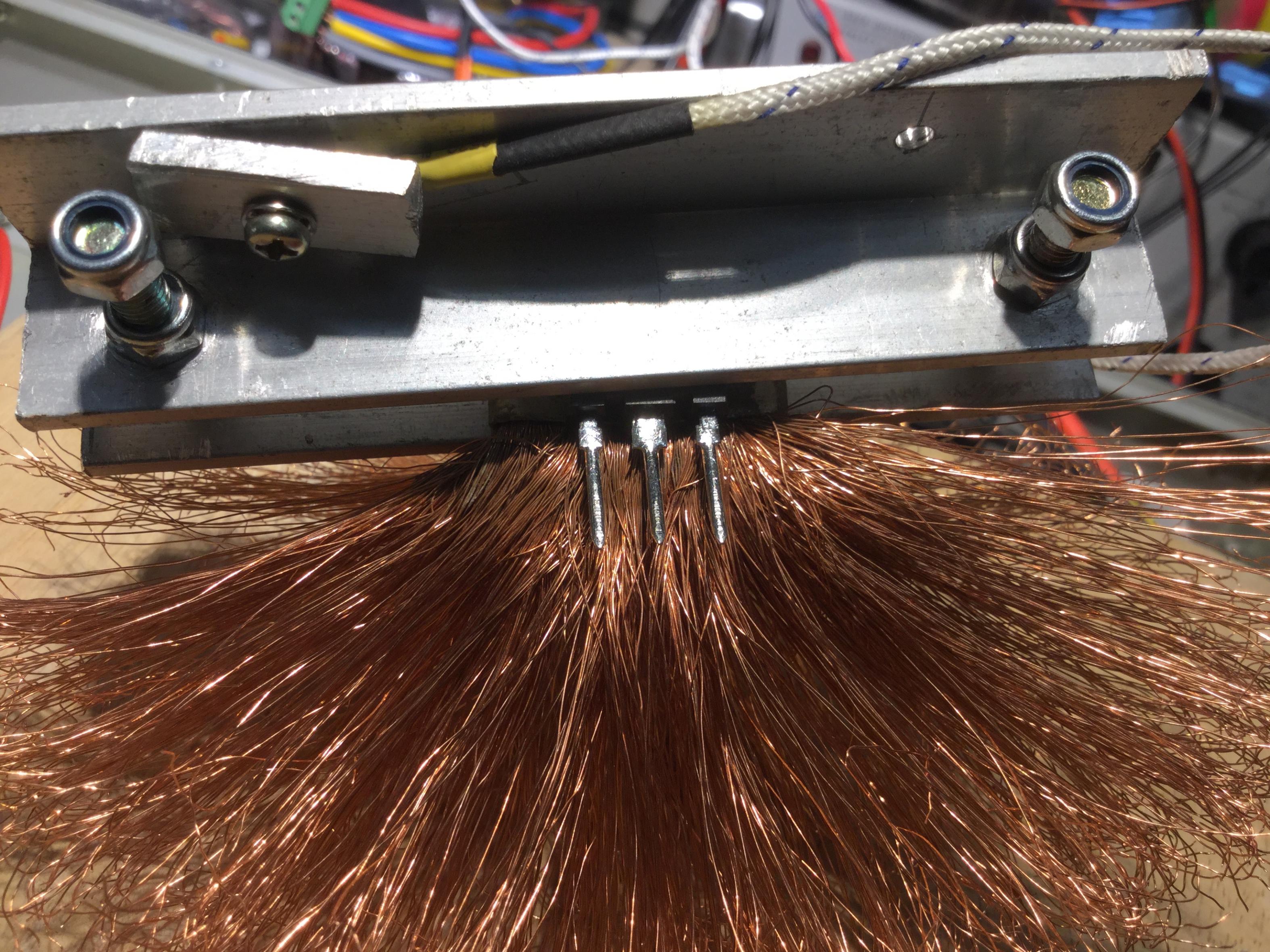

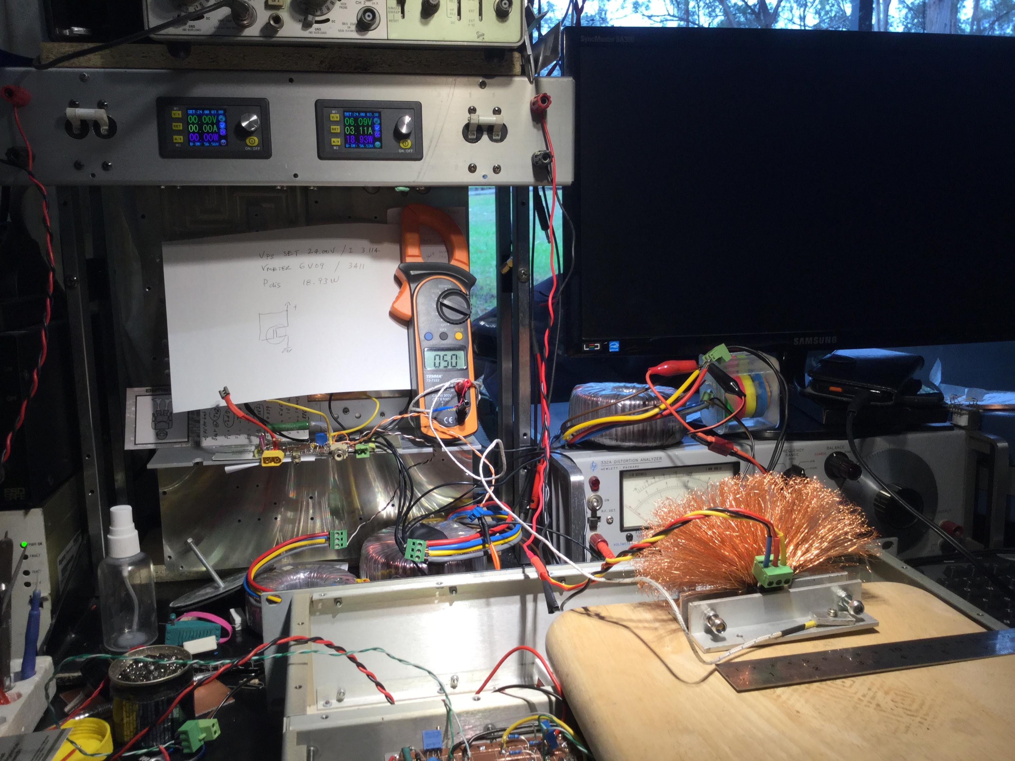

Hi Brian,
Thanks for sharing, your copper bar is in my wishlist, hihi
I’ve got my test done
Ambiance = 28 C
Aluminium clamp to MOSFET case = 50 C (stabilised)
Power dissipation to device = 19W
Heatsink
Copper multistrand monster cable
Length = 10cm
Size = 250 AWG
Strand = 575
I am too dump in math to get the dissipation surface
But can measure the air exchange area
14 x 10 x5 in cm
Pretty amazing
Pascal
