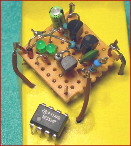

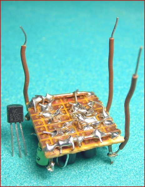

Discrete Regulator - 3 small transistors
I have such a circuit!
Actually I have one working. set for 5.00 Volt output
More information on FEATURES of my regulator circuit:
Microphone Amplifier 9 Volt Battery Discrete Regulator
See attached picture of my little great regulator!
As most voltage regulators chips it has 3 pins: in, out, gnd
For size compare I have used an Audio Op-Amp IC in my image
Regards
lineup
Lineup Audio Circuits 😎
