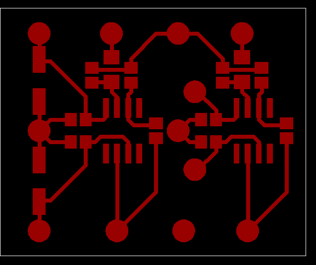

theAnonymous1 said:I finished drawing up the board for the OPA551. I have to connect two nets with jumper wire, but I think it came out pretty good considering it's single sided with the components so close together. Size is approximately 25mm x 25mm.
Looks pretty nice. I think if you futz with it a lot you can eliminate those jumpers, but it is probably not worth the time. Jumpers should be fine.
As for the 45 degree thing, this only really matters for super high frequencies. You should be fine here.

Be forwarned that this chip is a beast to work with. Without a lot of attention to a lot of details (decoupling, ferrites on the output, caps in the feedback loop, etc.), it will oscillate and destroy itself, and perhaps your headphones. Even when not oscillating, it is prone to a lot of offset. Look at Headwize for discussions of the Mini3 and the Pint, and good luck. People do seem to like it when they get it to function. I still think the LM6172 sounds a little better, but a lot of people disagree. Oh, and the NJR4556 is another high current opamp to try. It is used in the Grado RA-1, and only costs like $0.50 so is worth the experiment. All of these are prone to oscillation and offset, but the SAD8397 is the worst of the bunch.
dsavitsk said:As for the 45 degree thing, this only really matters for super high frequencies. You should be fine here.
A layout that works well at high frequencies will also work well at low frequencies, but not vice versa.

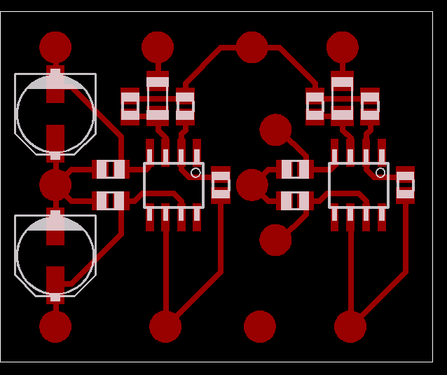

Here is a pic with the silk layer so you can better see what everything is......

Anonymous1, I whipped up a quick schematic in Eagle and routed a board as well. There is no easy way to do a one sided layout without jumpers when two separate chips share supply rails. I liked your idea of a solid ground plane on the back and ran with that. For this layout you'd have to drill out the 4 ground pads and solder your wires on both sides to connect them to the ground plane. You'd also have to jumper each supply rail over to the chip on the right.
Feel free to use it if you'd like. The main change I made was to add supply rail decoupling caps for each chip. It is best to place them as close to the chip's power pins as possible.

Get those decoupling caps even closer if you can..
