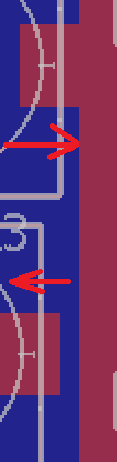

my worry would be the pwr. rails being so close to each other in a few places.~.25mm
Ok, thanks. I should increase this to at least 0.4mm.

It looks really fine to me.
For manufacturing reasons*, I'd be a bit more careful with the vias however. They seem very close to some power tracks. No problems when they belong to that track but they could lead to shorts when they're close to another track.

Alright, this is nearly unchanged but all via clearances set to at least 0.4mm.

Hi tobias32,
First of all I am not a professional PCB designer but I see a couple of possible problems with your layout. First you have a ground plane cut under the signal trace below the potentiometer (upper left corner of your PCB).
The -15V power trace to the left of R61 on the PCB does not have ground plane below. Also instead of making so many cuts into the ground plane by traces diving from one layer to the other and then back again I would use wire jumpers. I understand that this board is not so critical as it is mostly not in the signal path but still.
Also, series resistors R60 and R61 should probably be before the bulk capacitors C3, C8 but not after them. And you probably do not need R59 because the reg does the power supply isolation. May be I do not understand the design idea but I guess R60 and R61 are there to isolate the local power supply from the power rails shared between many of your boards.
How severe do you see this problem?
(Concerning both: The -15V track and the track at the pot crossing the GND section.)
I just thought: It's not an RF layout. Surely it's always the best to keep the area of the current loop as small as possible. But isn't it good practice, too, to use wires or simple tracks for GND in audio layouts? Shouldn't any GND plane perform better than that? (Especially if only connecting two points as under the pot.)
Concerning the track to the pot: I know it's a bit of a mess of GND planes here, but I get two GND signals from two different areas of the amp board. I want to use both - each GND signal for the appropriate channel - to avoid coupling of induced signals into the signal chain.
But I also don't want to simply connect both planes as it would result in a GND loop - always very dangerous.
I could just place two tracks to connect the pot GND and pin header GND, but isn't a whole plane covering only some parts of the signal track performing better?
If you know a solution to this dilemma I would be happy to know it 🙂

Concerning both, the -15V track and the track at the pot crossing the GND section:
While the -15V supply may not be so critical as it is now, the cut under the signal trace around the pot does look pretty bad to me. Just think for a moment how the signal return should go in the current configuration?
As for the power supply traces (+ and -15V as well as +12V) to the left of R61, they can go to the underside of the board. This would allow you to lift to the top layer the LEDs control traces and would remove some via. You can also turn LED4 and LED2 to align with the other LEDs. It would not only help routing their control/supply traces on the top layer but will also prevent you from soldering them wrongly - one orientation is always easier to get right...
