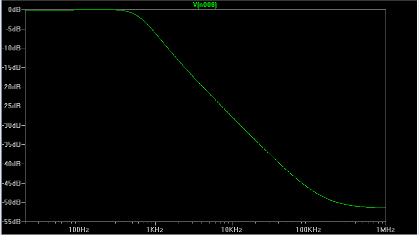

I looked at your sims with RC decoupling - the issue is (as always) the corner frequency of the electrolytics is generally around 3kHz (where ESR takes over from capacitive reactance) - above that very little reduction in supply impedance takes place. Around 3kHz is also the most sensitive region of our hearing.
So I went over to Mouser to see what they have in lower ESR capacitors, and they have these : RR71C151MDN1 Nichicon | Mouser

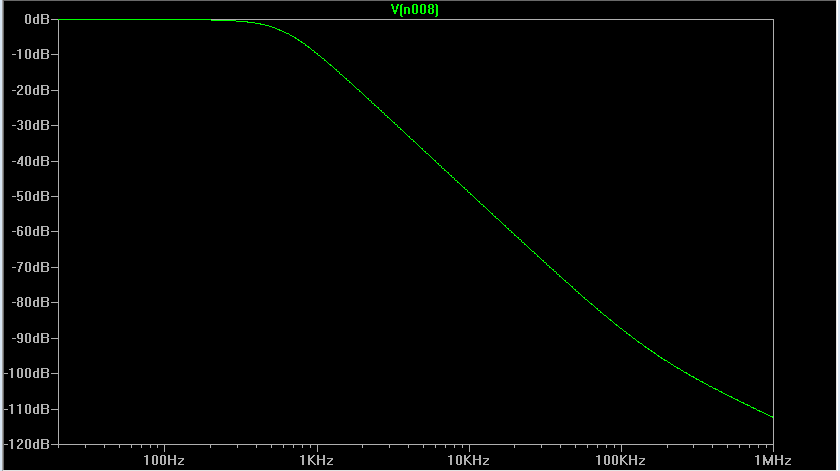

I simulated these in conjunction with some TDK inductors (470uH, SLF 7mm range). There's a need for series resistance too as the Nichicons are just too good - without series R they'll have too high a Q. The additional series resistance turns out to be 1.5ohms, the inductors also have about 1ohm series R of their own.
The plot of supply impedance (seen from the pov of the powered opamps, normalised to 2.5ohms) looks like this :
The plot of decoupling from the buffer's supply noise looks even better :

To further reduce LF impedance, I played around with some inductors parallel to the series resistor, but I'm always a bit afraid of oscillations, when inductors are placed side by side to capacitors.
As the load is far away from the impedances involved in decoupling, the combination of series inductor and decoupling capacitor is basically an RLC circuit with R as inductor DC resistance.
Its damping factor is R_DC/2 * sqrt(C / L) and should be greater than 1 to prevent oscillations.
So there compete two requirements: If L is too low, it's far away from a notable series impedance, so the HF decoupling decreases. To meet at least 1 ohm @ 1kHz it should be >170uH.
But as L increases, I need additional series resistance (in series to the inductor, not only between the two caps) - internal as DC resistance or external. For L=200uH it should be at least about 0.3 ohms to be inconditionally stable.
I therefore looked for an inductor 220uH with about 0.5 ohms DC resistance:
TYS8040221M-10 Laird-Signal Integrity Products | 240-2755-1-ND | DigiKey
Simulations look good for that values:
Just for comparance, the same inductance but with 30m ohms DC resistance:
So (220uH + 0.5 ohms) || 10 ohms look very promising. But I'm not sure, whether it is worth the additional effort.
Do you think it is? Or should I just stick with 1 ohm series resistance?
Yes, they really look promising!
And the choice of inductors looks good, too.
I'm just a bit cautious regarding the choice of caps. Polymere caps have really low voltage ratings. The best tradeoff I found was Nichigon 470uF 25V 15m ohms.
But I wonder if it is more wise to lower the edge frequency (by heading for 1000uF non polymere 35 m ohms) or to achieve real high decoupling for high frequencies.
With the former I achieve 28 dB @ 1kHz, 50 dB @ 3 kHz, 68 dB @ 10 kHz, with the latter 21 dB @ 1kHz, 45 dB @ 3kHz, 69 dB @ 10 kHz and with the cap you suggested 9 dB @ 1 kHz, 35 dB @ 3 kHz and 60 dB @ 10 kHz.
So maybe I should stick with the cap I currently use, would you agree?
If you worry about voltage ratings, run your opamps at 14V - the polymers I linked to are 16V rated. You originally said you were willing to forgo a volt on the rails to get decoupling - hence your 47R resistors.
15mohms won't have the HF rejection that the 7mohm ones I linked to have.
You'll need to weigh up to the two roles of the filter - the suppression of load-induced noise from the opamps themselves, and rejection of the buffer's load-induced noise. Of course the former becomes far less of an issue with higher feedback resistors.

I therefore added a simulation for the effective PSRR, including a model of the PSRR (just an RC with a load, but models the datasheet precisely).
So, you're right that it performes at bit worse >10 kHz, but as the PSRR rolls off that early, the frequencies to worry about are around 1 kHz.
But of course, this completely depends on the opamp used.
Fortunately both - cap and inductor - have the same footprint (not compared to each other, but the two variants), so I can choose them according to the opamp.
However, both variants completely outperform the variant with just a resistor:
So the real gain is using an inductor (even with little series resistance) for additional decoupling.
So a very good idea 😉
