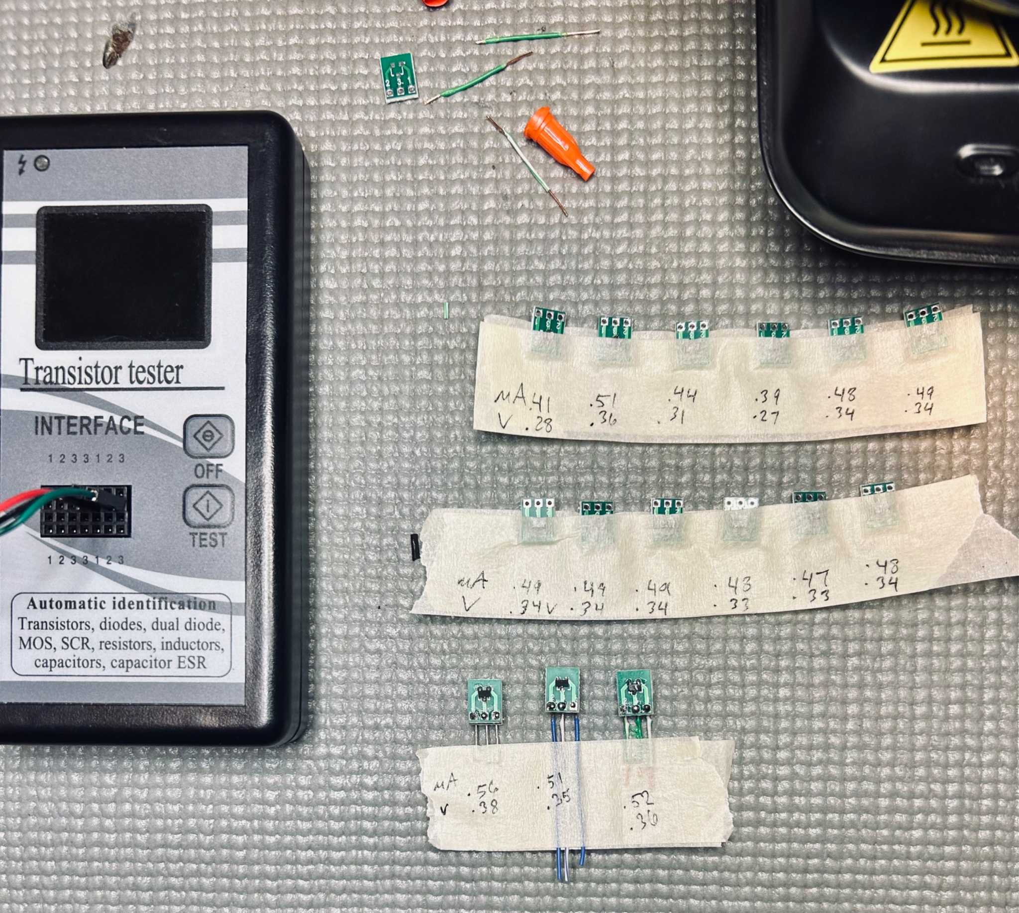

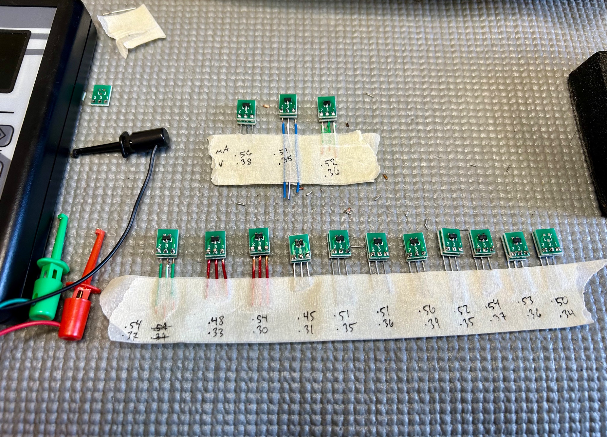

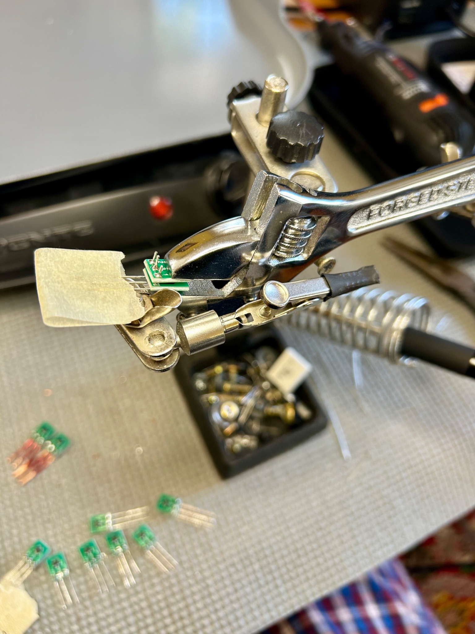

I made a couple more three legged friends and prepped 12 more K209s for “dualizing.” I don’t know if the little transistor tester is worthwhile to help pair these, but I took measurements anyway.

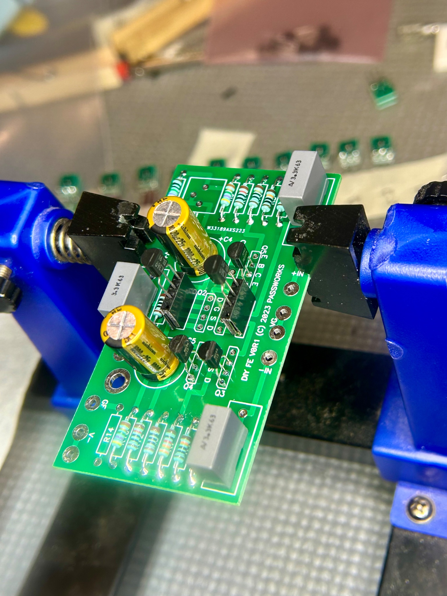

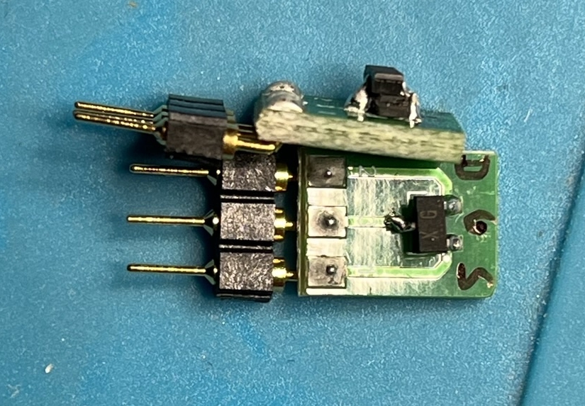

So I now have a bunch of dual K209s to experiment with. I’m quite proud of my PCB clamp. :spin: I played with different legs in my construction:
  • Clipped leads from other projects (best)
  • Solid CAT5 wire I typically use for input wiring (messy insulation)
  • Solid 18G magnet wire (PITA varnish removal with dremel, which was better than flame removal)

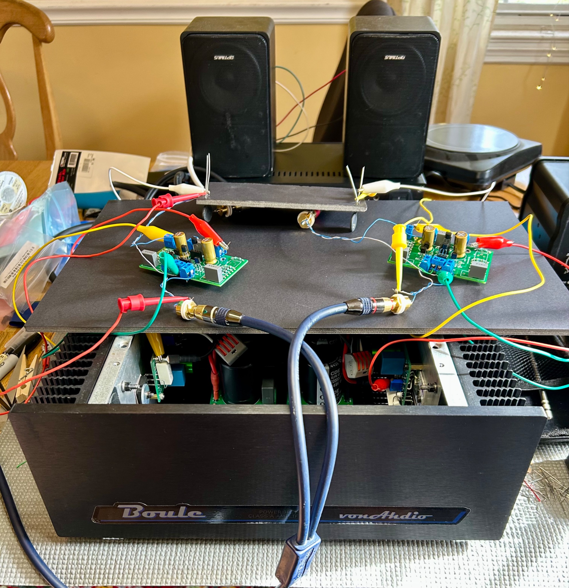

I have both R0 and R1 FE2022 kits to use.

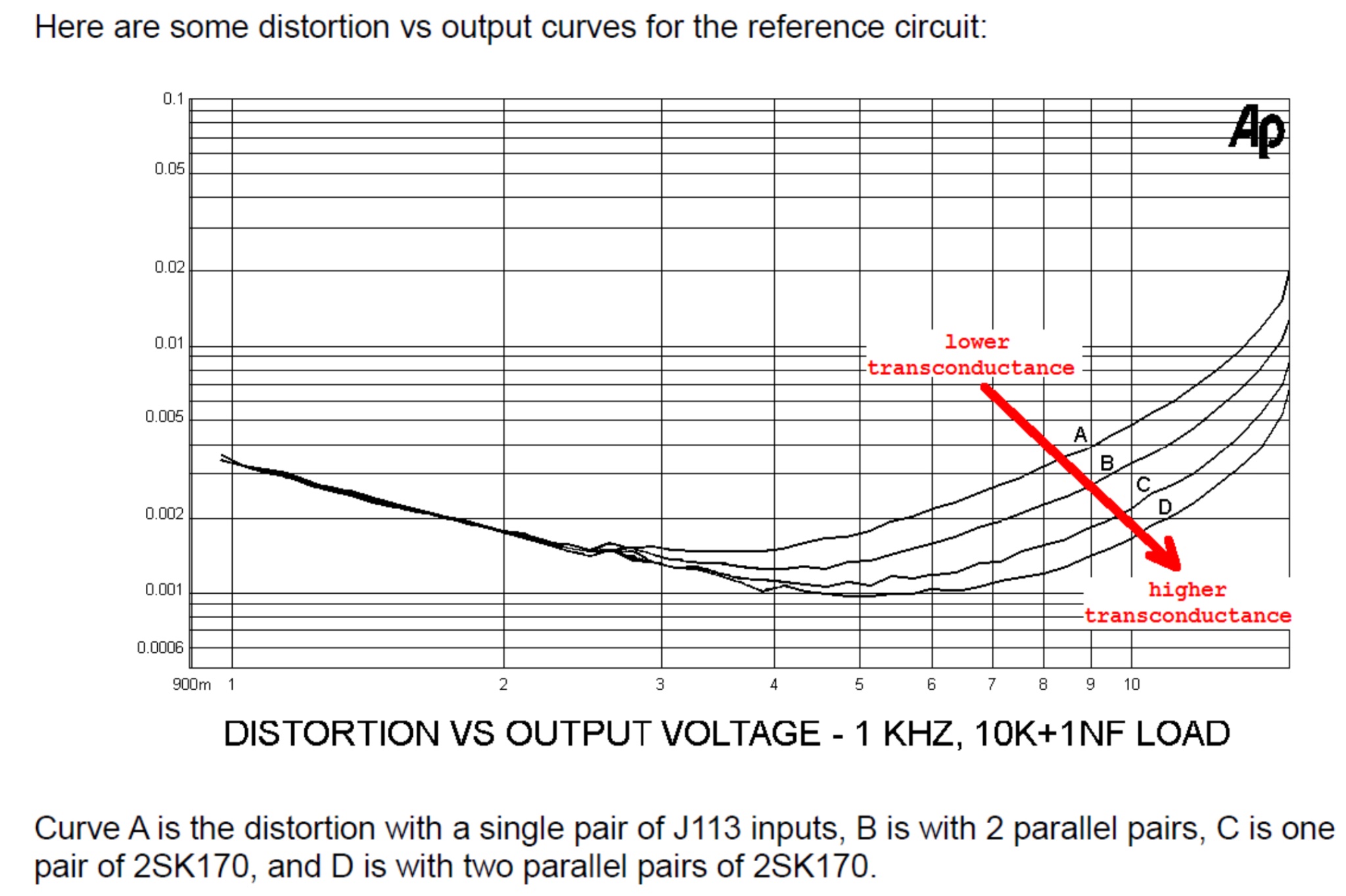

What would be the minimally invasive, noob-friendly recommendation on how to incorporate my equivalent-to-K170 dual JFET creations?
RTFM option: build a JFET matching rig based on threads and Nelson’s articles. Use that info to determine what resistors to change in the FE2022. Learn.
Hand-holding option :deerman:: Use existing J113 CCS in the kits for Q3/Q4 and pop in K209 duals in for Q1/2. Does that make sense? Would that give me the presumed benefit of the K209s (driving Nelson’s ‘Curve A’ downward)?
Thanks for any guidance.

I suggest just using them in Q1 and Q2. I don't know whether they would make much difference in the distortion when used in the CCS.
I also suggest that you use pin sockets to mount them in the board. That way you can start with the J113s, measure the distortion, then switch to one pair of 2SK209 in Q1 and Q2, measure, and then add the second pair to Q1 and Q2, and measure again.
By the way I think with two J113 in Q1 and Q2, the distortion is Curve B.

What I’ve settled on (for now) is the following:
  • R1 Kit: This is slated to be incorporated in my BooLu OS build. Lowest distortion goal.
    • Q3/4: kit J113s
    • Q1/2: 2 of the 4 matched K369BLs I have with sockets
    • No P1
    • No R14
  • R0 Kit: For stand-alone build or to be used with my unfinished MOFOs or another build (M2 OPS, etc.)
    • Q3/4: kit J113s
    • Q1/2: 4 of my K209 critters with sockets
Interesting concept. Yes, just one K369 JFET (which I read as an equivalent to a pair of K170s) I am no circuit analyst, but from my layperson’s viewpoint, I thought that Q3-4-5 provided the oomph to drive the OPS and Q1-2 provided the input finesse. I certainly have the K209 critters to try in multiples for Q1-2, too. That would be thorough.
