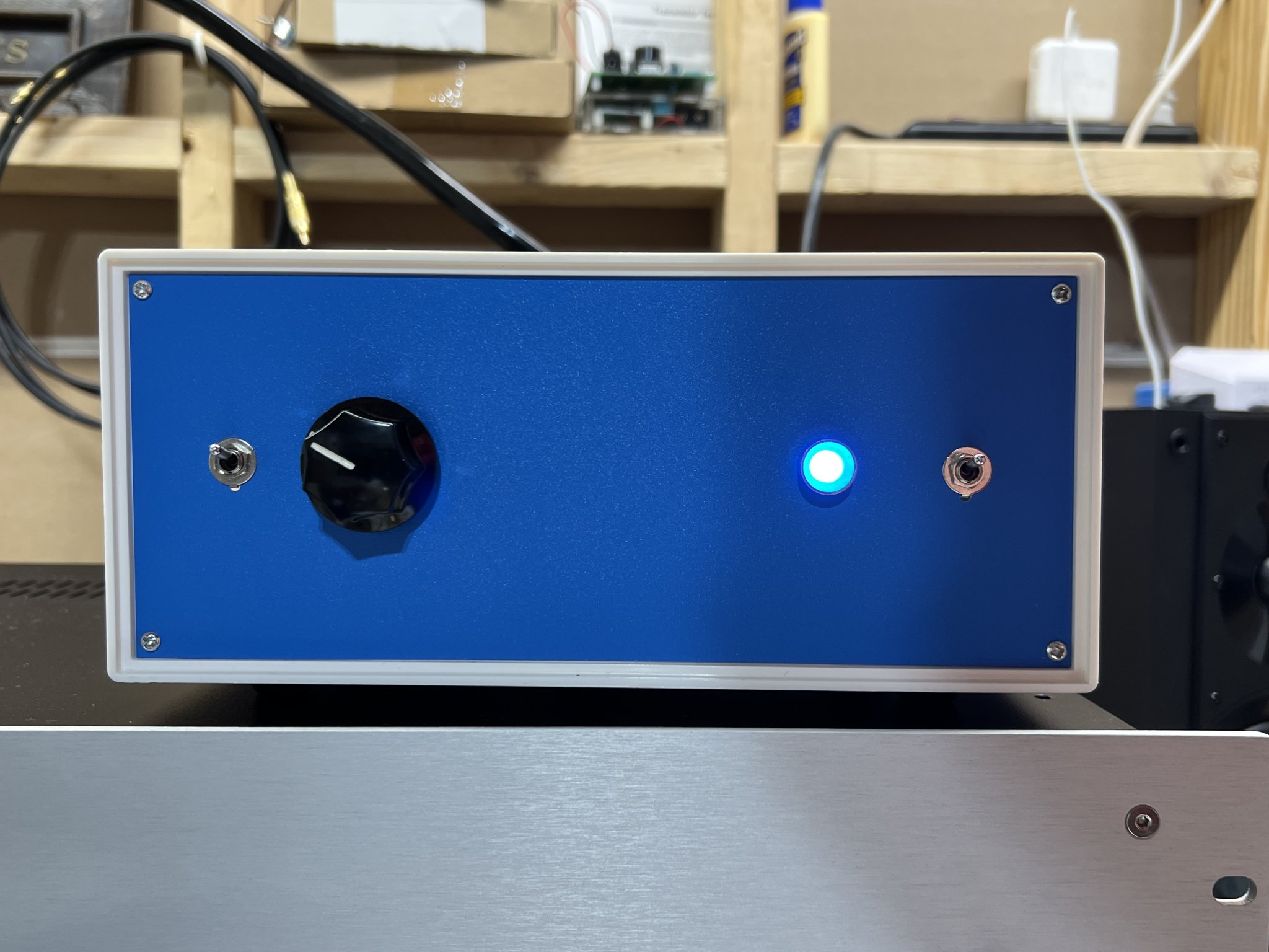

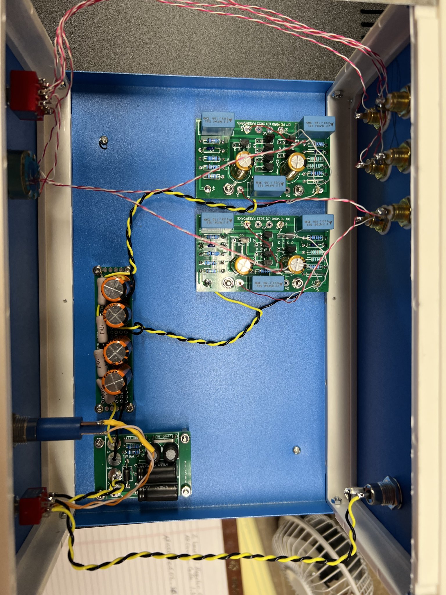

I finally finished my build and got it working after forgetting to add 3 zeros to the end of resistors 3 and 4. I guess 100 ohms is not 100,000 ohms. This is not the first time I made this kind of mistake. You would think I would learn from my past mistakes and triple check resistor values.
Once that was sorted out the FE22 works very well. I'm enjoying it with my Miro PMC63 DAC and SissySIT. I will have to swap it out and see how I like it compared to my BA3 pre and F2J combo.
The build is using a 24vdc SMPS with MJ's SMSP filter and additional RCRC filtering like on the ACP+. The pot is an ePay 10K DACT. I picked the case up from Amazon.
