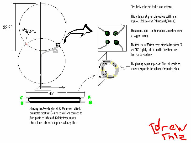

i am very confused when researching j-poles because they are mostly used for HAM and transmitting. i want to receive signal and have no idea where this all fits in.
Illusus, can you just give a quick description of what materials you used, and what length of rods for your j-pole?
i know how to make a polarized loop, but how do u make a double polarized loop, and is it better?
whats a vertical ground-plane antenna?
sorry if these are all newb questions

EDIT: this design is a log-periodic array -- has nice bandwidth although the gain is somewhat lumpy:
here's an EDIT implementation used by a ham radio operator on 432MHz which can be repurposed for FM -- this design will give around 8.5 dB of gain with a front-back ratio of 22 to 28dB:
they used copper tape for the elements and affixed them to a piece of foamcore.
for a 100MHz antenna (98Mhz to 102MHz) the element spacings are as follows:
Yes a double loop is better, a single loop will have a horizontal or vertical polarization depending on it's orientation to the feedpoint...a double loop has both vertical and horizontal poles. It's easy enough to build but it has a funky impedance which can be corrected by using two equal lengths of 75Ohm coax and connecting their shields at either end, you'll have to tightly coil the phasing line to create a choke...the antenna is balanced and it's signal needs to be converted to unbalanced, coiling the T-line creates a choke and easier than making a balun, one to one transformer.
How to build one?...it's simple but the words escape me, I'll try, basically it's two 38.25" dia. loops with a slight overlap, both on the same plane, not perpendicular or anything...on one side where the loops overlap will be the feedpoint for both of them, it's actually diagonally polarized...ah heck...I couldn't make sense of this If I read it...I'll draw a pic....
