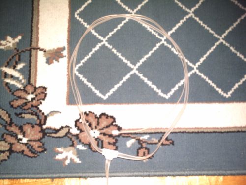

update on my swag
Looks like my SWAG is off, that it's linear and not square root. According to
So now it looks like you can locate the feedpoints for these other feedline impedances by taking the ratio of (desired impedance/50 ohm), and taking that resulting number and multiply it by the length from the bottom (shorted end of the J pole) the instructions tell you to place the 50 ohm coax connections. NO square rooting.
So now (for a Jpole cut for receiving radio stations in the FM broadcast band):
The length of twinlead is 0.66 meters for the stub, the length of wire is 1.4 meters, and the feedline connects, measured from the left,
for 50 ohm coax, 5.8cm
if my NEW SWAG is correct (for a stub made out of 300 ohm twinlead):
for 100 ohm twisted pair, like that in ethernet cat 5 cable, 11.6cm
for 300 ohm twinlead feedline, 33cm
for 75 ohm, 8.7cm
Oh and as far as antennas receiving as well as the transmit, look at the physical size of a dipole for channel 2 (big) vs one for channel 50 (small).
Both will transmit equally well, but on receive, the bigger dipole will intercept more signal.
As a scientific wild *** guess (SWAG) it looks like you can locate the feedpoints for these other feedline impedances by taking the square root of the ratio of (desired impedance/50 ohm), and taking that resulting number and multiply it by the length from the bottom (shorted end of the J pole) the instructions tell you to place the 50 ohm coax connections.
source http://home.windstream.net/tanders/files/copperjpole.pdfKJ6RZ and KH6HCU in their paper "copper pipe Jpole antennas"
The impedance at the bottom of the stub is approx 0 ohms, and very high at the top end where it is an open circuit. In the middle the stub is equal to its characteristic impedance. (paraphase here) which for twinlead is 300 ohms.
for 75 ohm, 8.7cm
