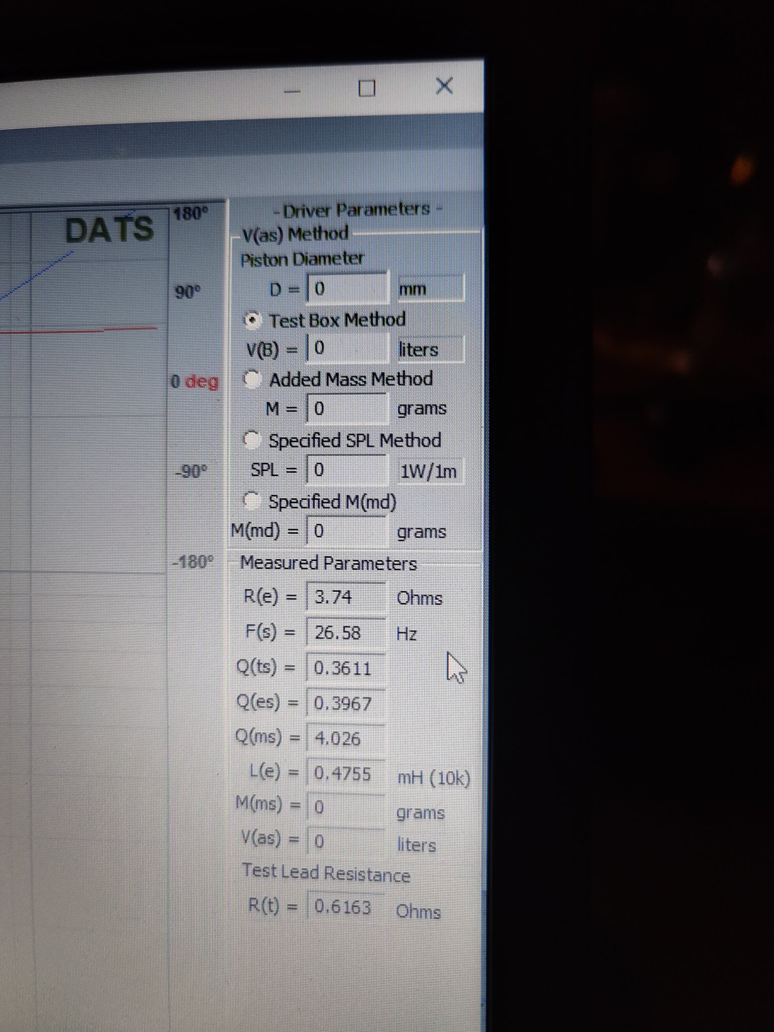

I think...repeat think this is the TS of one of mine. Atleast the quick ones. Hadn't added any mass for any further parameters

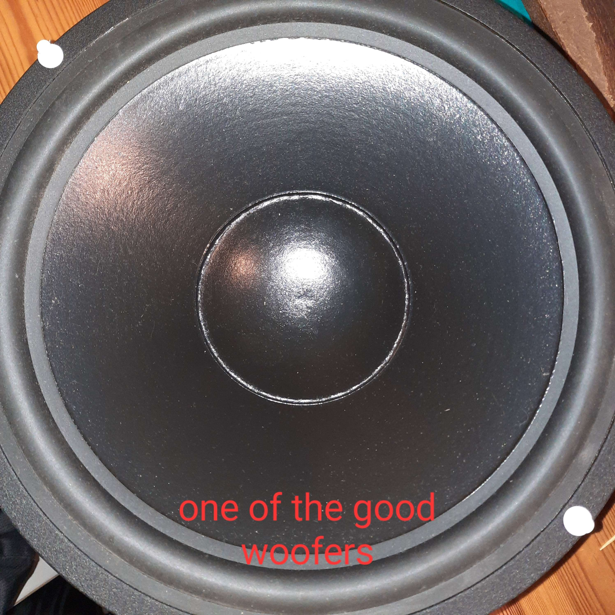

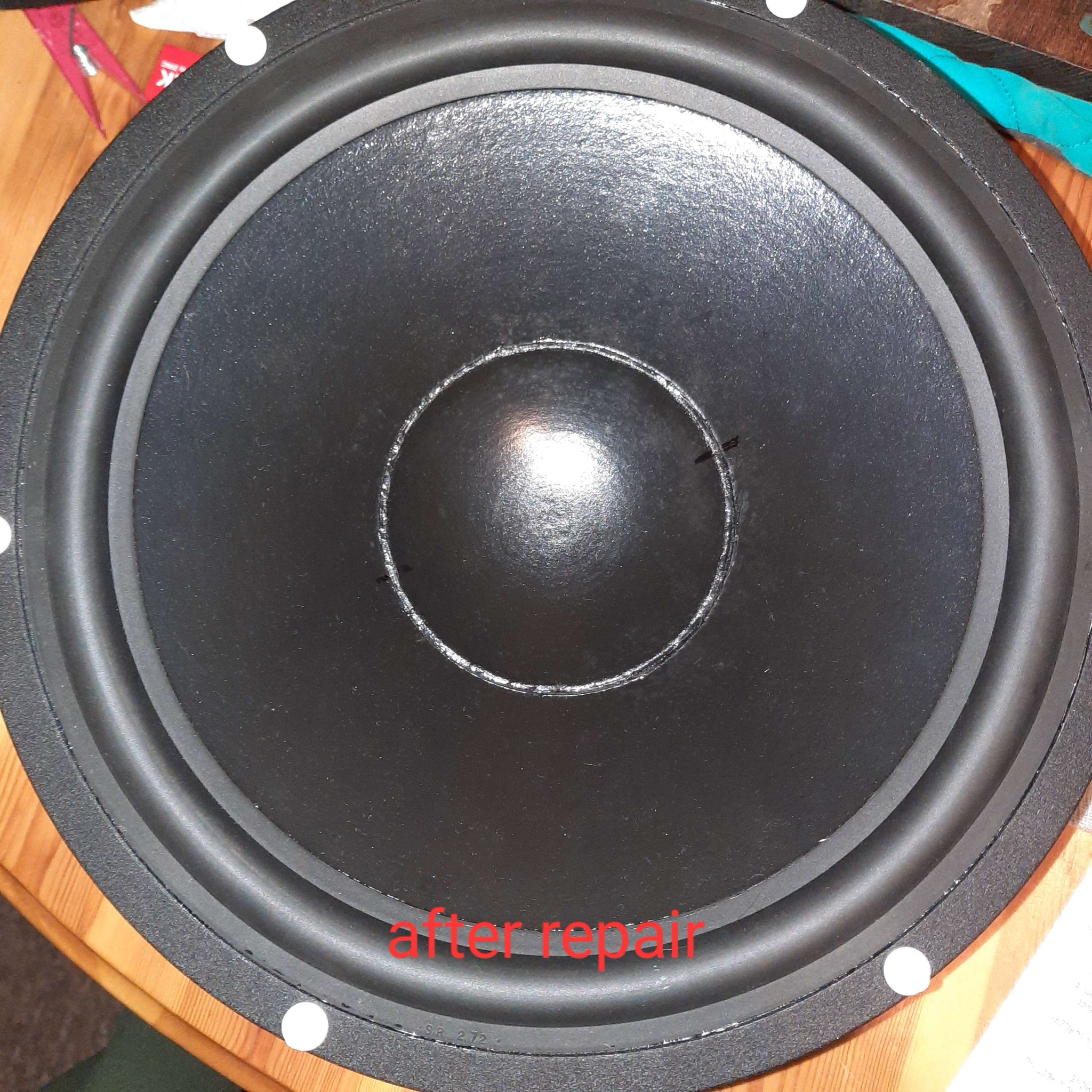

its was a success no rubbing good moment and sounds great.
i think i did a good job of putting every thing back together looks nearly identical except the dust cap being a bit off
(i am aware that this is now on the 3rd page so if you go back to the 2nd page there are images of how dissembled the woofer was)
