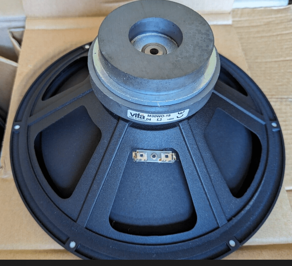

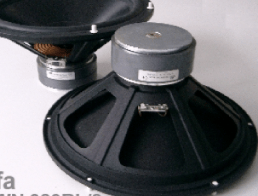

I bought some of these off ebay too for 25quid each . I found out they were used in a kef subwooferSo i have x4 Vifa 12in woofers and i want to use them in a speaker build.
these are the part numbers for them its M30wo-15 and they are 4 ohm.
I cant find specs for them anywhere except a similar version the M30wo-49-08 the differences are that its 8ohms and has a double magnet system but except from that they use the same chassis(magnesium), cone(coated paper) and surround(rubber). i will put an image of them.
Anyway i what to use 2 of these woofer per tower for a the woofer part and wired up to make a more friendly 8 ohm and want to use a Vifa D27 or D20 as i got 2 stored away both 6ohm
The main parts that i am struggling with is that i don't know the sensitivity of the woofer and the specs for the similer one is 93dB
and i cant did a mid that has that kind of sensitively to match.
I'm going to get a Dayton audio DAT to take some parameters of the woofer (also needed for other project). idk how far that's going to get me but hopefully this will help me find box size.
I'm thinking on have the crossover point about 400hz and 2600hz. and preferably sealed, prob not possible but down to 40hz ish

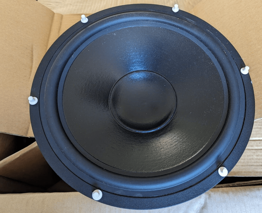

Vifa M30wo-15 (what i have)
View attachment 1239714View attachment 1239716
Vifa M30wo-49-08 (the kind of similar one)
both look like they have a pole peace vent but they do not its just a pre drilled hole that doesn't go through.

I bought some of these from ebay for 25quid they were used in the kef subwoofer 30b it was a quite small sealed subwoofer hope this helps somehowSo i have x4 Vifa 12in woofers and i want to use them in a speaker build.

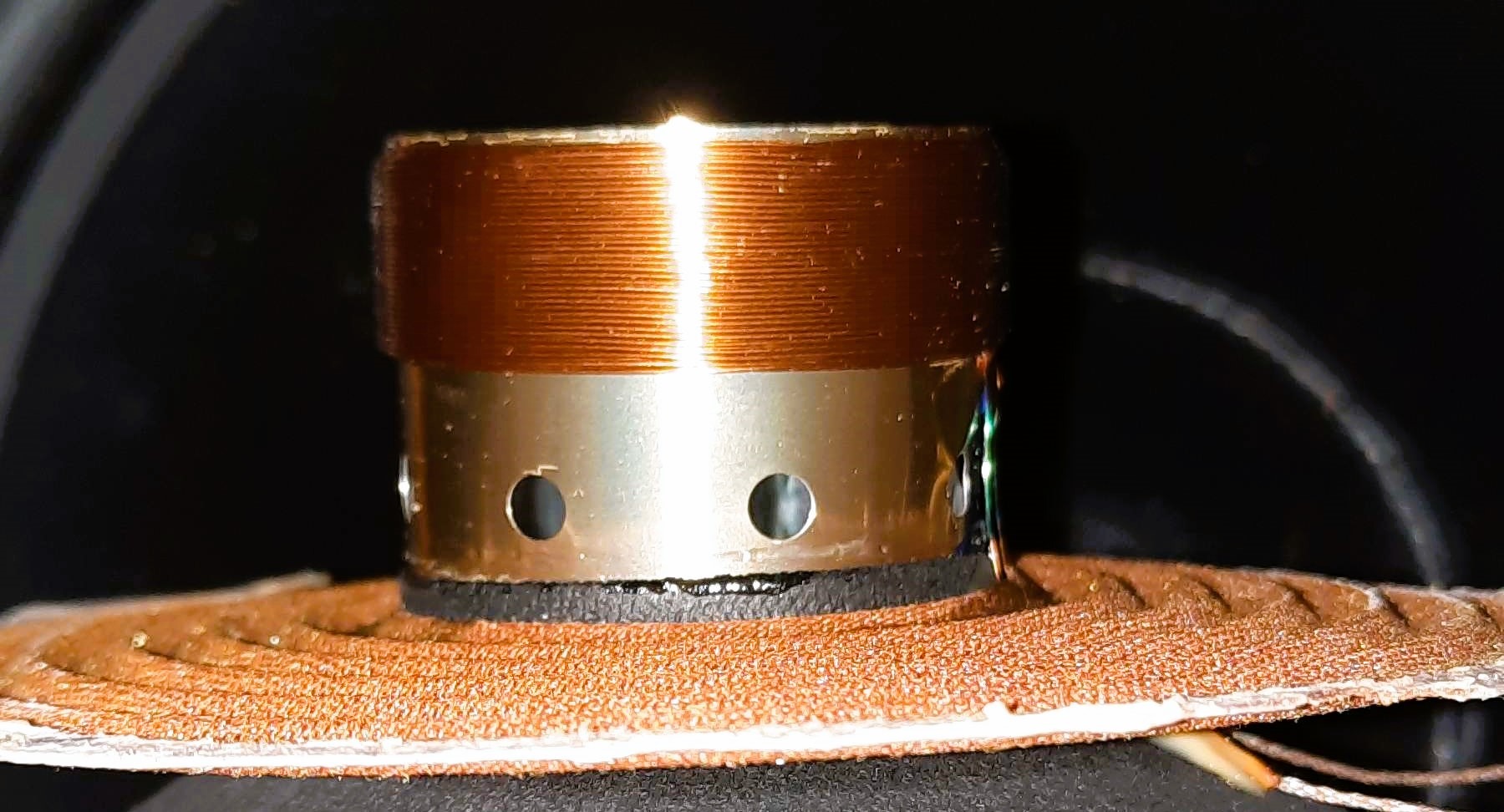

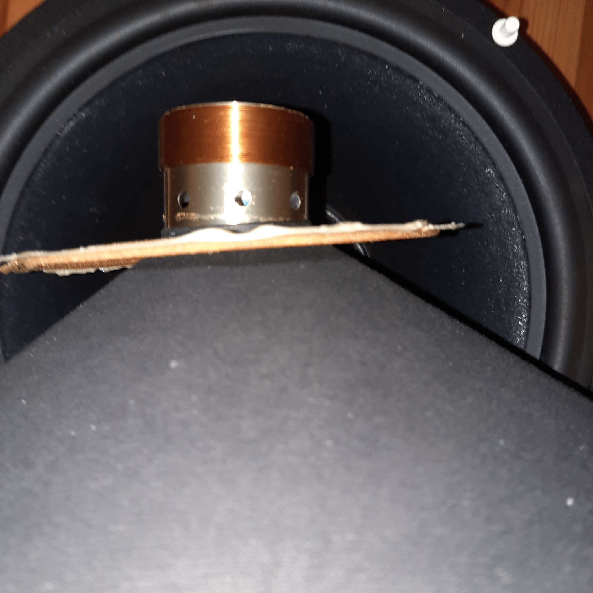

so i took the woofer out of the box i put them in and although i did test them before i put them away i did not test the full stroke of movement and one out of the 4 rub at the near the bottom and top of the stroke.
so i peeled the surround off the chassis in hope to re-centre it can i cant do it without shimin the coil but i cant get the dust cap off as its one with the cone (the plastic coating used is is on with the dust cap) if i try to cut it off its just going to go though the cone or worse rip off the plastic coating, i have done that once nightmare lol.
anyone got any suggestions on how to re-centre the voice coil with out taking off the dust cap? (its a really thick paper dust cap)

Hi Callum. Interesting. I too bought 4 off these 12" Vifa. I did wonder who bought some more! I have measured one in DATS. Quite low Fs, maybe 26Hz IIRC but also quite low QTS. I was hoping to use mine in a dipole/ripole/slot loaded set up. A pair per channel. At 4 ohms each the usual woofer parallel wiring will be 2ohms obviously and so only good for simple class D or otherwise serious solid state amp.
Regarding your rub, you have 6 holes on the mounting pcd so you get 5 goes at biasing the gravity effect on the VC. Can you 'balance' it out? Shall have to measure mine more closely to check for this. Assume you've used the Rub test in Dats for this .?!

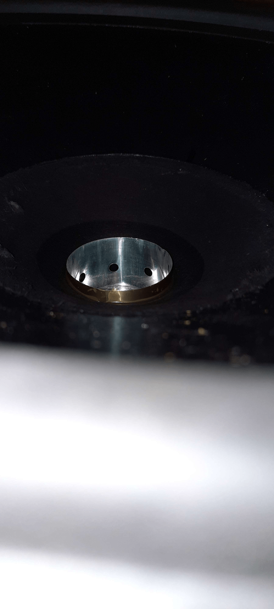

its much worse than i thought i took of the dust cap so slowy near perfect but once i saw under it i died on the inside. the coil was lop sided i got an image but in the process of taking the spider glue off to look whats going on under it ill update you after
these are new old stock from 2001 (thats was it says on the vifa sticker on the box it came in) so this came from factory like this uhh
uuuuhhhhh. well i will have a go fixing it and i feel like i can do it with a ruler some epoxy and some surround glue. um mabe some thing small and round to smooth out that dent that may have been when i was testing it.
ah and a small knife to get the coil of the cone
idk where the coil is meant to sit but imma guess its the length the leads are at and i think i can see a slight glue line.

So the voice coil former isn't level in the cone? Can't really tell from the pics? I better test my 4. I was going to say the seller has a few left but having just checked they've gone.
