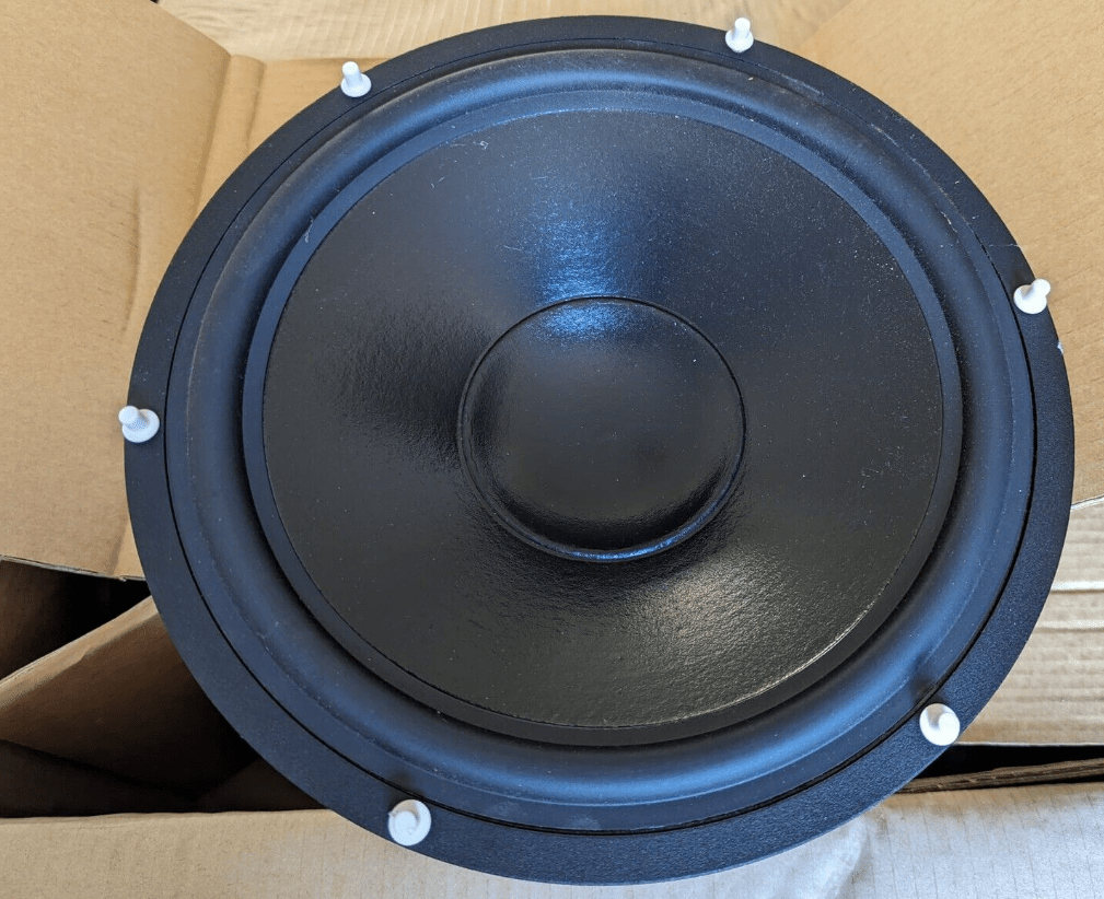

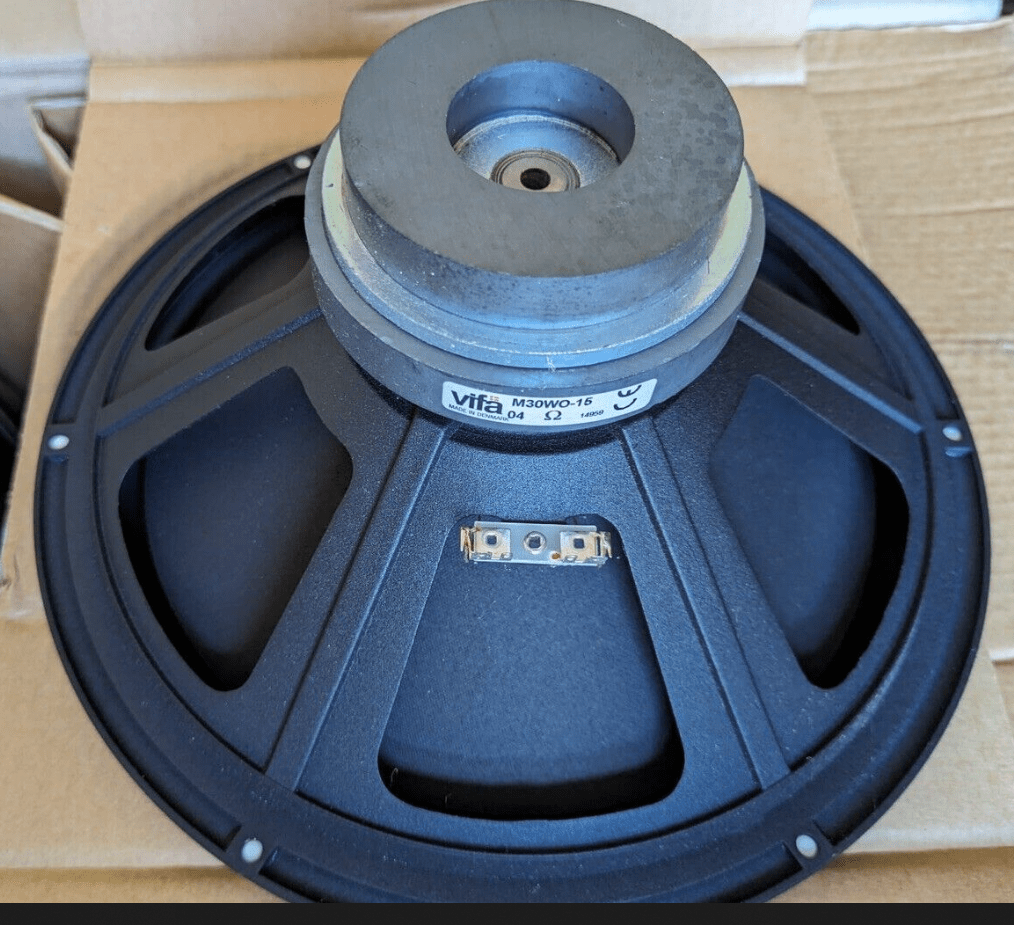

So i have x4 Vifa 12in woofers and i want to use them in a speaker build.
these are the part numbers for them its M30wo-15 and they are 4 ohm.

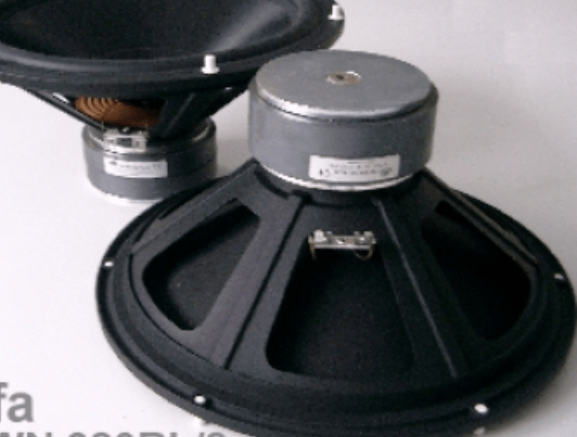

I cant find specs for them anywhere except a similar version the M30wo-49-08 the differences are that its 8ohms and has a double magnet system but except from that they use the same chassis(magnesium), cone(coated paper) and surround(rubber). i will put an image of them.
Anyway i what to use 2 of these woofer per tower for a the woofer part and wired up to make a more friendly 8 ohm and want to use a Vifa D27 or D20 as i got 2 stored away both 6ohm
The main parts that i am struggling with is that i don't know the sensitivity of the woofer and the specs for the similer one is 93dB
and i cant did a mid that has that kind of sensitively to match.
I'm going to get a Dayton audio DAT to take some parameters of the woofer (also needed for other project). idk how far that's going to get me but hopefully this will help me find box size.
I'm thinking on have the crossover point about 400hz and 2600hz. and preferably sealed, prob not possible but down to 40hz ish
Vifa M30wo-15 (what i have)
Vifa M30wo-49-08 (the kind of similar one)
both look like they have a pole peace vent but they do not its just a pre drilled hole that doesn't go through.
i got them for 25 pounds each witch i think is quite good. and if all fails i can use them for a sub.
Sorry for the large amount of writing
Any help would be largely appreciated.

So, you'll wire them in series for a sensitivity that remains equal to that of a single to maintain the 8 ohm load you want.
Let's say it is 93dB, and they are positioned vertically below mid and tweeter. This means the one adjacent to the floor will get full BSC due to the floor boundary load. However, the one above it will not. Being that, let's look at this as still needing a couple dB of compensation for baffle step in the xover, yielding 91dB. Insertion loss for the xover could take 0.5 to 1.0dB more away for an approximate 90dB net sensitivity of the woofer pair.
Guessing a xover of 400-500Hz to 2.5k as a guess could yield a dB of bandpass gain for the midrange, so a mid of 89-90dB would likely be spot on. There a good many pro style midranges in the 4-6" size format that will likely meet your needs, and still have to be padded down to match that of the woofers.
