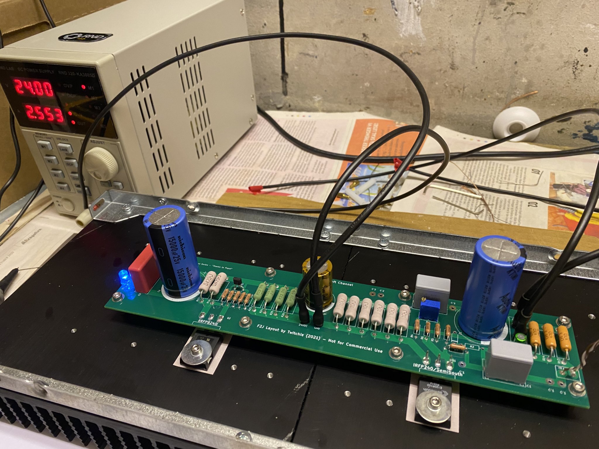

First channel up, seems to balance fine. A few more measurements are up. Then moving on to the second board, after reversing the LED (damn greenhorns
Plan is to finish it up with scope and residual waveform analysis, once all else is done.

2nd chan up. Both may need a bit up Iq bumping, but we will see what happens with a proper PSU. Now for some chassis and PSU work 🙂

Btw, gate reverse leakage current is 18uA for right chan and 22uA for the left. Works fine with R6 @ 8K2, range to spare.
Ok ok, so I forgot accreditation. And yes, I mean JFET gate reverse leakage current.

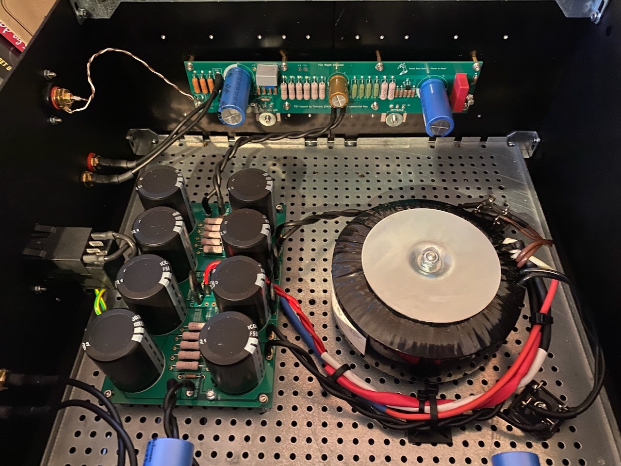

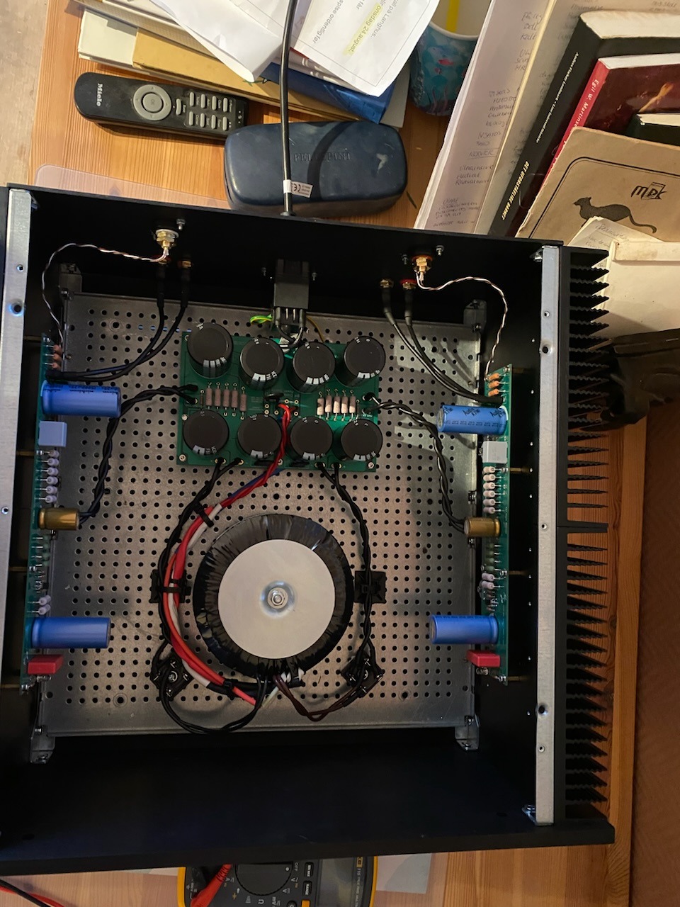

Up and singing. Best sound I have experienced so far in my DIY travels, extreme in fact. Smoothness and warmth - a tonality out of this world, dynamic as well. And more bass as expected with my FR’s.
Iq adjusted today by parallelling across the source resistors.
To my huge disappointment the audio grade Toroidy in fact buzzes. Will try a DC blocker, but this is really subpar and way below expectations.
Measurements and fine adjustment pics to follow.

Got 300vA’s for my AJ. Though run at lower currents and therefore not directly comparable, they are completely and utterly silent. Not possible to hear they are on.

I could reverse phase. But Toroidy has confirmed this has no effect. Though ime, I have experienced buzz reduced when swapping secondaries. Let’s just say all efforts need to be worth it. Everything, EVERYTHING, is soldered. Since I had great confidence in these parts…
What I can say is that the buzz level seems current dependant. Perhaps a loose windingc dc on the mains, a saturated core (though well under 50% of the rating), and or a combo…
That would be an interesting test and may give more indications of where the problem lies, but I would not consider that a satisfactory solution. After all, my understanding is that Andy is using a 400VA transformer and it should not have a problem handling the standard current load for both channels.

300vA, wound around a bigger vA core for reduced flux density, or something along those lines? «Buzz»
Or 400 vA? The more the easier saturated by DC, so which way to go?
PS: I know you use 2 x 300vA for FW current levels. What would be your recipe for just one tranny?
