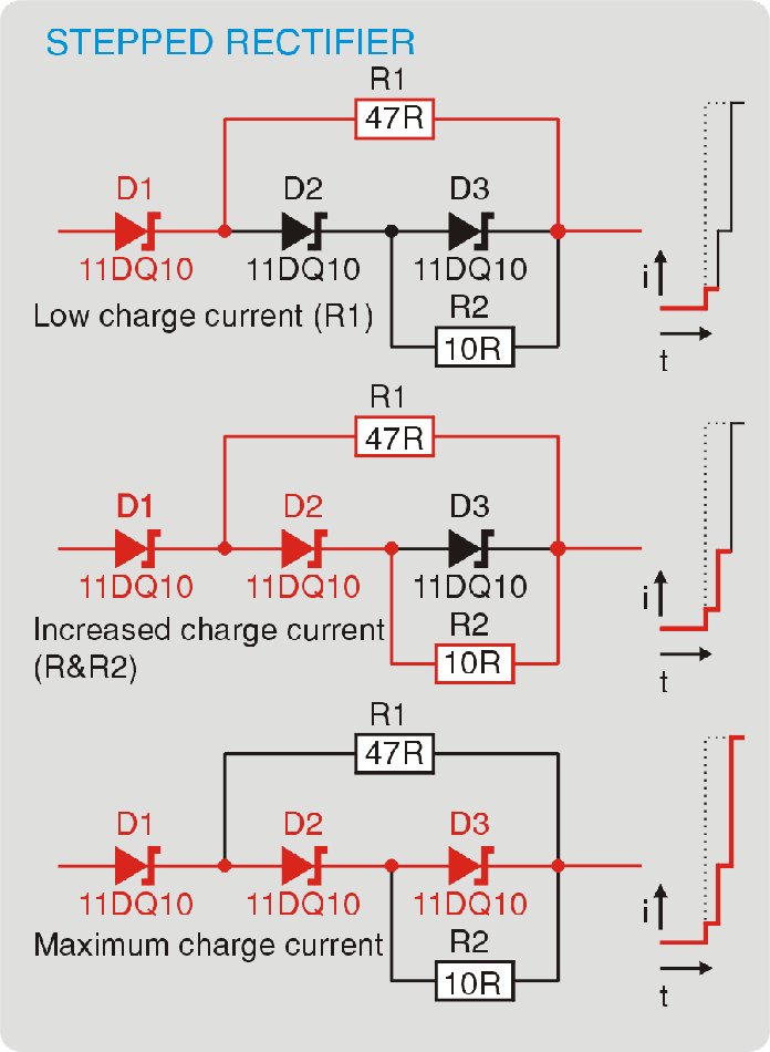

Another clever trick that I've used, both in low power and high power circuits, is -ECdesigns'- stteped rectifier.
Diodes and R values can be upgraded/increased to meet desired power ratings. 😉

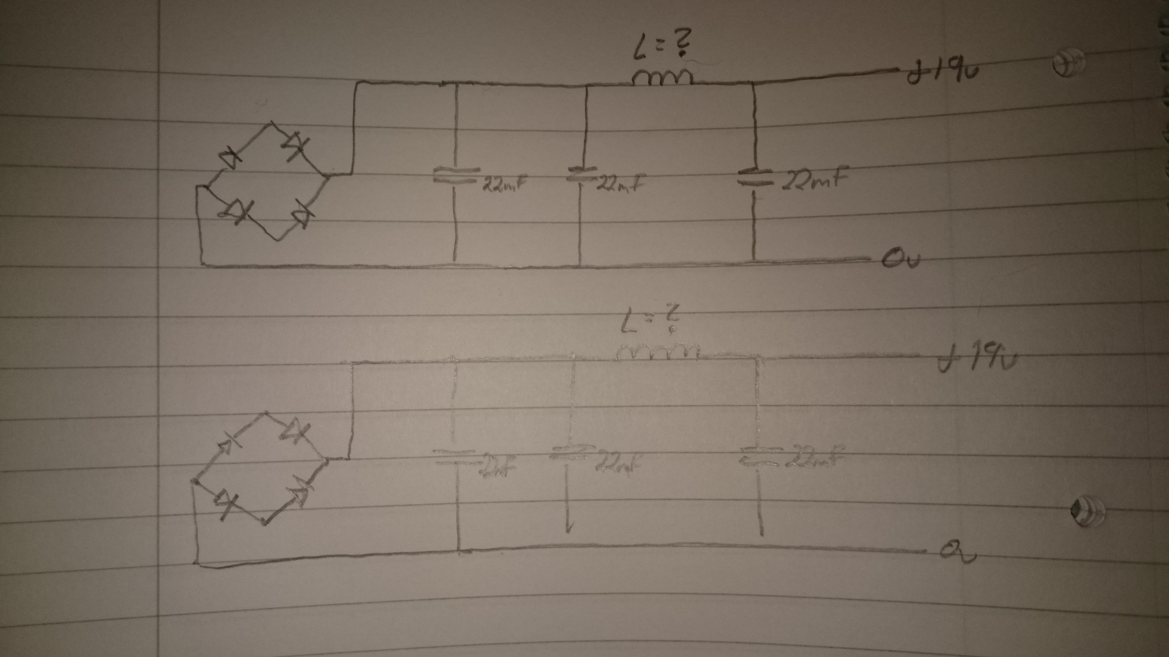

what are Rdc values for these chokes ?
Info Hammond Chokes:
156B: 1,5mH RDC=0,07ohm DC-Current max=5A
159ZJ: 10mH RDC=0,16ohm DC-Current max=5A
There is also 155B at 6mH but only max current 2A (RDC=0,3ohm)

more the merrier
go for 10mH
considering C as 22mF , go for CLCC
hopefully that for one channel , so you'll need two chokes
go for 10mH
Yes, similar to drawing, one CLCC for each channel (each C=22mF) so need two chokes.
Have to look for positon in case for chokes.... Those 10mH are BIG..... 🙂

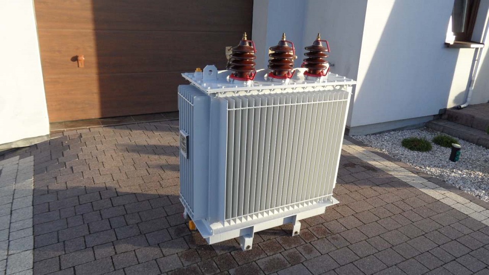

Dumpster at work only have these big chokes.....:
Need bigger house.... 🙂

Ok! But in transistor amp current is much higher and voltage much lower than in tube amp, so chokes must have much lower DCR. The chokes then get really big end expensive.
Mounted today CRCC with R=0,25ohm (2x0,5ohm 10w in parallell). Much more silent now! 🙂 Have space in amp for 10mH Hammond chokes but must then rearange everything inside....
