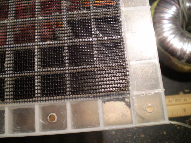

A good mechanical connection is all that is required on just a small area.
I had cut the material to the desired shape and dimensions after it was coated and had left a little tab to connect to.
I had also sealed the perimeter edges in clear silicone sealant this worked very good.
But has I had mentioned that the aluminium gets very brittle when flexed too much.
Because I did not properly mount the tabs, They eventualy broke off flush and there was nothing to connect to.
Since the edge of the wires where exposed where they broke off, I was able to remake the connection using a conductive glue such as NICKLE PRINT or a WINDSHIELD DEFOGGER REPAIR KIT to adhere piece of flexible wire to it.
A conductive glue made of white glue very heavily doped with graphite powder may work good aswell.
Although I did not try it because I still had some nickle print left over that was about to be completely hardened as it was quite old.
I did use it for the charge ring and it worked great.
I have not had a problem since.
You can get pretty ceative as to which mounting method to use.
I plan on incorperating a sandwhich type clamping system on the next build so that this little aggervation doesn't happen again.

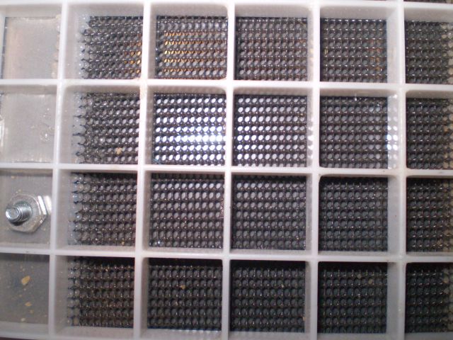

It is not necessary to connect all of the wires at the edge of the stator (although I did do this on my very first painted version and it did not look very neat).
Due to the nature of wire mesh, all of the criss cross pionts is adequate to make sure that all the wires in the stator are connect to each other enregizing the complete panel.
I verified this with an ohmeter on the first one I did before I sealed up the edges and have had no problems with any of them including the painted ones.
This should help you get an idea.
If you like I can post some closeup pictures as there are some posted in the buried threads. jer

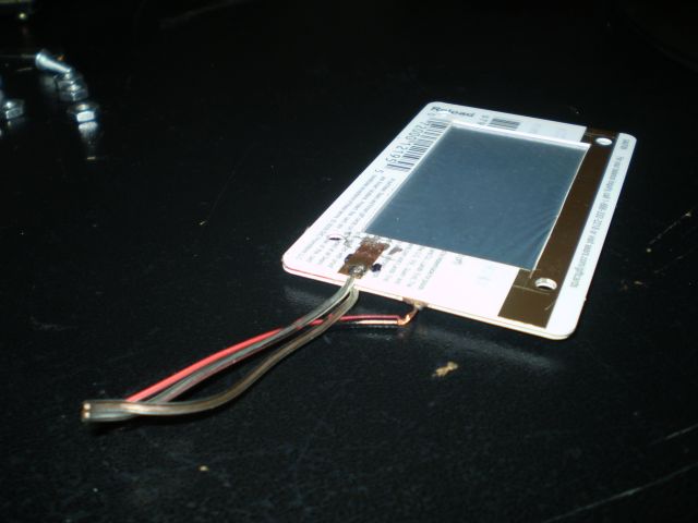

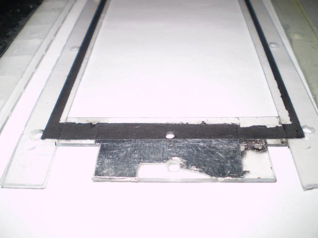

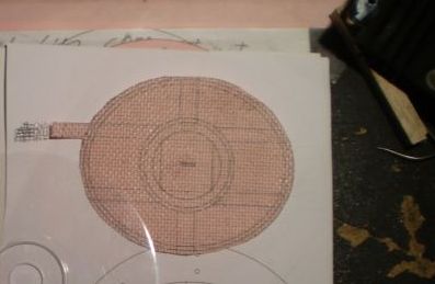

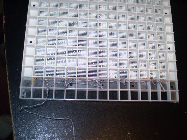

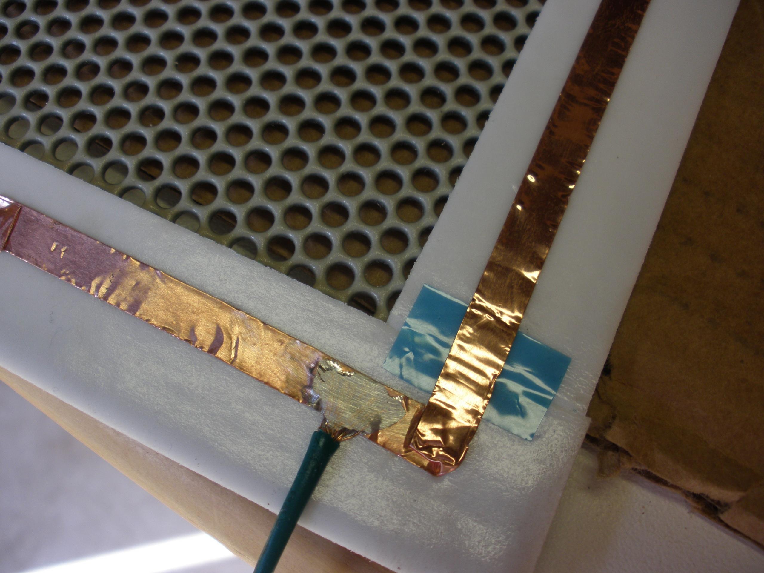

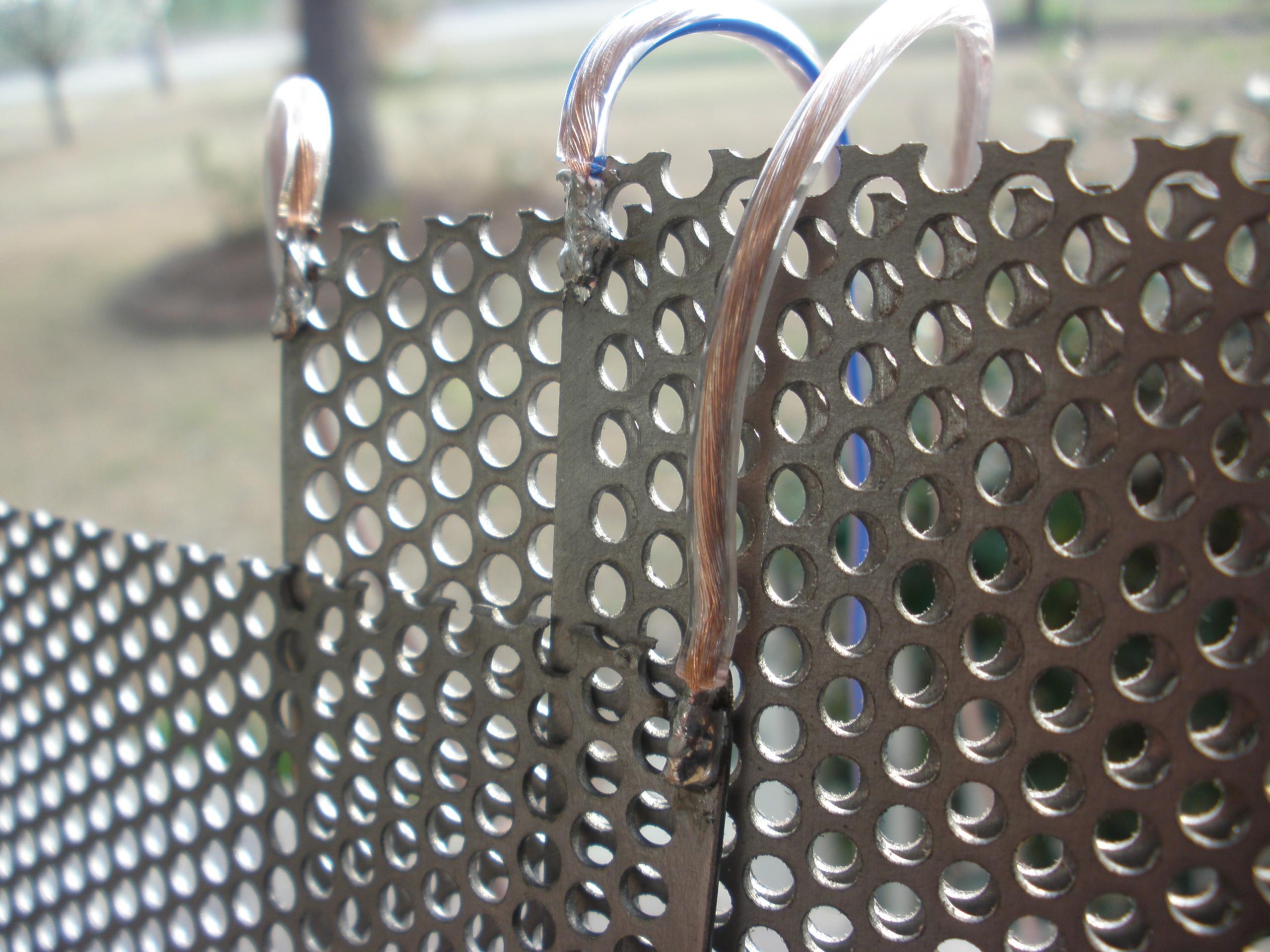

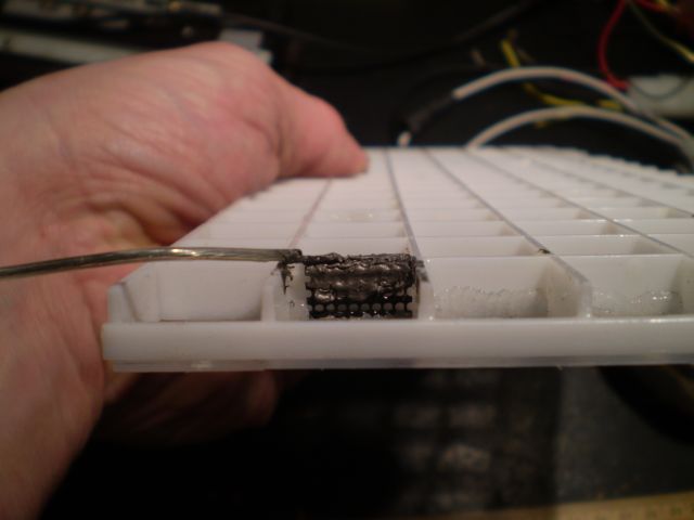

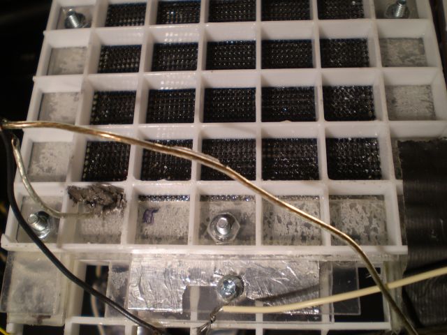

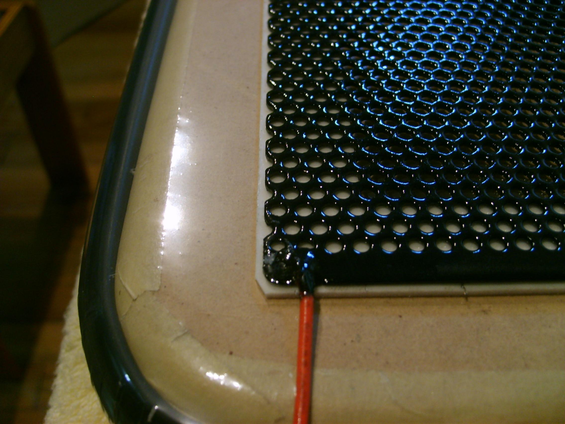

Here some pictures of a few connection methods that I have used so far.
The twisted wire method was used on my very first panels.
Before I had any idea of whether or not there would be any problems at the voltages that these panels run at.
So far I haven't had any problems as far as the connections are concerned.
Enjoy! jer
Enjoy! jer

Since I'll be using 1mm perf steel stators I'm considering soldering the wires to the edge of the stator?
Maybe solder a wire to the charge ring as well?This way I'll have three neat little wires to work with?
(I just started soldering mic-capsules, soldering to the edge of a stator should be a breeze?)

I would definitely solder the wires to the outside corners of the stators and you want to do that before you apply the stator coating. Mine are spray painted so I used 16 gauge stranded wire on the stators with standard insulation and there was no problem. However, standard insulation would melt in a powder coat oven so, if you will be powder coating your stators, you would need to use wire that has a high temperature silicon insulation. I would also solder the wire connection to the copper foil charge ring, but using a smaller diameter stranded wire (20-24 gauge). I used a wood chisel to notch out the inside of my wooden frames where the wires connect to the stators so the connections are neatly hidden inside the frames.
Use a good hot soldering iron with a large electrode for the stators and it takes a while to get the stator hot enough-- just press the iron to the stator as long as it takes to make the solder wet to the stator.
One more thing: When you strip back the wires to make the solder joint on the stators, make very sure there are no un-insulated portions of the wire hanging off the stator edge.

Ahh,Okay,I have the pictures of Mavrics connections ready aswell.
Another method you could use is to either spot weld or braze (high temp soldering) a small tab on the metal stator so that you can use a push on type connector like the ones commonly used on regular speakers.
Then you can simply tape the connector tab up with high temp tape to keep it from getting coated.
When using metal sheet be sure that you grind or sand off any and all sharp edges and points as these will cause an exteremly weak spots in the coating and they will leak and arc in those spots.
Mavric used some sort of sanding ball thingy on the surface and he said it work very nicely on the sharp edged side of the holes.
I have tried using nylon nuts and bolts and I had a hard time getting adeaquate pressure to secure the connections and evantualy stripped out every one I had.
I found that only the very large diameter ones worked okay but they were much to large for my appilcation and were quite costly besides.
jer

Yes, if the stators are to be powder coated, I think the best solution would be to braze a tab on an outside corner before the powder coat. Any welding shop or auto body shop could braze the tab on for you in a couple of minutes.
If I were going to use a mechanical connection, I like the connection Roger (SM7UYJ) made on his speakers.... a hole countersunk on the inside surface to accept a flush metal bolt on each stator, attaching a steel tab on the outside. The spacer would cover the flush bolt head and that should work fine.
Attached is a photo of my stator being attached to the diaphragm while the diaphragm is on the bike-tube stretching jig. The wire was soldered on using a medium 30-watt soldering iron and .040 rosin core solder before the stator was spray painted with polyurethane.
