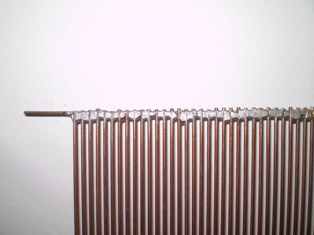

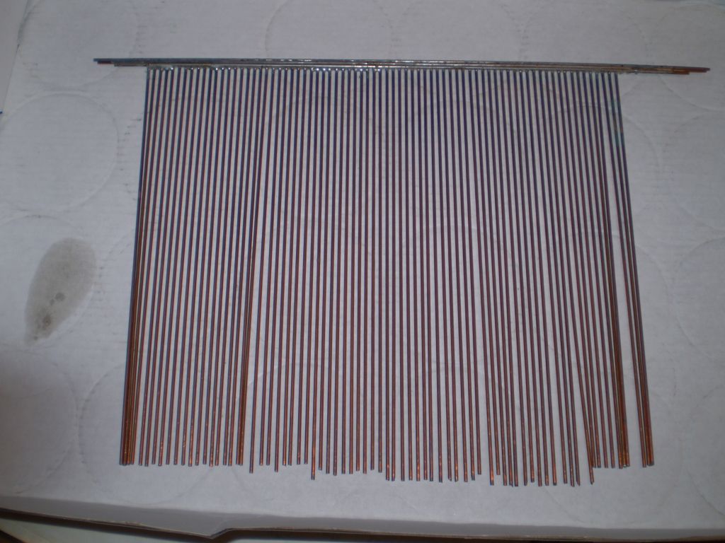

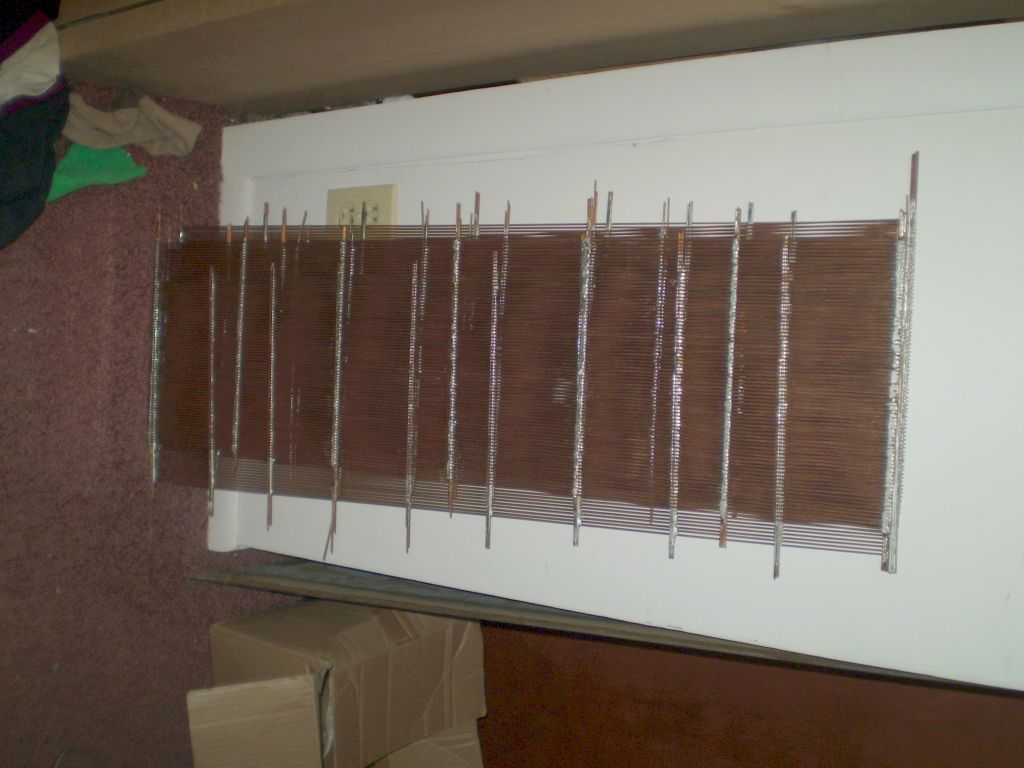

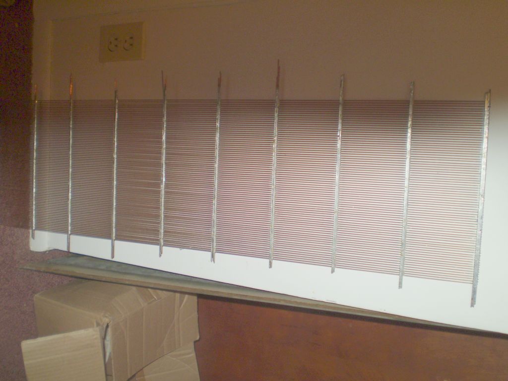

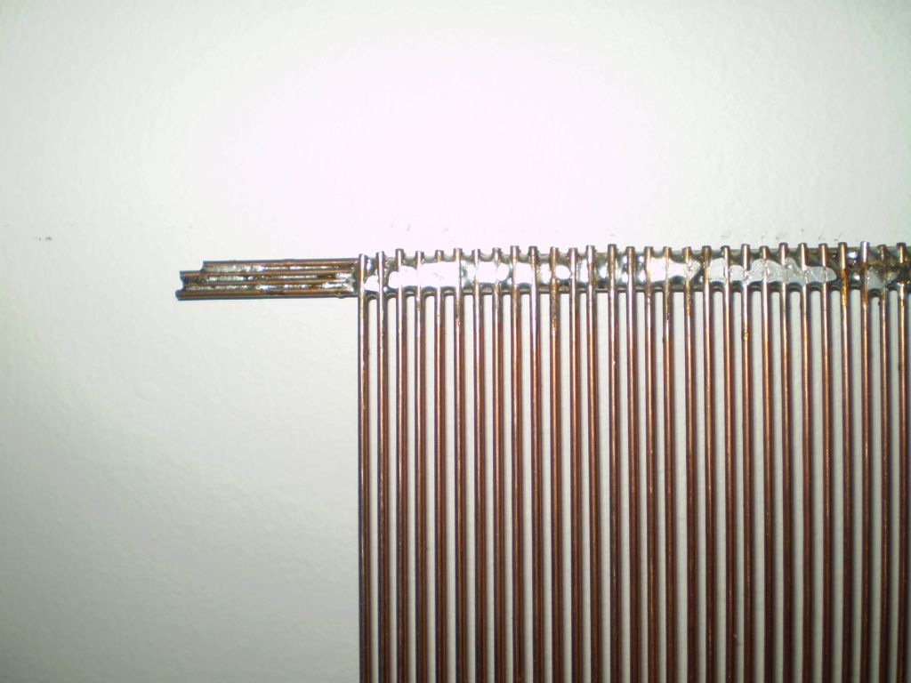

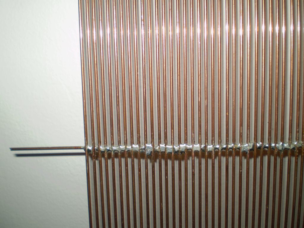

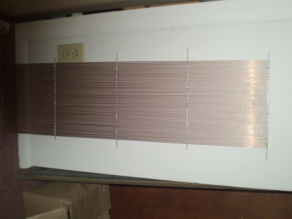

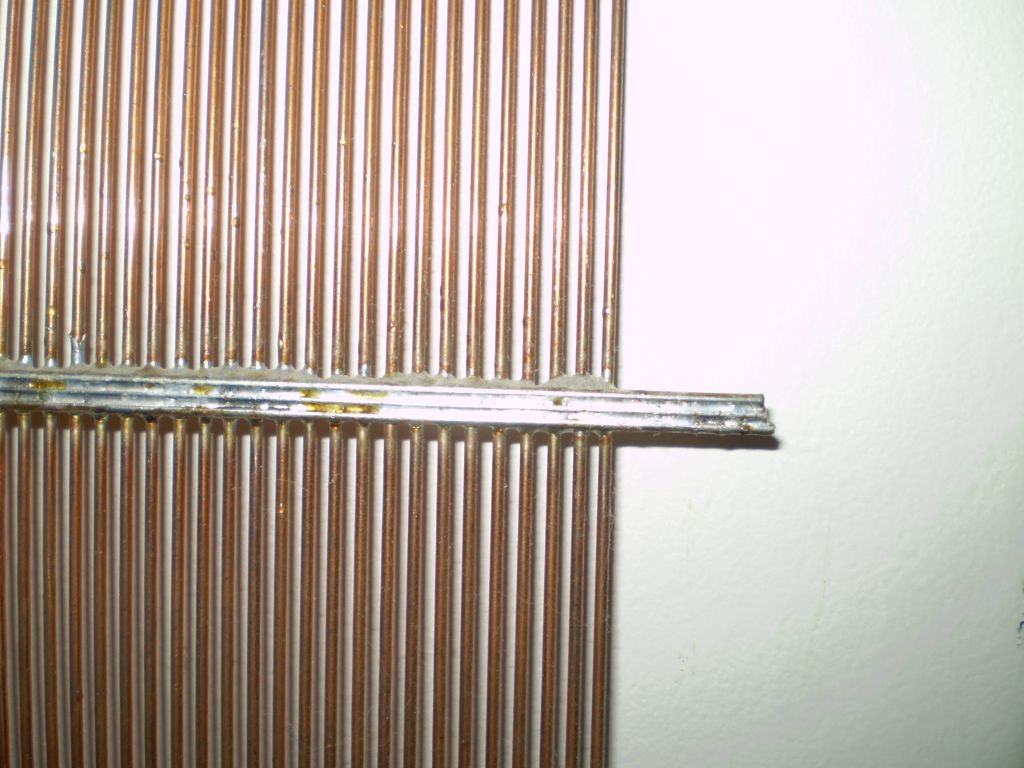

Here is another method that I used to make wire stators.
Although I have not finished them yet.
I did go through A couple of soldering guns to complete them as I did this on my desk during one winter.
The plan was to build a jig so that I could use a small torch to quickly and evenly solder the the supports.
But I never got that far, aswell as finishing them(he,he,he).
But, Hopefully I will get to them this summer as I still need two more in order to build two six foot panels.
I am thinking about cutting on fo them into segments and just build a 3' two-way panel.
They are made from standard 3' X 1/16" tig wire spaced 1/16" apart.
And they just need to be coated with some clear acyrlic or polyurethane for a stator insulation coating.
I had experiemented with different support spacing and I had found that one or none will be needed once mounted in a proper frame structure.
But two is plenty as they have been shoved around for seven years without being damaged as thet are qiute heavy.
It was quite a job and very time consuming to build them by hand that is why I would suggest the extra effort of building a jig if you plan on building more than 4 of them.
Enjoy DIYer's ! jer
It is amazing as to what you can do with enough determination.

I wonder what size the holes would be once it is stretched taut?
It is only 5" wide but you never know.
I wanted to try using some rabbit screen material,the galvinized stuff with 1/4" square holes.
I once had source for some that had 1/8" square holes and would be perfect but I can't seem to find it anywhere now. jer
I might be copper clad.
It appears to be a tube of copper mesh from the pics, which if it is, would give me a 10" wide swath of loose mesh. It looks pretty fine gauge. Would this pose a problem with the power supplies being too high for the gauge of wire(s)?
No, The gauge wouldn't be a problem but if the wires are kinky the sharp edges will be a big problem with sharp points causing areas that will arc over very easily.
You want a material that can produce a uniformly flat surface with no sharp edges or points. jer
Okay, so theoretically I spread this stuff out, take a flat roller and flatten it. This I can deal with.
Try it! You will never know unless you do.
I can't say for sure because I don't have A good close up of the material.
But chance are you might have a hard time getting it to be perfectly flat as close tolerances are required.
Typicaly < 5 mil and no more than 10mil over the entire span of flatness to keep the diagphram stable and 15mil is realy pushing it but may be acceptable.
But you never know, so check it out and let us know what you find. jer
