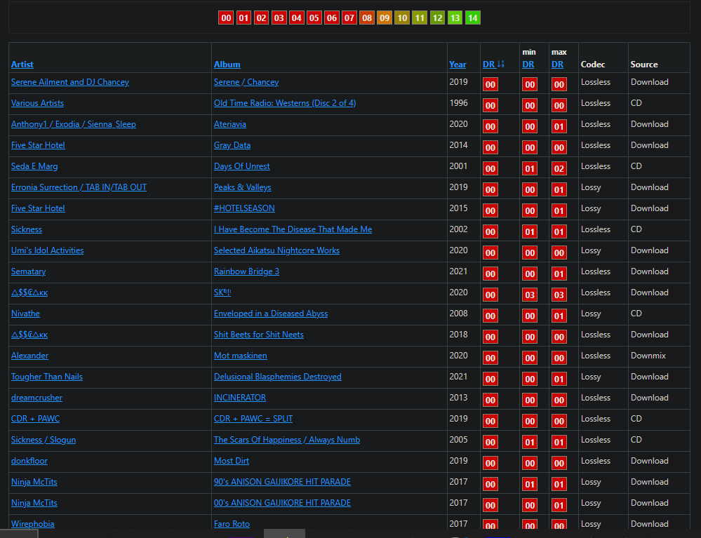

Here are the unaltered values for the CD version of that album, as reported by the Dynamic Range plugin:I did a few songs off the one, Amanda McBroom Growing up in Hollywood. ACX reported -10/-30, -2/-26, -6/-31, -6/-28, -2/-28 peak/rms on the first few songs. Those are reported in db. I think crest factor in db for the first pair would be 20 (-10 - -30)in db, or a crest factor of 10. The largest pair 2/28 would give 26db or a crest factor of 19 I think.
foobar2000 1.5.1 / Dynamic Range Meter 1.1.1
log date: 2025-03-02 03:31:40
Analyzed: Amanda McBroom and Lincoln Mayorga / Growing Up In Hollywood Town - from disc
DR Peak RMS Duration Track
DR12 -7.20 dB -24.96 dB 4:09 01-The Portrait - from disc
DR18 0.00 dB -20.17 dB 1:53 02-Peter The Hermit - from disc
DR13 -5.03 dB -26.26 dB 3:11 03-The Rose - from disc
DR18 -0.76 dB -24.76 dB 2:55 04-You've Lost That Lovin' Feelin' - from disc
DR15 -3.35 dB -23.33 dB 3:30 05-Dusk - from disc
DR18 0.00 dB -20.90 dB 4:00 06-Hooray For Hollywood - from disc
DR19 -1.37 dB -24.48 dB 3:38 07-Love Letters - from disc
DR17 -0.09 dB -22.78 dB 4:20 08-Amanda - from disc
DR12 -10.55 dB -27.95 dB 3:01 09-Silent Lady - from disc
Number of tracks: 9
Official DR value: DR16
Samplerate: 44100 Hz
Channels: 2
Bits per sample: 16
Bitrate: 626 kbps
Codec: FLAC
The crest factor for each track is reported by the first column of numbers (in dB) taking the (I believe) second highest peak per track for reference. Note the reported instances of clipping in tracks #2 and #6 (i.e., 0 dB track peak)
Chris
Not too far off from my audacity numbers. And mine could have some extra from clicks/pops on the vinyl. I recall buying the album in the 80's and thinking it was very realistic in the dynamics. I don't think sheffield did much processing, probably a final compressor to avoid overmodulating the cutter. It was direct after all. As I said earlier though, it is sad with the DR available with 24 bits that things are squished to near zero DR. The sheffield like all the albums I purchased back then got played very infrequently, the first play being used to record onto a Nak ZX-7 with good tape. And again, sadly that 80's era tech would be more than sufficient to capture today's hi-rez near zero DR recordings. Curious, what is the worst DR you've seen. Does it get to less than 3db?
Yes, it does. The lowest I've seen on discs that I own is about 6 dB (album crest factor), but there are much lower album DRs....Curious, what is the worst DR you've seen. Does it get to less than 3db?
https://dr.loudness-war.info/album/list/1/dr/asc
Chris
