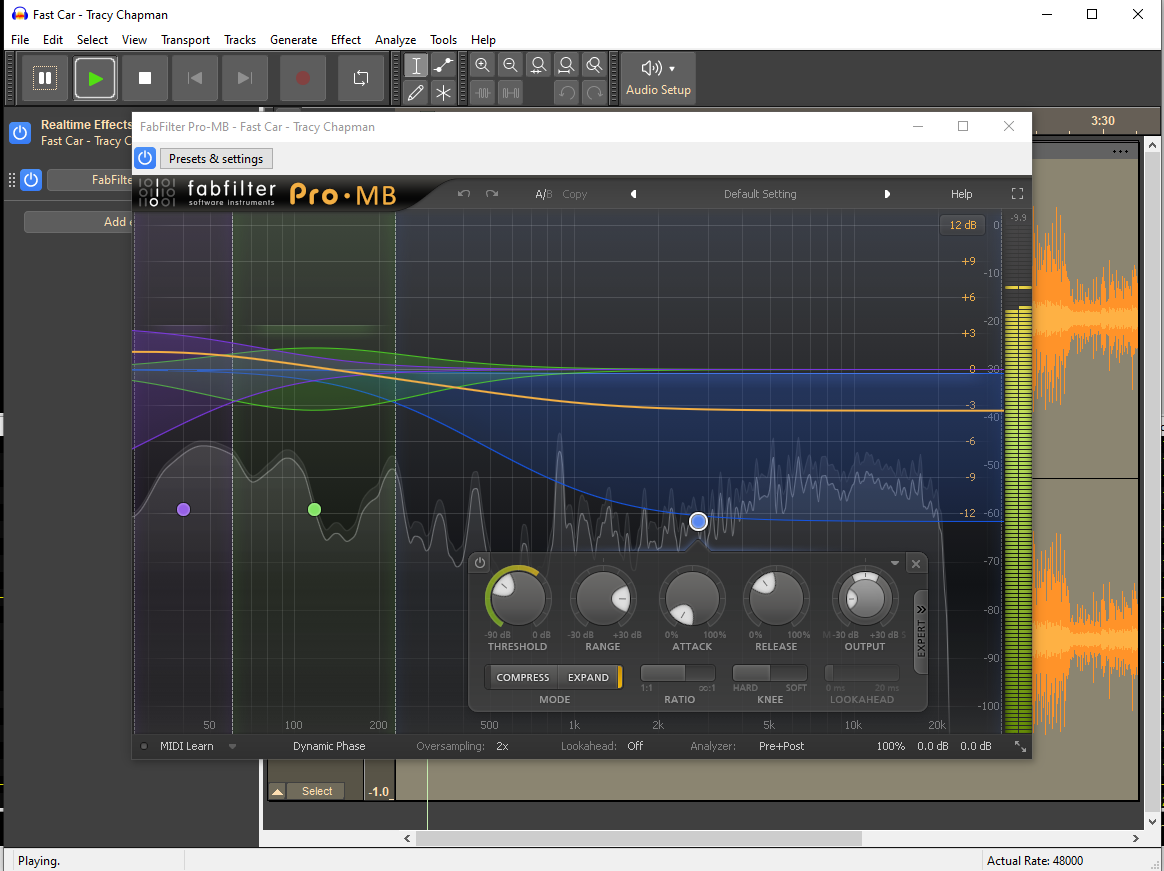

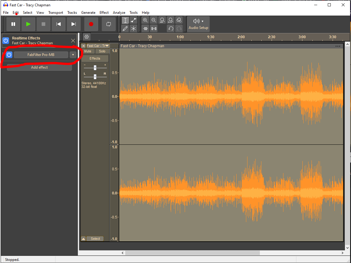

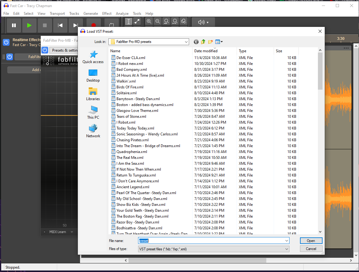

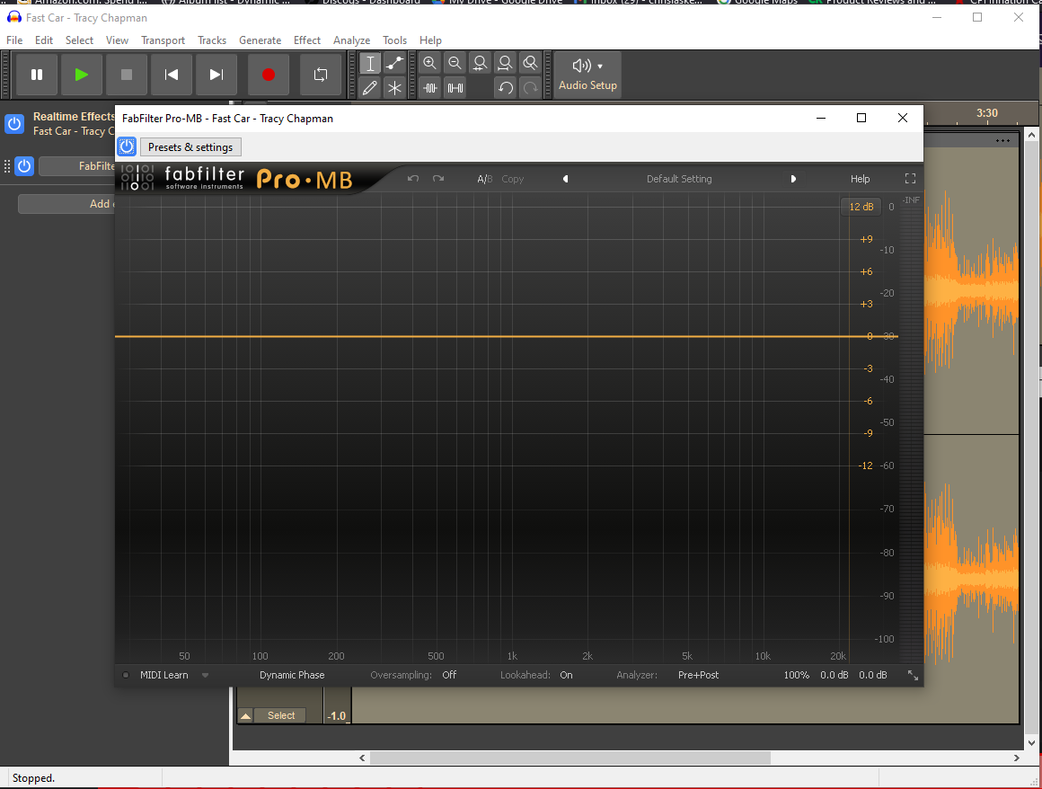

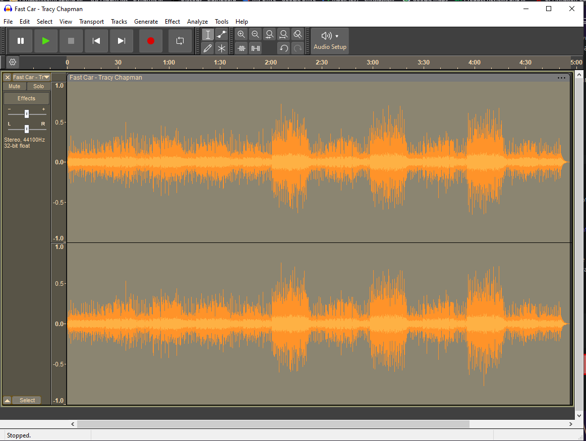

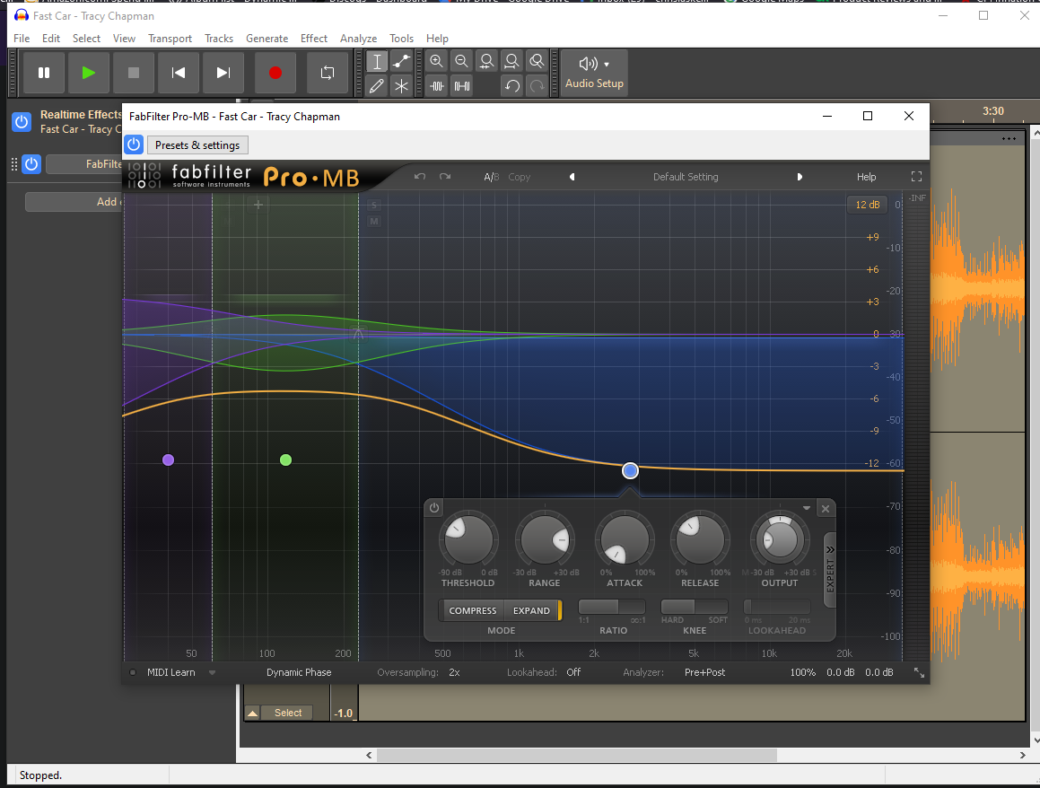

I think the reason why a lot of people disliked these CD versions is due to the type of processes used during mastering to increase the effective loudness of the tracks, more by using EQ to statically attenuate bass and boost the 1-5 kHz band. This is very easily reversed using Pro-Q4 plugin by observing the average spectrum moving around (white and gray areas/traces) and inserting appropriate amounts of dynamic and static EQ (orange trace and multicolor dots at the center of the parametric EQ bands) to reverse the most obvious areas where EQ and compression was used during production, all while listening to the result in real time:
It's very easy to use.
